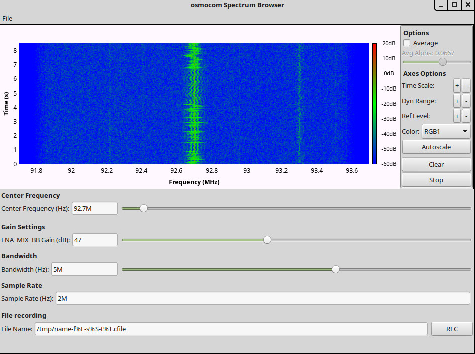

Had some luck yesterday getting GQRX working, so I thought I'd try osmocom_fft. Seems OK as can be seen in the attached image. I tried a few options for the antenna, but haven't seen any difference.
I started it like 'osmocom_fft -a sdrplay -f 92.7M -W -A 2' There's a strong BBC Radio 4 transmission on 92.7MHz and '-W' is for the waterfall. It works with '-a soapy' too.
