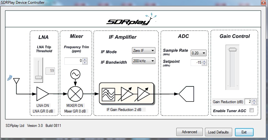

If you are using HDSDR, this is because the input bandwidth is handled by the ExtIO Controller - not in the Bandwidth menu you would normally go when using other SDR devices. If you click on ExtIO to the right of the TUNE frequency, you'll see a controller pop-up like this:
The "IF Bandwidth" would be the equivalent of the Input Bandwidth setting in HDSDR.
