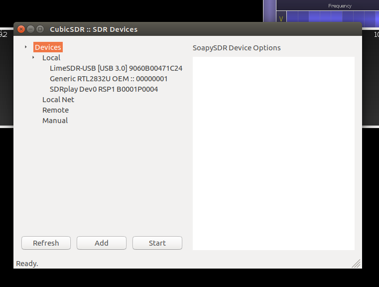

While CubicSDR and GQRX are able to recognize SDRPlay - run is impossible.
Any other tips?
sdrplay
Posts: 978
Re: RSP1 on ubuntu 17.04
Post by sdrplay » Mon Jul 10, 2017 5:55 am
Not sure what you mean by run is impossible. In CubicSDR, you select the device and parameters and press start. That doesn't work for you?
There is an issue with > 2.5MHz sample rate on Linux which I'll be pushing an update for this week but if you stick to defaults it should work ok.
Have you also tried... SoapySDRUtil --probe=sdrplay
9a4db
Posts: 29
Joined: Sun Jan 24, 2016 6:44 pm
Post by 9a4db » Mon Jul 10, 2017 7:04 am
Here, CubicSDR, all SDR-s detected, first two working, last RSP1 detected, but not able to work....
Screenshot from 2017-07-10 08-54-16.png (35.24 KiB) Viewed 35779 times

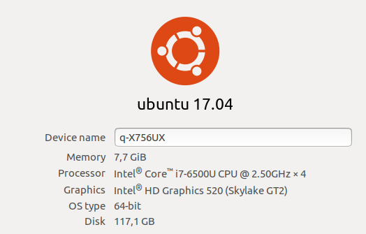

9a4db
Posts: 29
Post by 9a4db » Tue Jul 11, 2017 10:59 am
Thank you
Yes I am using USB 2.0 port, on the same port Lime reporting USB 2.0 and working on low bandwith, RTL-SDR v2 stick too
API -> SDRplay_RSP_API-Linux-2.10.1.run
Guess no need to test another USB cable because the same RSP1 setup is working on Win10 machine using CubicSDR or SDRConsole V3
CPU here
Screenshot from 2017-07-11 12-52-43.png (25.43 KiB) Viewed 35723 times
