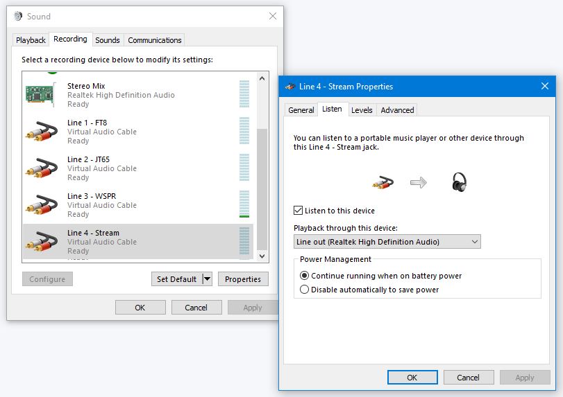

Hi Steve,
Look at the Properties of the "Recording Device". You can specify a "listen" destination. Choose whichever device your speakers are connected to and enable it.
73 Martin - G4ENZ
Listen to.JPG (69.9 KiB) Viewed 13611 times

Thanks, the same worked for VB audio cable.
