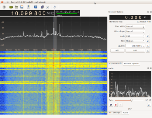

I have also compiled gnuradio and gr-osmosdr from GIT. After this downloaded GQRX from GIT, compiled and installed. GQRX is working with my old rtl-sdr device but not with SDRPlay. I get strange spectrum signal, at startup hardware field "Sample rate" is empty, after a run if I select hardware button SDRPlay is lost (there is only "other" field) and on terminal window I get a lot of Error: USB buffer overflow.
I attach a screenshot of GQRX tuned on 10099800, Rtty freq of Offenbach.

There's still some work needed on the SDRplay / GQRX interface, but if you enter these values it should work fine:
Sampling rate - one of these
8000000
5000000
2500000
2048000
2000000
1536000
-- I usually use 1536000

The wrong sampling rate / bandwidth combination can cause buffer problems, but I haven't seen it using the above combinations with the latest code.
You'll also find you need to "bounce" the RF gain to activate DC removal. I boast it to max and then back it off, usually to around 72 unless more gain is needed for satellites, etc. Also, because frequency changes to the SDRplay itself can take a moment to settle, it is better to use the receiver offset tuning in the receiver tab to fine tune or band-scan an HF band.
Make sure the gr-osmosdr you compiled has the latest sdrplay_source_cc.c code! The old code dropped packets, which caused all kind of problems. See my recent posts on the Code Corner / Linux discussion (within the last few days -- not the earlier experiments) to see what it should look like. The problems you are seeing may be due to t he wrong sampling rate/bandwidth or could be the old code.
