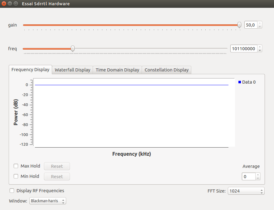

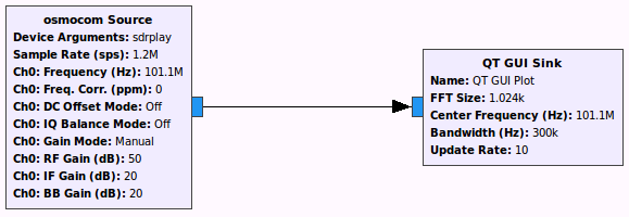

Then I tried to work under gnuradio with a very basic grc schema
I couldn't execute the schema for sometime and obtained the bug 528 message until I understood I should uninstall the gr-osmodr and reinstall it with the instruction
cmake ../ -DENABLE_NONFREE=TRUE
and now gnuradio finds the RSP1 but I have the following message in grc:
Generating: "/home/vincent/Documents/GNURadio/essai_SDRRTL_hardware.py"

and the device displays no signal at all.
What should I try now? I am lost :oops: and found no clue as to what I could do on the forum.

Did you ever find a solution to this issue? Experiencing the same issue. Tried with a HackRF and it works fine. Seems to be SDRPlay specific.

The best and easiest way to get up and running with RSPs in Gnu Radio is here:
https://www.sdrplay.com/community/viewt ... f=6&t=3770
Bespoke source blocks for each RSP so that you can control all aspects of the RSP directly.
