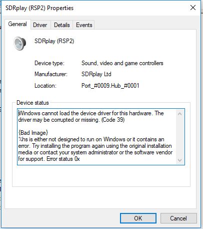

I went to use my RSP2 today and got the 'No RSPs found' error message come up.
On checking in device manager, I now have an exclamation mark next to the RSP2 and just cannot get it to run.

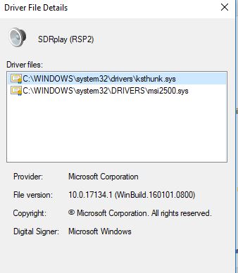

I have uninstalled SDRuno 1.22, tried re-installing it again, deleting msi2500, system scan etc with no joy - always get the same :|
Screen shots below - any ideas anyone??

You have Memory Integrity protection enabled in Windows 10, you need to disable it. the SDRPlay driver is not compatible with this feature.

vsonnier wrote:You have Memory Integrity protection enabled in Windows 10, you need to disable it. the SDRPlay driver is not compatible with this feature.
Many thanks indeed Sir - that sorted my problem - VMT :D
