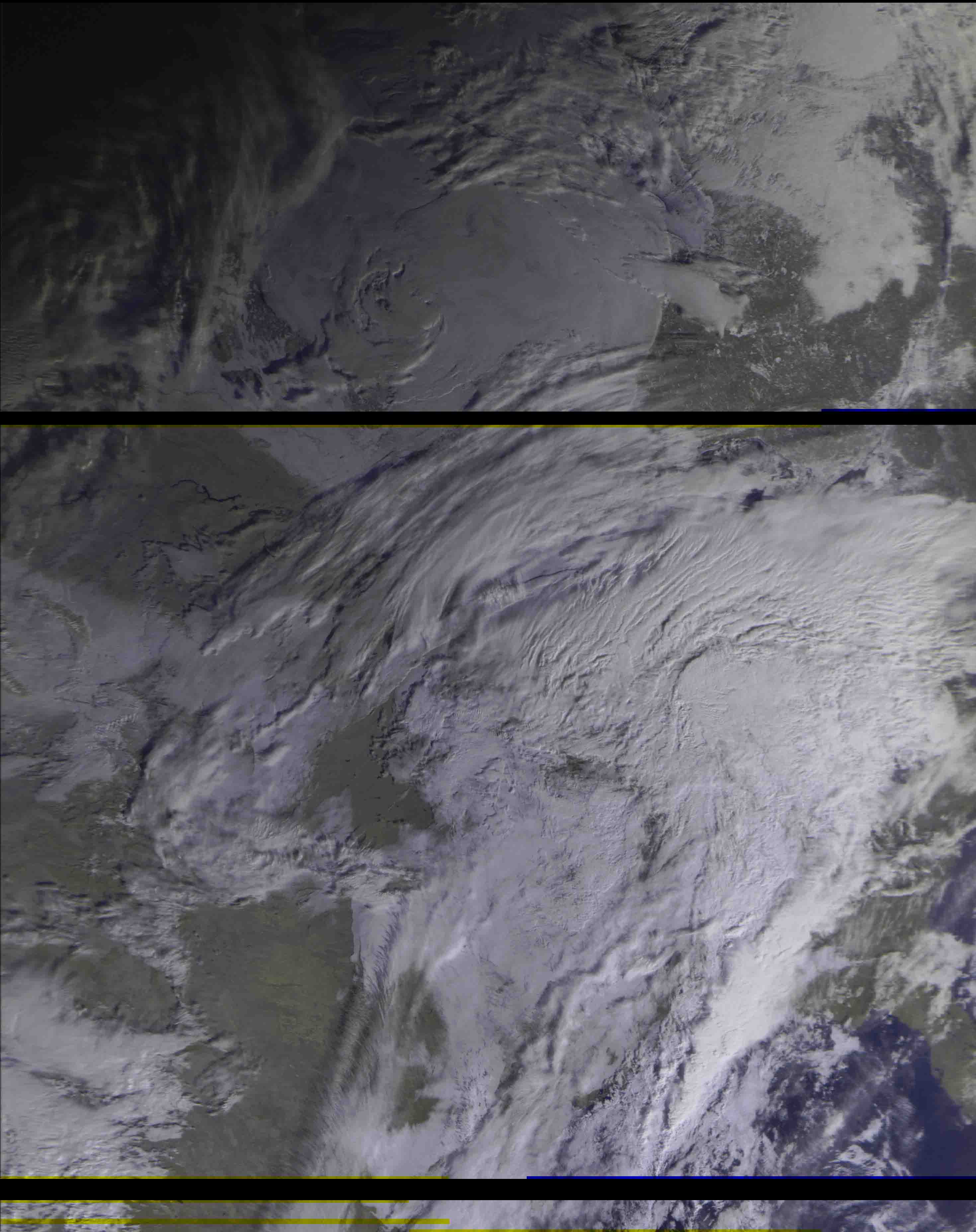

Re: SdrPlay SDR# satellite Meteor 2 plugin problem
Post by Mike2459 » Sun Dec 17, 2017 6:07 pm
20171217 Eastern N. America
The DDE Tracker and Meteor Demodulator plugins for .NET 3.5 and 4.6 are available here:
< http://rtl-sdr.ru/page/komplekt-plagino ... drugih#cut >
There are also instructions for configuring the set up. The site is in Russian so you may need to go through google translate.
You will also need a properly configured viewer - the AMIGOS viewer - there is a link to it also at the above site.
It can be tricky getting everything configured but it will work with SDRSharp 1361 < http://www.qsl.net/4/4z4zq//sdrsharp/ > and the RSP2.
I have been using this set up for the last six months and it is quite reliable.
