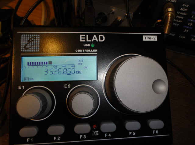

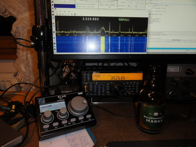

Post by DK7OB » Thu Dec 27, 2018 8:45 am
I am running an ELAD TM-2 controller with Linux using a home made driver programmed in Python that should work with a Raspberry Pi. This is not a VFO knob alone but a complete controller with display, see pictures. It controls my TS590SG and my RSP1A with gqrx.
