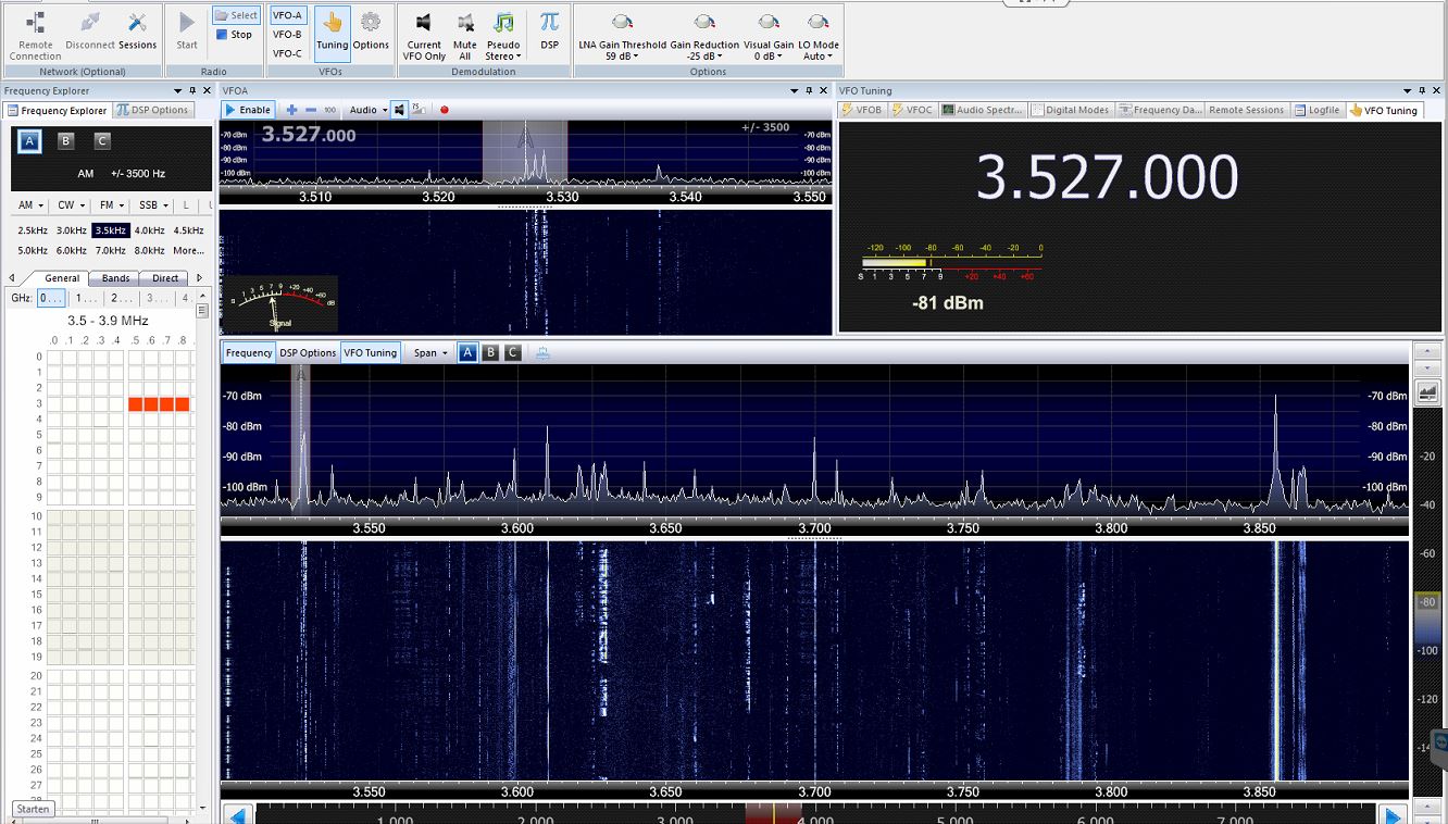

Hello,
i have my sdrplay for a week now,
and enjoy it together with a Bonito megactiv 305 active antenna.
however on the 80meter band i get images every 60 khz or so,
changing the gain reduction lessen these but does not solve it.
this happens on other bands also (40meter, 20 meter)
if i disconnect the antenna, these images does not go away.
is there a solution for this, or a test that pinpoints the source?
thanks for any help

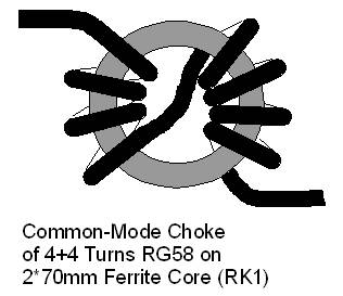

These almost certainly result from external interference pickup from things like switched mode power supplies and other sources of electrical interference. There are two main routes that these can get to the RSP. The first and most common is via the USB ground. The second possible source is via the antenna feed (the shield if you are using coax). The most effective way to reduce this is loop your USB cable through a clip-on ferrite (up to 3 loops if possible) and also do the same with your antenna feed cable. People have generally found that this substantially reduces the amount so electrical interference that couples to the RSP.

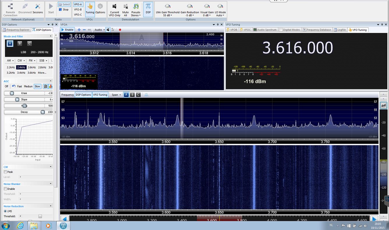

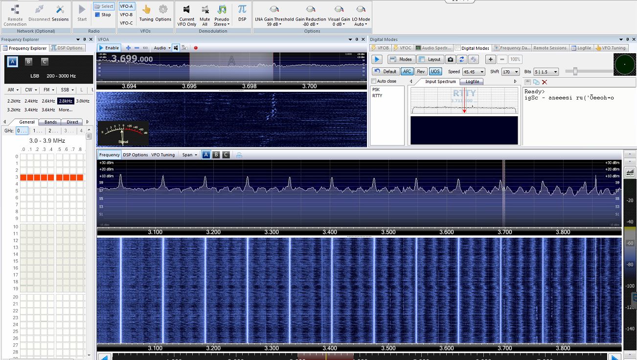

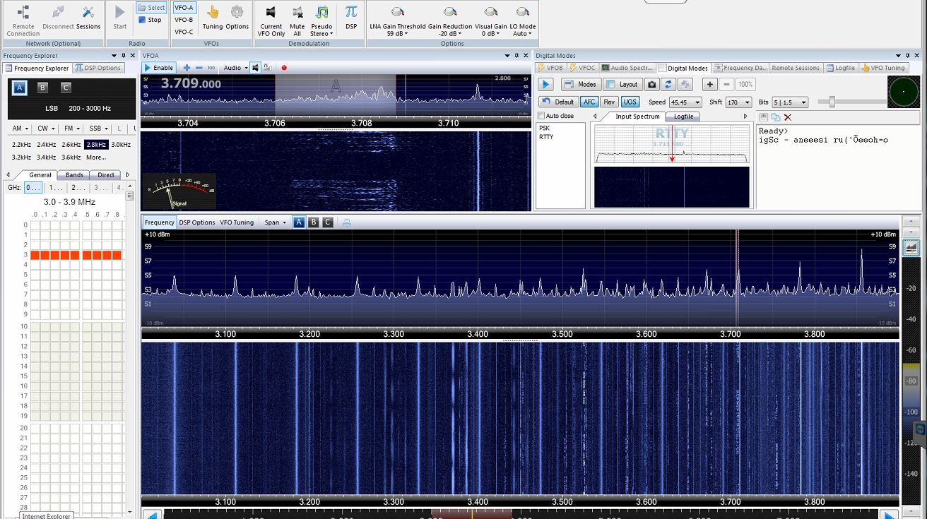

i just connected 4 ferrit rings on the antenna cable , near the receiver.
i also wove the coax trough a ferrit ring is this; this is the result, gain @-80 dbm: this is with gain at -20dbm: it shows some improvement , but the images still are very present.
tomorrow i try to make a balun out of coax and insert it directly at the antenna.

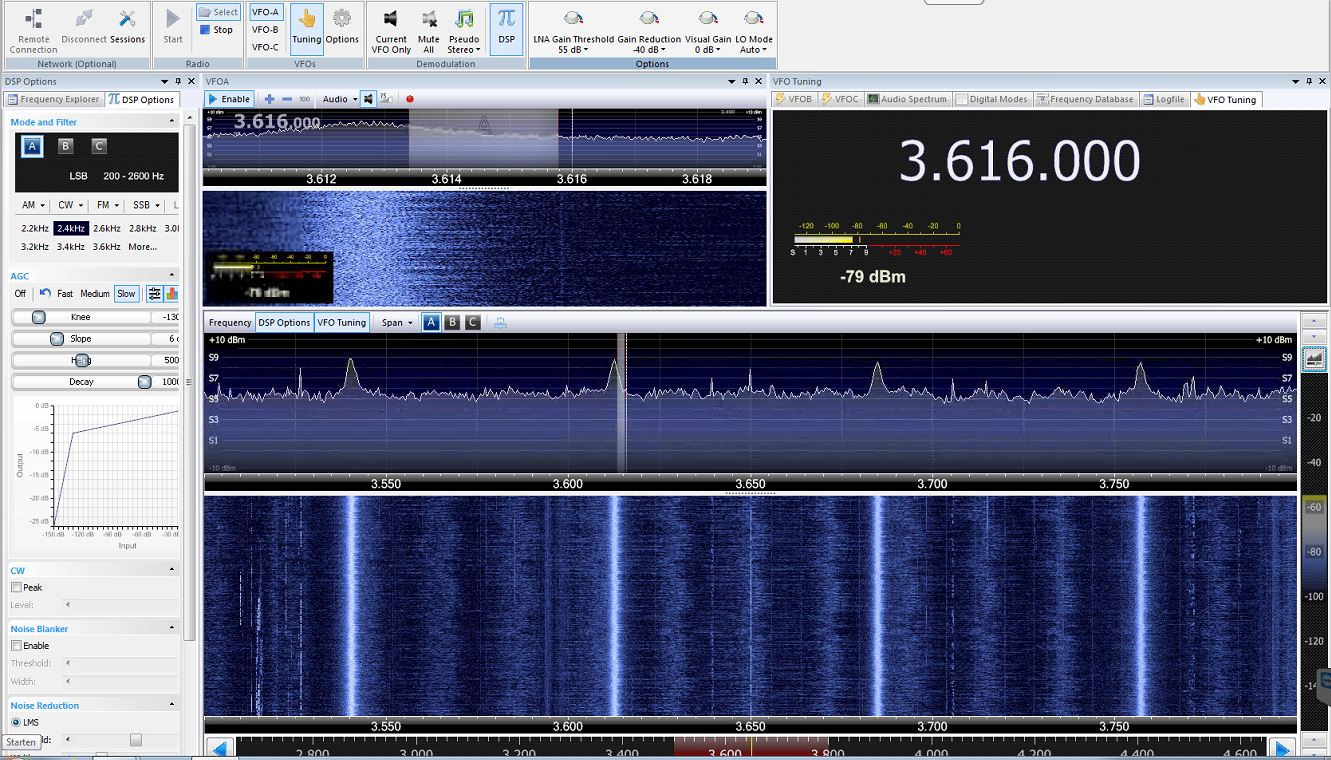

i solved the problem today,
turned outto be a noisy router downstairs.
founded it by shutdown the surch protectors from the electric installation one by one till the images where away.
i disconnected it alltogether and use a less noisy, but also less powerfull one.
just to be shure i added 4 clip-on ferrits on the incoming antenna cable and used a usb cable without earth connection to the laptop.
i also put the sdrplay in an empty iron cookie drum and connected this box to the radiator for earth connection.
thanks for the tips all
this is the result:
