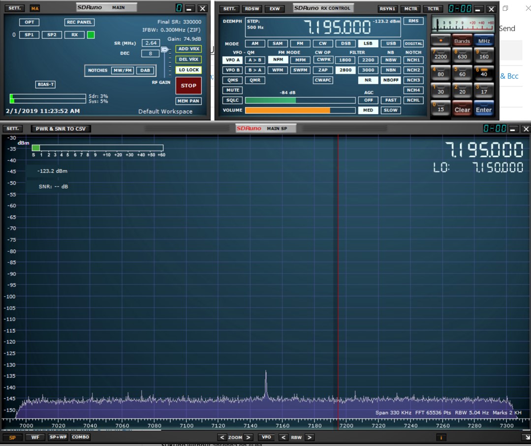

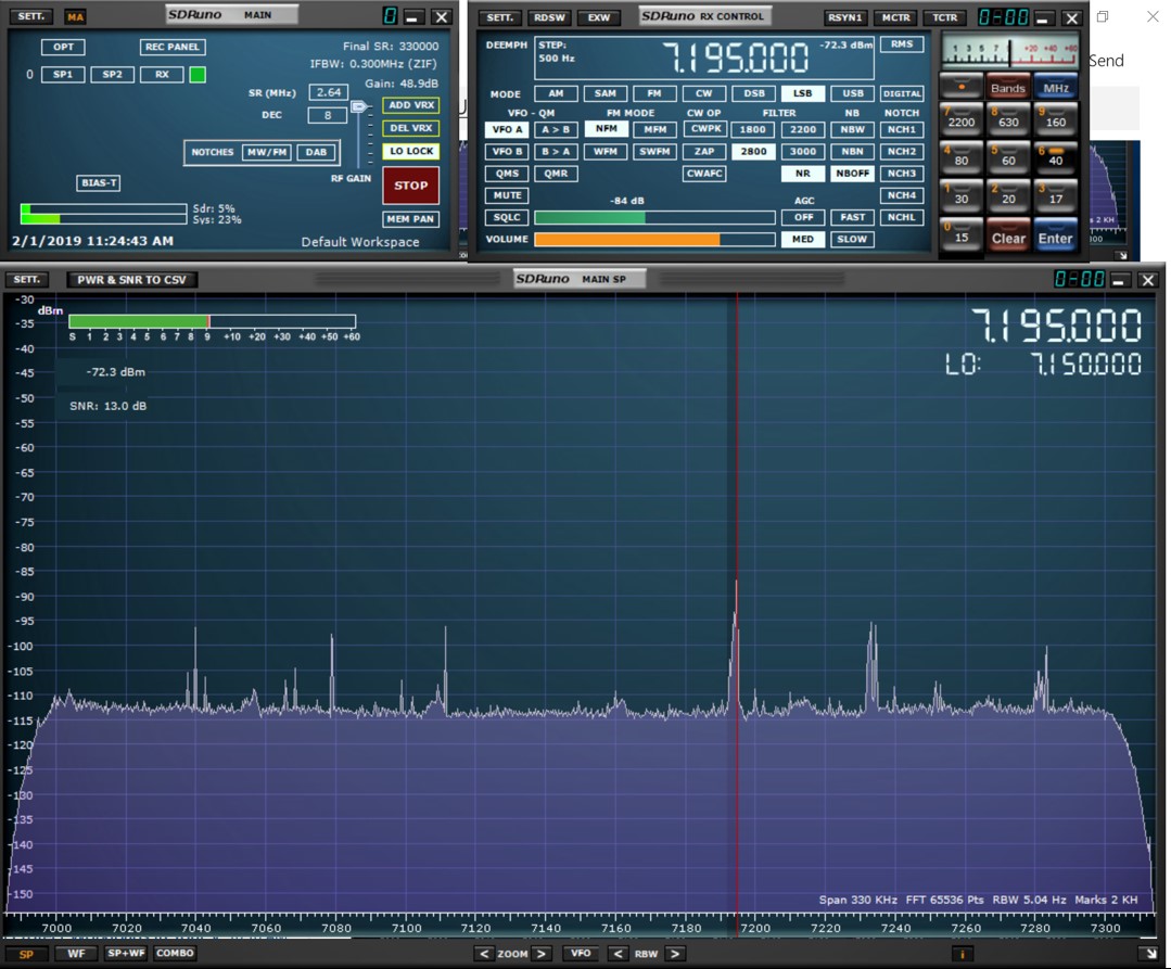

Hi - Sorry I did not give you the info that you needed. In SDRUno, the RF gain is set to max. This app appears to be working correctly for displaying baseband noise levels. Please see two attachments. The baseband noise with and without the antenna is about what I see with other SDR radios. In the past, I have always found HDSDR to also be accurate with signal levels once the S meter was calibrated. This current issue could be related to Windows 10.
Regards
Clint

Hello Clint,
Your power meter indicates a noise power of -123.2 dBm in a 2800 kHz bandwidth, which is an equivalent input noise of -157.7 dBm/Hz. This would equate to a noise figure of around 16 dB at 7 MHz, which compares very closely to the specified NF of 15 dB @ 12 MHz. Technically, one should add the noise power from a 50 ohm source to get a true value for the noise figure, but the error is so small as to be insignificant.
Your noise floor with the antenna disconnected is around 33dB lower than the noise floor from your antenna system, so the RSP1A is adding an immeasurably small amount of noise to your receiving system at these frequencies. So I believe what you are showing is completely correct and the performance is good.
As you reduce the RF gain, you will see the noise floor increase. That is because the NF of the RSP1A is increasing in-line with what you would expect. This will be more obvious with the antenna disconnected as you would need to see an increase of nearly 30 dB to the RSP1A before you would see the noise start to increase with the antenna connected.
