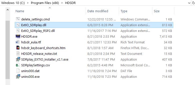

Is the highlighted .dll in your HDSDR install folder?

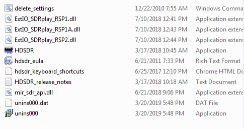

Post by Missiletech2u » Thu Mar 21, 2019 2:04 am
Thank you for your reply. I believe the correct file is there. I am including a screenshot. Since I posted the original problem, I have uninstalled and reinstalled using the individual (long way around). I have downloaded and installed the individual API drivers and EXTIO plugins, then installed HDSDR directly from the HDSDR website. It appears to be working correctly except for the audio. I do not hear anything but static. There is no audio but there appears to be a signal on the waterfall. I tuned to a local AM broadcast channel.

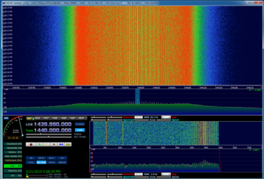

Thank you for your reply. I am including a screenshot of HDSDR running with my SDR (RSP1A). Hope this helps. I am tuned to a local AM broadcast station. (1440 AM). There is static but no broadcast audio.

If I'm reading it right I think you are tuned to 1440 MHz, Missiletech.

Yes, I am tuned to a local broadcast station (1440 AM) I hear static but no modulated audio. As you can see on the screen, the waterfall shows a strong signal at 1440 mhz.

Missiletech: Andy is trying to tell you that you are tuned to the wrong frequency. You should be tuned to 1440 KHz or 1.440 Mhz.
With HDSDR running type: 1 4 4 0 Enter

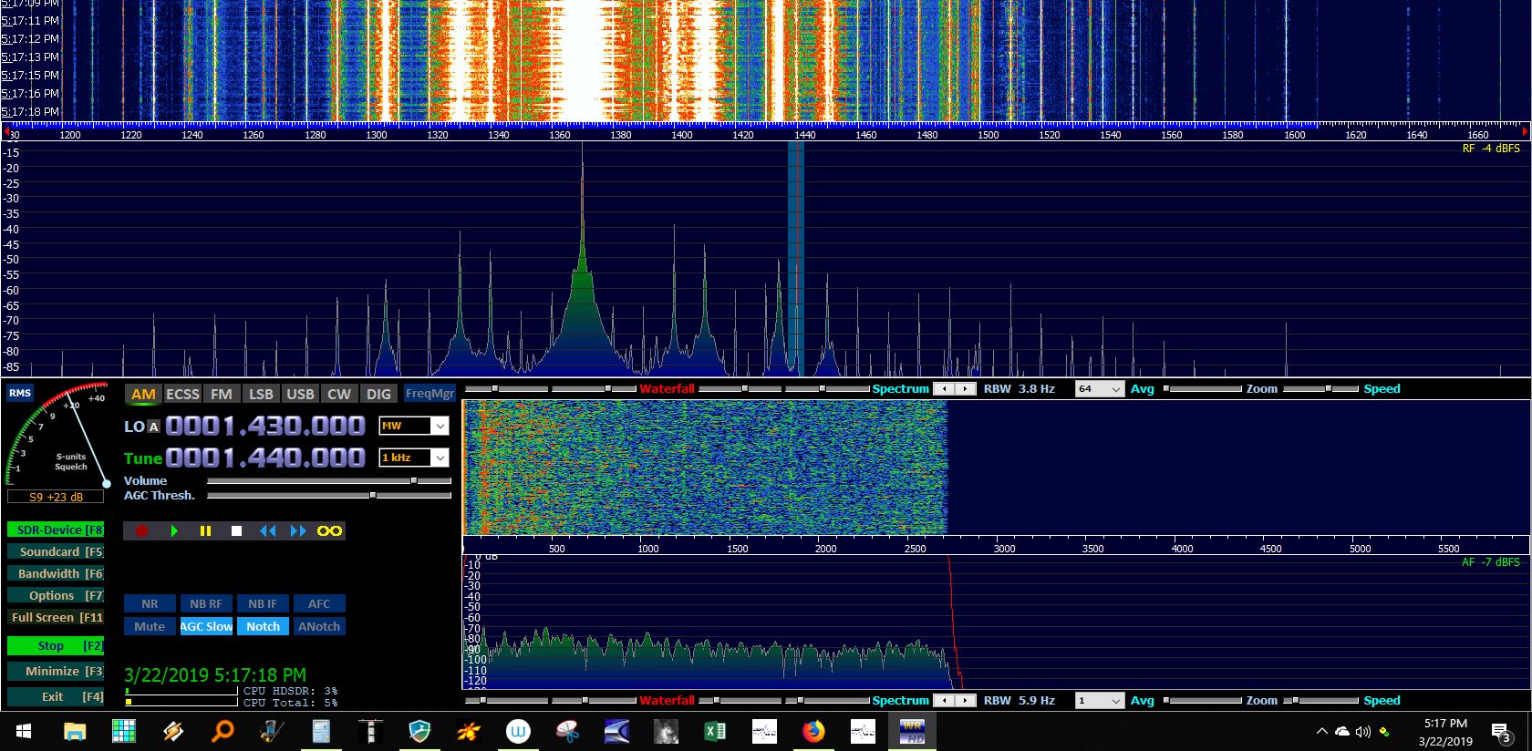

Post by Mike2459 » Fri Mar 22, 2019 9:18 pm
1440 Khz:
