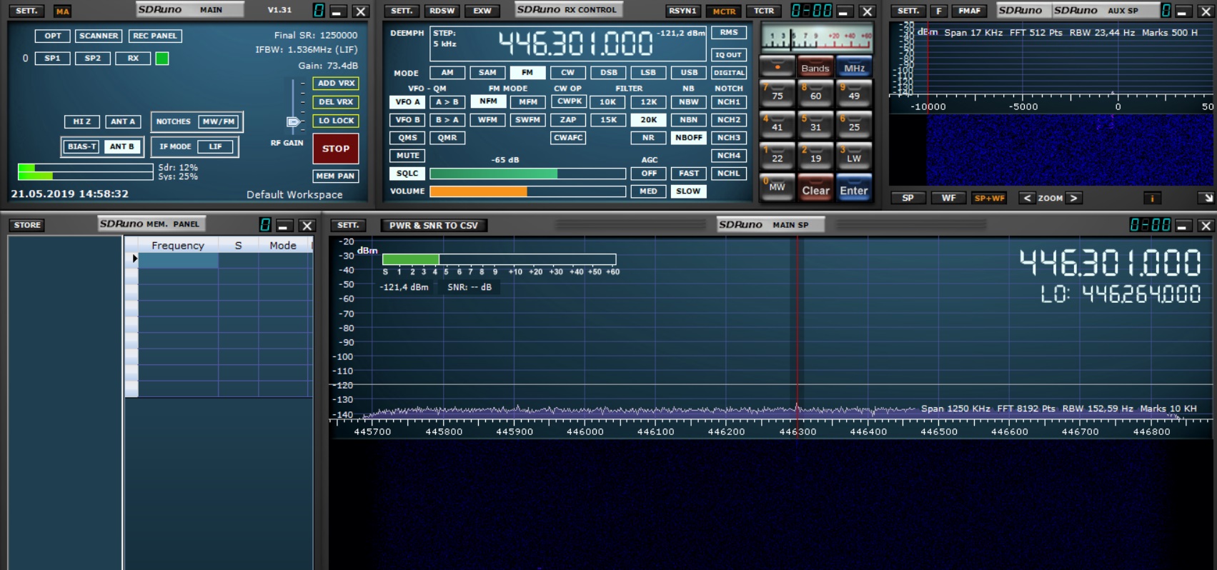

First of all I need to notice that I'm new to RSP2 and SDRuno.
I've successfully used RSP2 for one month and suddenly it becomes deaf. Now I can hear only "strong" FM stations. Can hear other stations on my Yaesu VX-3R, but there is nothing when I use the same antennas on RSP2. I also tried to reinstall SDRuno - didn't help. Maybe there is something wrong with my settings? I'll be appreciate for any help. Here is screenshot:
- sdr.jpg (371.53 KiB) Viewed 33732 times

Hello Deimos,
In your screen shot, your RF gain is very low. Try turning it up to maximum. This should have a huge impact on your UHF sensitivity.

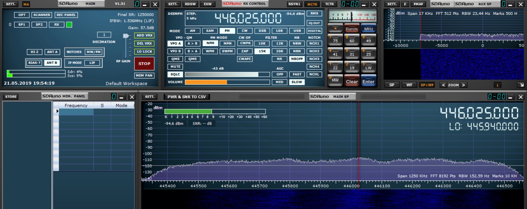

Unfortunately, it didn't help. I'm listening 446.025MHz on two radios but RSP2 is deaf with all antennasTech_Support wrote:Hello Deimos,
- sdr2.jpg (348.3 KiB) Viewed 33693 times

The most common cause of a loss in sensitivity is a blown front end, but looking at your noise levels, it is not obvious that you have a damaged front end, although it is still possible. I suggest that you try a different adapter and also try resetting SDRuno.
