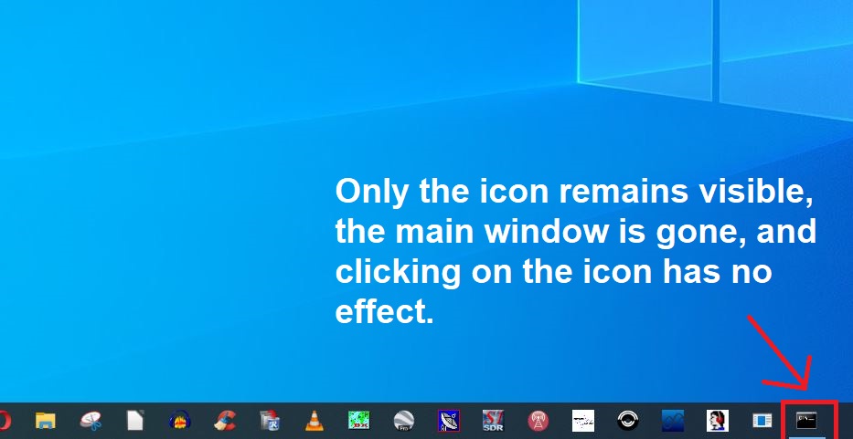

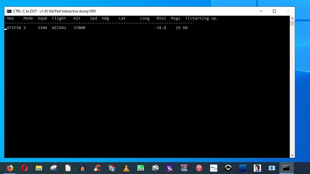

Hi,
I downloaded lastest SDRuno version as well as Dump1090 v1.45.
Something weird happens when the latter has been running for about 15-20 minutes : its main window on a black background suddenly disappears (I was in front of the screen when it closed itself). but the program remains running. Then, I only have its icon visible at the bottom of the screen. If I click on it, the window no longer opens and I have no choice but to close the application 'wildly'.
This happens even if only Dump1090 works (I mean even if Virtual Radar Server is not running)
Is it a bug or is there something wrong with my set-up ?
How can I make the main black Dump1090 window visible again ? (to close it properly by entering Control C)
My OS is W10 latest release.
RSPduo, SDRuno 1.32 / ADS-B installer v1.45
Attached are 2 screenshots showing Dump1090 normal operation and then only its icon at the bottom of the screen.
Note : I was running Dump1090 in "Stf Perf Interactive Mode".
Thanks for your help.

Re: Possible issue with dump1090 v1.45
Hello !
Am I the only one to notice this 'problem' ? It happened again yesterday after 15 to 20 minutes.
Is there another way to 'properly' close Dump1090, considering I can not use Control+C when the window is closed ?
I think this is an issue with the way that the command prompt behaves when the buffer is full. It's strange that the window disappears totally. We've certainly seen the window close up to the title bar and then we have to drag the window height back to where it was.
This will only happen in interactive mode, so you could run it without interactive mode and either look at the data via web interface or pipe it into something like Virtual Radar Server.
You won't see this issue on a non-Windows based system, so it really does seem an issue with the way that the command prompt works with lots of lines written to it.

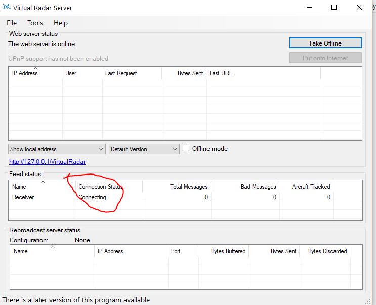

You can also check the status here:
The connection status should read 'Connected'. If it says "Connecting" then a connection has not been made

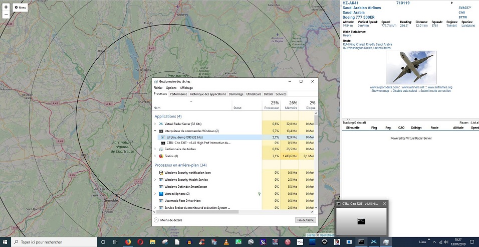

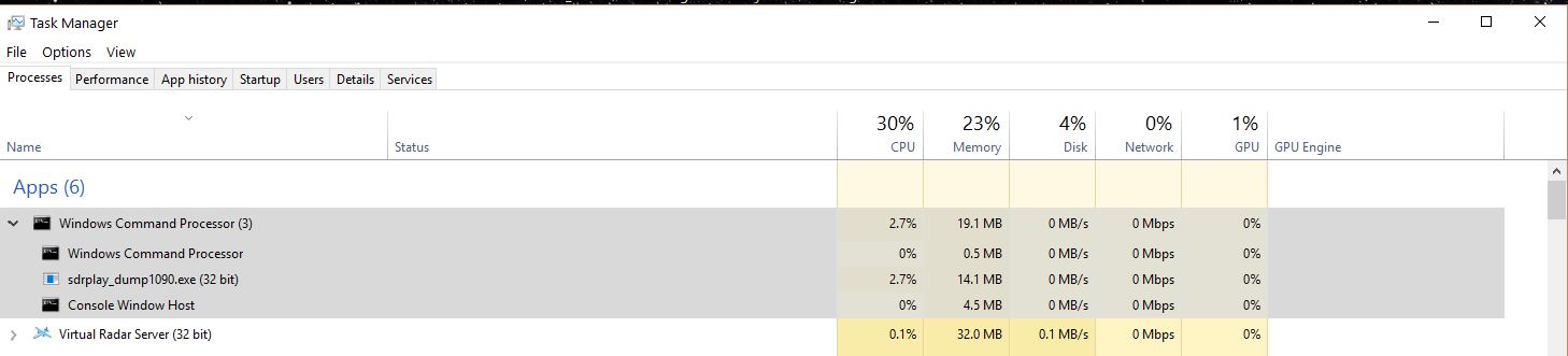

Mike,
FYI, here is a screenshot of the task manager after Dump1090 window disappeared. It all looks fine.
Virstual Radar Server shows the RSPduo status as 'connected'.
