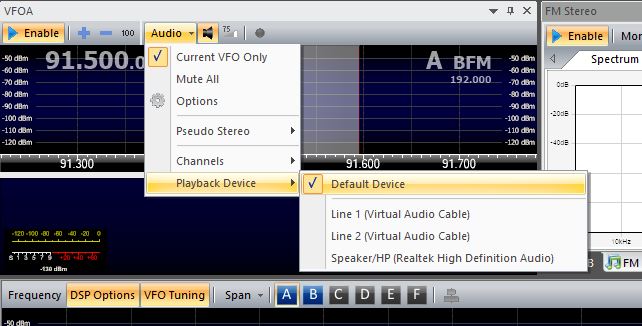

on the VFO window, click on audio/playback device and select your relevant VAC
and the center spike should disappear if you are on a frequency after about 30sec, but Simon is working on an update still for the new API, did you copy the new API into the sdr-console folder?
