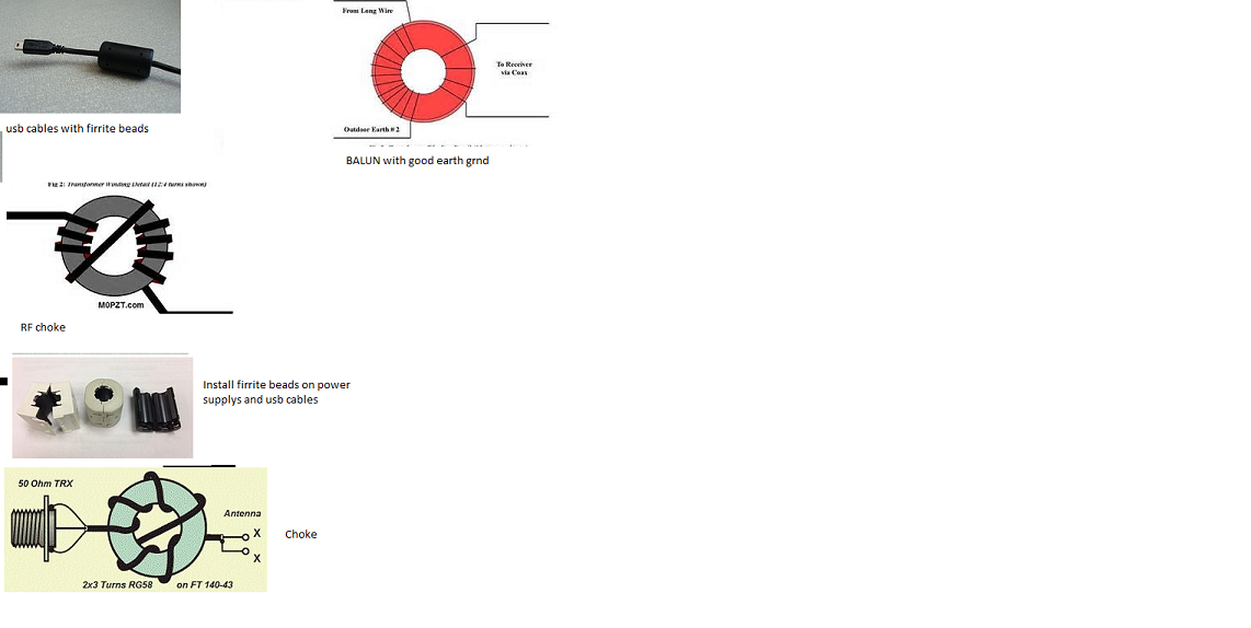

Post by rgood123 » Fri Jan 15, 2016 2:28 pm
In short, had the same interfence with a longwire this is what i did to reduce the EMI, harmonics.
What worked:
What didn't work:save your money
Active antenna Preselector-just amplified the problem.
USB Isolator ADUM4160-data transfer rate to slow for sdr .
