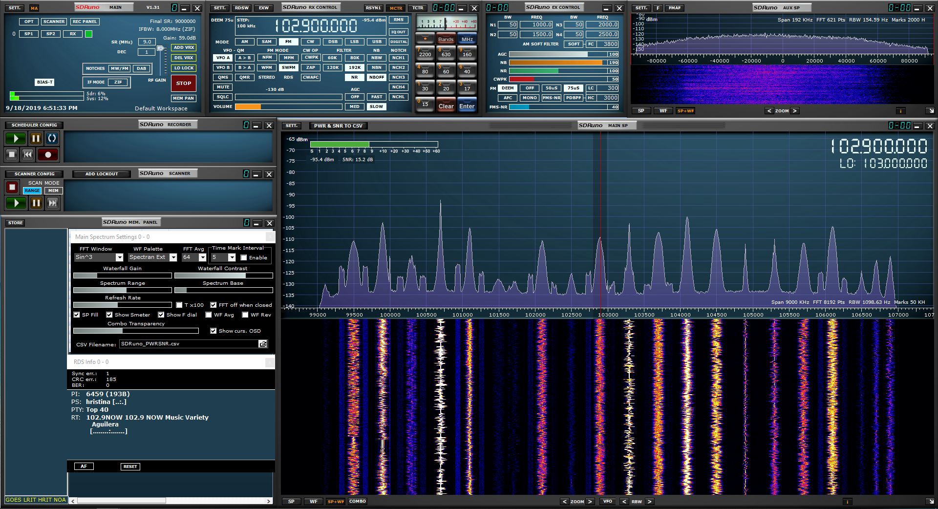

The easiest way to get started with an RSP and SDRuno is to tune into a local FM radio station. That will help you get familiar with the settings and functions of the RSP1A and SDRuno. Do the following:
1) On the SDR Main Window, select SETT. On the Input Tab, set Input Level Display to "Gain". Set IF Mode to Zero-IF. On the IF AGC tab, make sure the box for IF AGC is checked. This will automatically set the IF level to help keep high power local FM stations from overdriving the ADC input. In the Main window, set the RF gain to about its mid-range setting and set SR (MHz) to 9 MHz. Make sure the MW/FM notch selection is not set.
2) On the RX Control window, select FM, SWFM, Set the filter to 192k. Set NBOFF. Set audio AGC to SLOW. Enter the frequency you want to tune to for the FM station in the frequency display, then select "Enter." Set the Volume level control to 15% of its range. Select NR.
3) If you are in the United States, in the EX Control window in the FM row, select DEEM and 75uS.
4) On the Main window, set Gain to 90% of maximum and select "Play!" You should be hearing the station you selected in step 2.
5) Now for some additional adjustments. On the Main SP window, select SETT. Adjust the Spectrum Range so you are indicating 5dB per division. Adjust the Spectrum Base, until it is a little higher than the bottom of the window. You should now be seeing a bunch of signals from commercial FM stations and the corresponding waterfall images.
6) To change FM radio station frequencies, you can either enter them in the RX Control window as you did in step 2 or in the MAIN SP window, put your mouse cursor at the frequency you want and left click.
7) On the RX control Window, select RDSW and you will now see the decoded digital information, if any, broadcast for the station and music you are listening to.
Have fun. I think you can get the rest figured out from here.
