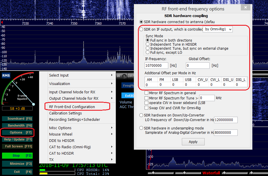

Monty,
Here is where you find the IF settings in HDSDR
There is a lot of info on setting up HDSDR to use an RSP on the IF output on this site....
https://sites.google.com/site/g4zfqradio/hdsdr-if-pano
