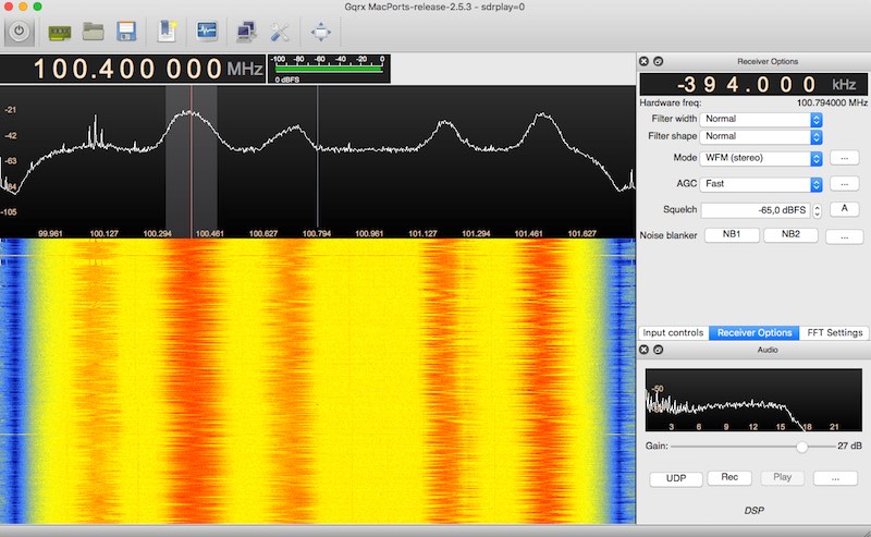

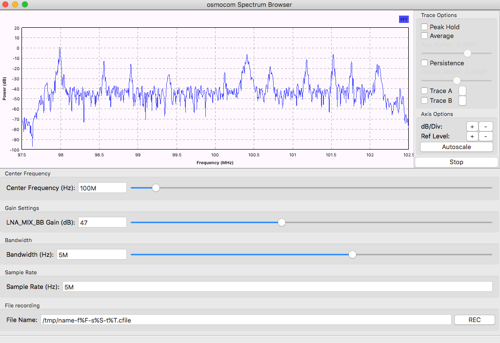

I did it :)
The key should be
cmake ../ -DENABLE_NONFREE=TRUE CMAKE_INSTALL_PREFIX=/opt/local
Than the path is correct, and all works:
osmocom_fft -s 5e6 -f 100e6
gqrx
One problem: the bitrate more than 1.5M is not working. I hope, the SDRplay team can fix it sometimes.
I think SDRplay guys should update the mac os manual.
