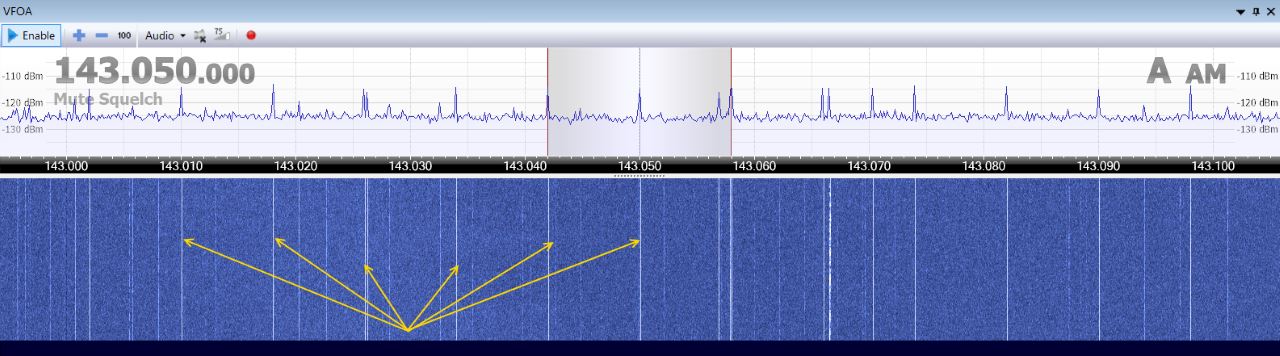

This post is partly to share my experience, and partly to seek advice before I start experimenting! To get started I'm currently using a whip antenna (Nagoya NA-771) screwed directly into the RSP, with that RSP on the end of a 5m USB cable to try to keep it away from the computer. This cable has a ferrite core, but only on the computer end.
My initial interest is trying to detect meteors by the reflections they give of signals from a VHF transmitter which is too far away for direct reception, and I'm trying the Graves transmitter on 143.050 MHz, which seems to be widely used for this purpose. No luck yet!

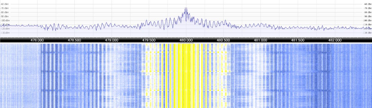

I too observe regular interference spikes in some bands, spaced exactly 8 kHz apart. I strongly suspect these to be due to interference from USB: I understand that the USB2 micro-frame length is 125 μS which corresponds to 8 kHz.
As corroborating evidence I also see a strong signal at 480 MHz, which is the USB2 clock frequency. I don't think the interfering signal is internally generated or coming in through the USB connection, because it disappears if I remove the antenna. I guess, therefore, that it's being radiated either from the RSP's USB cable or from other USB equipment, and picked up by the whip antenna.
