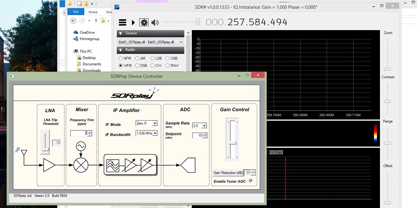

This is the diffference I get between the new and older version of the plugin
As you can see even the name of the plugin shown in SdrSharp is messed up in the new one, it also has no indication of lnb gain on or off
This is the older version - MUCH better
This is the newer version - totally horrible to look at and use

It looks to me as if, in order to solve the problem with the I/Q correction not working in SDR# the SDRplay team has currently 'ported' the HDSDR plugin into the SDR# plugin installation. I'm sure that the next release will give both the HDSDR plugin and the SDR# plugin the better look of the version 1.3 of the SDR# plugin.This is the diffference I get between the new and older version of the plugin
What you should notice with the new plugin version is that the Gain and phase numbers aren't stuck on 1.000 and 0.000 respectively when you are tuned to a signal and that any images from strong stations within the passband are no longer there. It depends on the signal strength you are working with. On FM broadcast a 60-70dB station would give a 15-20dB image - good enough for noise-free mono. With the I/Q correction working that image disappears and allows the much weake rstation occupying the frequency to be heard.
