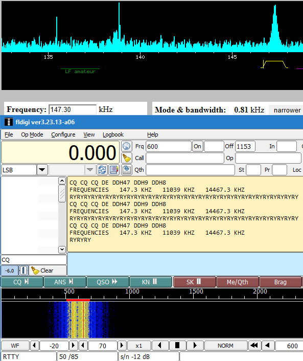

fldigi just "listens" to any sound at the soundcard you have selected in fldigi Configure, Sound Card, Capture.
As long as you can hear uninterrupted sound from your HDSDR, fldigi should "hear" the same uninterrupted sound.
I am using VB Audio Hi-Fi Cable as a default soundcard in my system and all sounds are routed into this "virtual" soundcard input. On order to hear the sound in my speakers (because VB Audio Hi-Fi Cable is virtual and has no speaker) I told the system to play back the VB Audio Hi-Fi Cable in my speaker soundcard. This is a Windows setting in soundcard settings for recording devices.
I can hear every sound now in the speakers and fldigi can "hear" every soud as well, be it from HDSDR, SDRuno, SdrDx, Perseus, Winradio, SDRConsole, SDRsharpsomething, even from a web based SDR like the famous one in Twente, Netherlands (see image).
Thus, if you have interruptions with HDSDR, you should try another sound source. Give http://websdr.ewi.utwente.nl:8901/ a chance, tune a frequency (maybe that one in my example or anything else "decodable" you can receive) and run fldigi. You should be able to decode the sound without problems.
Should there also be stutterings, something must be wrong in your system. But I cannot exactly tell you, what, because I never saw the problem. Normally a driver can not be involved.
If your PC has a "stereo mix pin" as a recording device you could also try this sound card output in fldigi. For most cases it is good enough. (I know that some manufatureres unfortunately have cancelled the "stereo mix pin" and you must use a virtual sound card.)
73s, Heinrich

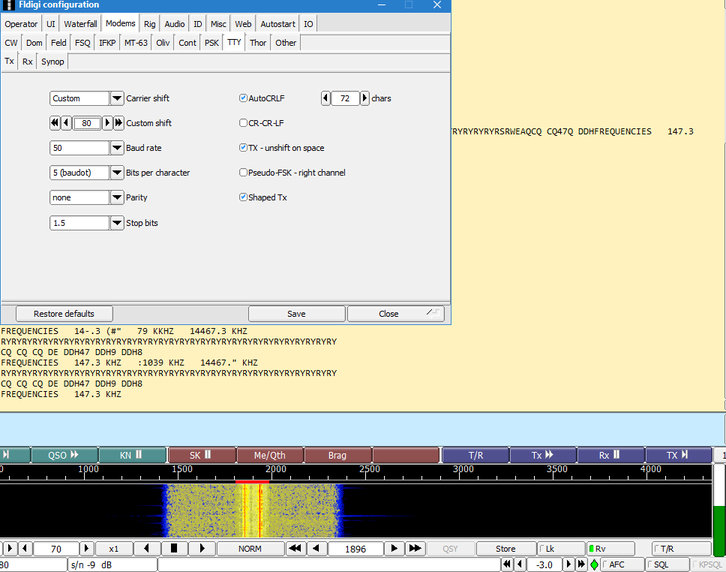

Hello Wolfgang,
sorry that I cannot help. This station works with SDRuno, HDSDR, wherever the sound comes from (maybe even from the Dutch WebSDR).
My settings are:
Carrier shift 80 Hz (custom)
Baud rate 50
Baudot 5N1.5
Revers "Rv" in the main window clicked (because I am using USB resp. DIGU).
Here is a screenshot received with my Angelia PowerSDR. I have several spherics this evening, errors may occur in the text.
With SDRPlay and SDRuno a.s.o. it works just the same. This it's not off topic.
My settings are:
Baud rate 50
Baudot 5N1.5

Hello Heinrich,
thanks for your answer. My configuration is basically the same as yours, except I use a shift of 85 Hz.
But meanwhile I found the cause of my problems. The squelch was set slightly above zero. I don't know why, but with this station the green bar next to the squelch slider is very low, so squelch kicked in and disturbed the reception.
With squelch at zero it is now working error free.
Regards,
Wolfgang
