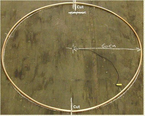

Post by Mike2459 » Tue Oct 02, 2018 7:56 pm
The article at PA0FRI's website has some photos of the loop being laid out along a chalked line on a piece of plywood. The results appear pretty good.

That looks like its 10mm and easily bent. For outside use, I think you would need minimum of 15mm tubing.
I have been able to locate a local engineering company who roll in aluminium not copper and they can do it but their smallest tooling diameter is 25mm, which looks to be about the same size as some of the proprietary loops on sale. Downside is they quoting around £65 for a one off.
