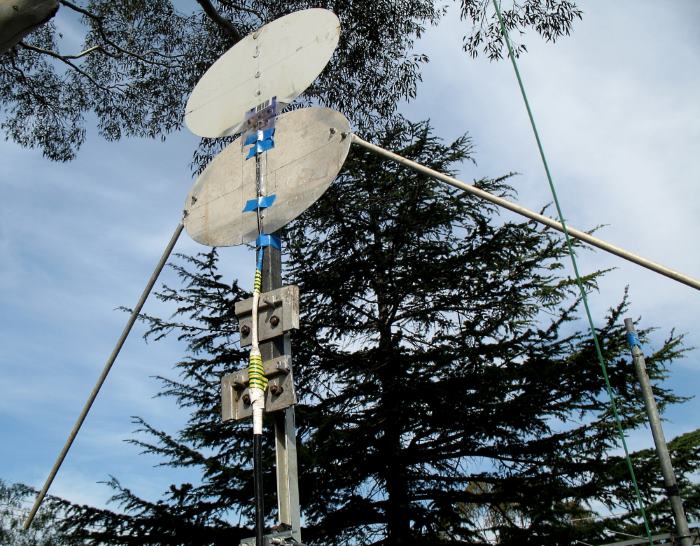

Hi, I`m planning to post shortly details of an antenna I have developed that you will be able to transmit
on (146mhz) and anywhere between 250mhz to 2800mhz with an SWR of around 1.5:1 throughout the range.
Will receive 118mhz to 2800mhz or greater.
This based on a dipole so it has increasing gain in frequency and as such is some what Bi-directional.
It is neat because you can go any where in the ranges stated and not have to change antennas.
Uses..... VHF, VHF-UHF-TV, UHF low, UHF high, ADSB, 23cm Band....e.t.c.
Easy to build and pretty cheap.
cheers Tony.
