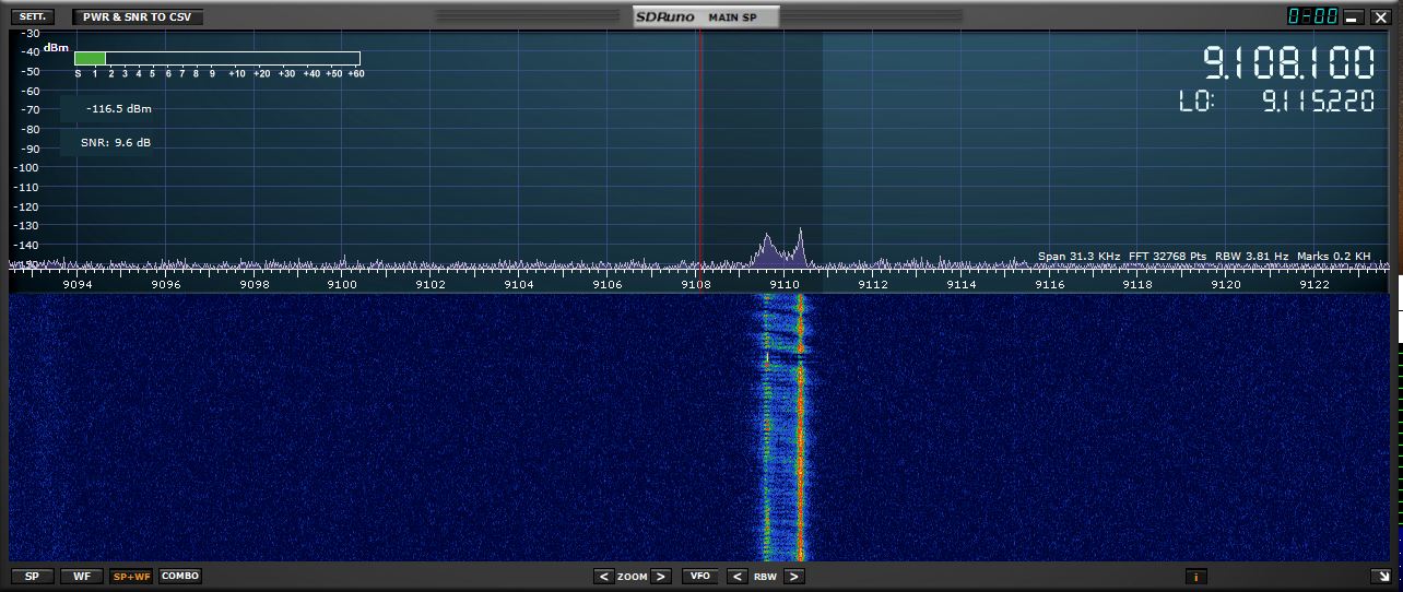

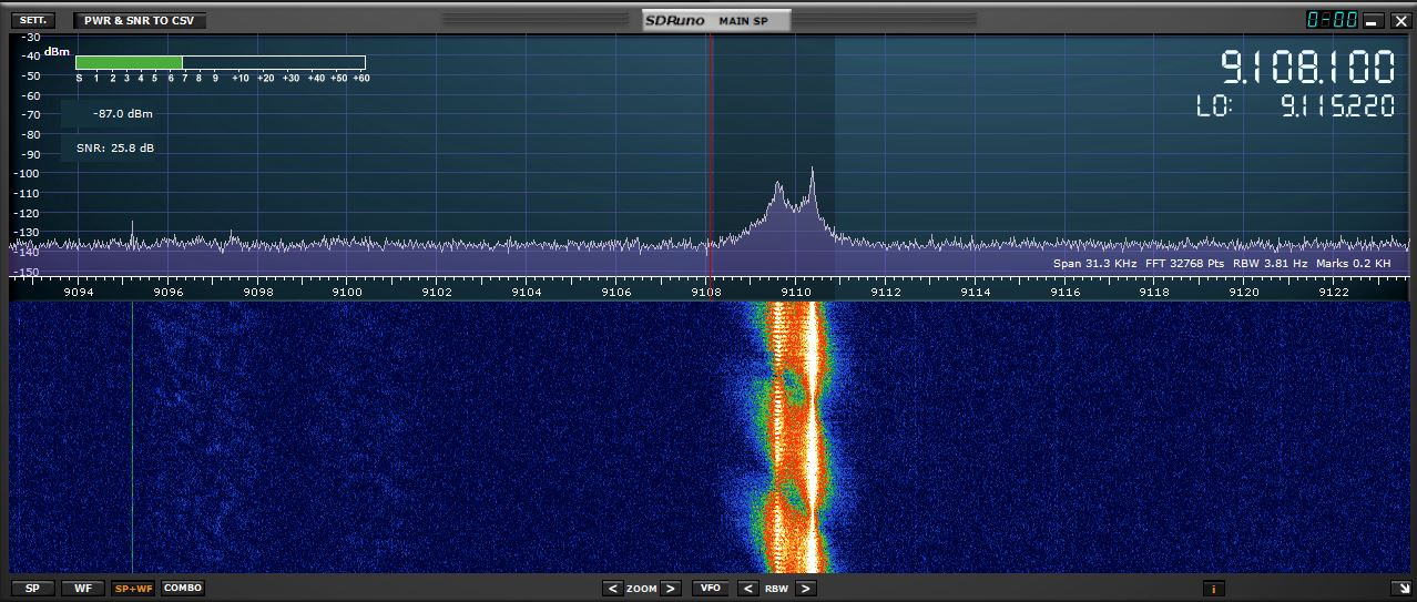

The RA0SMS produces noise approximately every 10 KHZ - the noise is present from LF all the way through HF. The noise is visible and is rendering the antenna unusable. You can see the noise spikes in the first three photos, and the lack of noise with the second set of three photos.
Below is a comparison on of the two antennas switched through an Alpha Delta 4 position coax switch.
RA0SMS
https://imgur.com/cqhxqw2
https://imgur.com/KAROVeu
https://imgur.com/gzQHoiM
PA0RDT
https://imgur.com/7NiKjLW
https://imgur.com/eldjBSI
https://imgur.com/WKL5dW3
I have swapped the wall warts between the two. Both power supplies are identical. The same noise is present with both wall warts.
I also noticed that non-noise signals, such as broadcast AM, are significantly lower with the RA0SMS. Putting a BC AM filter in-line had no effect on the noise spikes.
What could be causing the noise across all bands with the RA0SMS? All things are equal with the exception of the antenna and power feed unit. The PA0RDT is clean and rarely overloads, even with Broadcast AM, with the Yaesu FT-950.

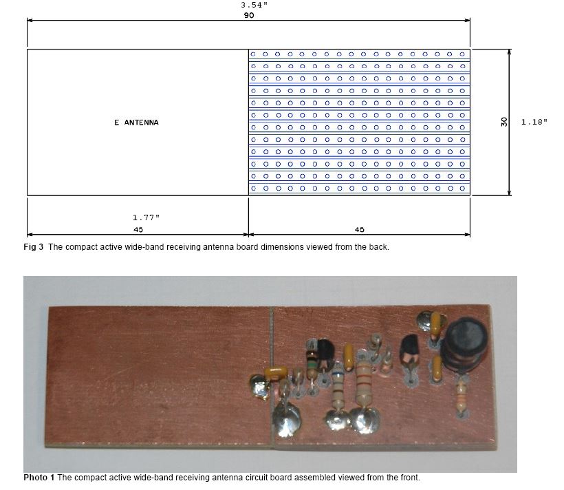

The E-Field plate (the antenna) of the RA0SMS appears to be much larger than the MiniWhip. The MiniWhip uses a 30mmX45mm plate. I made the plate on my home built min-whip slightly larger (around 30x50mm) and ended up trimming it down to the recommended size. Occasionally It exhibited the same symptoms as the RA0SMS. It would occur frequently during the gray-line.
The MiniWhip
The RA0SMS

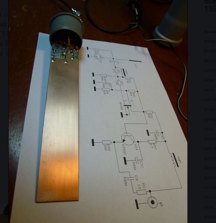

Mine is the new RA0SMS with a wire, not a plate. The wire is approximately 5-6 inches long.
