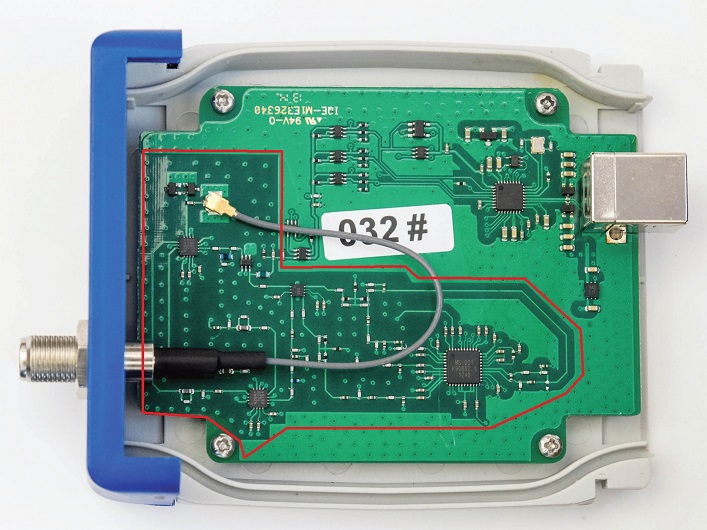

jon wrote:The technical team appreciated your comments here. They agonised for a long while on screening and decided that actually a plastic (unscreened) box was better.
The problem is that the biggest source of interference is the USB cable and the USB comms...putting in a screened box can often cause the USB interference to get “trapped” inside and generate more problems than it actually isolates. This very much depends on what PC you are using, desktop (well grounded) or laptop (not well grounded).
Probably good that you didn't connect the foil to the USB connector ground since this could inject USB noise to the front end but a lot of this depends on the frequencies of interest and your overall ground arrangement.
We'd welcome comments from others on this topic.
How about shield only analog part of circuit?

From the picture do I see that there is actually a miniature coax connector on the circuit board? If so what is it? I can the possibilty of getting a patch cable made with 'my' choice of bulkhead connector on the end. (I've got ver 1 with F-connector). Also it is nice to see an arrangement whereby the connector that interfaces to the outside world isn't integral to the board - less chance of the board getting damaged in the long term.
Also - you can get SMA to F connector adaptors quite easily.
