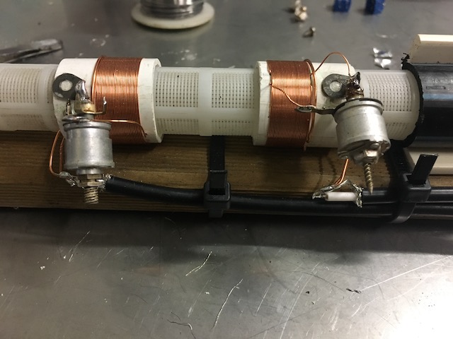

Version 2 works well, as you can see with beehive trimmers. They used to be so common, looking on eBay it seems they're made of unobtainium. Yesterday's reference to eBay was in regard to some pistons priced at over $400 each.

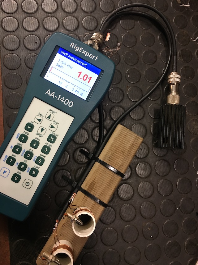

Testing version 2 for insertion loss was easy using WSPR. Looking at some local stations with the preselector inline and then bypassing it, repeated several times, showed an average of 6dB. As per the photo the coax pigtails are soldered straight to the loop couplings, keeps it simple.

Version 2: Version 3 is part constructed, it uses parallel coils vertically mounted, about 40mm apart. Very rough tests showed there may be enough coupling, if not I'll try variations on the gimmick capacitor thing.

Here is my version 3, working really nicely. 7.0386 is the 40m WSPR frequency. Next free time will be a 30m effort.
