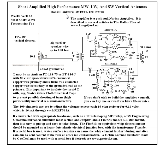

Dear SDRguy22 I read your interesting post on low noise vertical antennas and I have studied the important work of Dr. Langford. I am interested in lowest noise widebandest antennas and I am working with the capacitor theory for the wideband. Now the schematic of Dr. Langford cannot be capacitor as I see ground reference as shown in the schematic I copy below.
Scematic widebandest.png (135.57 KiB) Viewed 110918 times
It says:
works MW, LW, and SW - Works Well at most Short Wave Frequencies too
So it works all over, but current must flow in transformer because of ground connection, but then worse noise come in and also no capacitor, so how can be bandwidest? You have studied & used this antenna & please help explain me.
