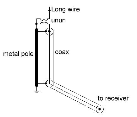

Yes, it's absolutely necessary. I have attached a sketch of my 25 m wire antenna. The ground should be a "good" ground as I mentioned above, not a "ground" connection from an outlet in the wall or similar. House electrics carry too much noise. The current baluns may be obsolete when you live in a low noise environment. They help me to suppress common mode noise travelling either from my house to the antenna or from the coaxial cable to my receiver.5) Will a ground improve performance, if yes, how do I ground the antenna and/or RTL-SDR V3?
- lw.jpg (20.14 KiB) Viewed 45392 times

Hi Heinrich. Very appreciated your sketch. Can you please share some details?DanubeBCL wrote: ... I have attached a sketch of my 25 m wire antenna. ...
1. height of metallic pole,
2. height of wooden pole
3. turns and core for the two 1:1 balun
4. turns and core for the 9:1 unun
5. any special hint due to connect 1:1 balun to 9:1 unun
I 'm sorry to do a sort of "police grilling"...
tnx in advance
gio
Re: Long Wire Antenna Performance Questions
1. height of metallic pole : 8 metres, base connected to ground rods, coaxial cable also grounded at the foot of the mastCaptainNemo wrote:Can you please share some details?
2. height of wooden pole: appr. 14 m (a tree
3. turns and core for the two 1:1 balun: Appr. 30 turns of RG 178 coax. cable on an FT 140-77
4. turns and core for the 9:1 unun: 12:4 in a double aperture core Amidon BN 73-2402
5. any special hint due to connect 1:1 balun to 9:1 unun: no
Annotation: The current baluns may be obsolete when your environment is not noisy. In my case the left current balun (next to the unun) has turned out to be useless after I grounded the coaxial cable shield at the foot of the mast. This was enough to prevent noise picked up by the coaxial cable from travelling to the antenna. BTW: You can also use a wooden pole here. But the coax cable shield should be grounded at the bottom. The current balun next to the receiver is a must for me for any antenna. Unfortunately my PCs, monitors, switched power supplies (even badly shielded USB cables, I could not believe this) induce noise into the caxial cable. I have also seen fotovoltaic inverters from my neighbours inducing noise (magnetically) into my coaxial cables via the open power lines which we still have "in the air" here. That means: The noise is even there when there is no antenna connected or when the far end of the coaxial cable is terminated with only a 50 Ohms resistor! The current balun at the receiver suppresses this noise effectively.
But for the noise going directly into the antenna itself there is no remedy. And this becomes more and more almost weekly. The actual consumer electronics in the houses do not care of de-noising any more. And they even do this with legal approvement. The authorities do not care. And then there are these homeplug PLC modems in the houses. A nightmare. You can put as many efforts into your equipment as you want. You cannot get rid of their high broadband noise.
