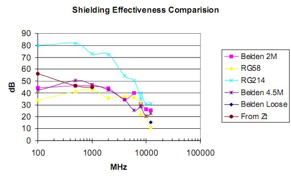

People are often not aware how coax quality is generally more important today, sometimes (or maybe particularly) even seasoned hams and SWLs, because they made contact with the hobby in times when the coax shielding was in fact less of an issue.
Many, if not most of us live in houses with lots of modern electronics, switching PSUs in wall warts, computers and controllers on all kinds of appliances and so on, all creating wideband noise that wasn't around in ye olde days. On top of that we play "radio" with a computer and usually other electronics in the same room, with the receiver only a USB cable length away from the computer. Then some of us have neighbors with the same amount of wideband noise stuff per household, adding up to the "noise cloud" in which we live. Quite often, the coax runs for considerable lengths through this noise, sometimes even in close proximity to the noise sources.
Even when your receiver is sitting on the window sill and the coax leaves the house after a few inches, it's still running through the "noise halo" that surrounds buildings. Old sources claim that said halo can extend "5m/15ft" beyond the walls, but given the considerably higher amount of noise sources today I'd say that distance should be doubled. So we can assume that even under ideal circumstances, the coax would be running for at least 5m/15ft through noise fields.
So what does that mean? I said above that the simple shielding of RG-58 gives you an attenuation of 45dB at best. The graph above indicates that it's even worse but let's ignore that for now. Now even if your noise doesn't exceed -70dBm anywhere on the length of the coax, the best you can hope for with RG-58 is getting this down to -115dB. IIRC the internal noise floor of the RSPs is around -130dBm, so there's still 15dB of added noise and not matter how good your antenna is/could be, a whole layer of otherwise clearly discernible signals will be covered by that noise. The remaining stations will suffer from a decreased signal-to-noise ratio and fading will have more impact on intelligibility, because - after finding the best receiver and antenna your money could buy - you skimped on the coax.
Of course, unless your QTH is in the ITU "rural/remote" category, your antenna picks up considerable amounts of QRM too and maybe you're more interested in listening to rather strong broadcasting stations, so this may not matter that much for you but if you're after DX and want to get the most out of your receiver, use proper coax! H155 is not cheap, but its shield is good for 80dB of noise suppression and its 5mm diameter fits SMA connectors nicely.
Some graphics in this blog post illustrate the problem a bit:
http://newsroom.bonito.net/why-even-goo ... e/?lang=en

Good shielding of the coax cable is only one small part of the story.
In most cases sheat waves on the coax shielding are more evil. The only remedy against this is common mode chokes. In the vicinity of power lines the RF noise (inside and outside of houses) has a strong magnetic component. It induces noise in the coax cable. The best shielding cannot prevent this. In my garden any(!) long coax cable (low or high quality) connected to the RX without any antenna (only 50 Ohms terminated at the far end) receives high noise in the VLF and LW section. The shielding is not the problem! Only a common mode choke with high inductance reduces the noise on the cable.
But most of the noise is picked up by the antenna itself. In our environments many strong RF noise generators pollute all the air around the houses and cause interference within a radius of several hundred meters. Nothing can help against this noise. No shielding, no burying of cables in the ground, no common mode chokes, no grounding.
Dennis from bonito complains about RF noise from homeplug powerline modems (PLC) in his neighbourhood under the URL you quoted. Then he recommends coaxial cable with good shielding in this context. But he does not prove that a better shielded cable really helped against the high broadband noise levels such PLC modems generate. The reason is simple: The noise is picked up by the antenna, not by the coaxial cable. Well, over all: He wants to sell H155 and Hyperflex cable in his shop.
Of course I prefer cables with good shielding, no doubt. But they are not the ultimate cure of noise problems. One should not expect wonders. Most of the noise comes in through the antennas.

DanubeBCL wrote:Good shielding of the coax cable is only one small part of the story.
Well, I didn't mean to write a book here. ;) I just felt like elaborating on why exactly RG-58 is bad m-kay, because it came up in some other thread.
DanubeBCL wrote:In most cases sheat waves on the coax shielding are more evil. The only remedy against this is common mode chokes.
Actually I had a follow-up post about common mode noise saved as draft. However, dealing with
common mode issues does not make much sense when your coax is quite permeable in first place. Bad shielding means direct noise pickup by the center lead (no way to cure this except using better coax), common mode currents mean noise radiation by the shield, which the antenna will pick up (can be remedied by chokes, buried feeder line, grounding... or probably not using coax at all). Even if someone's antenna situation and surroundings are excellent, both bad coax and common mode currents will spoil the results unnecessarily, but there are remedies for both.
DanubeBCL wrote:But most of the noise is picked up by the antenna itself. In our environments many strong RF noise generators pollute all the air around the houses and cause interference within a radius of several hundred meters. Nothing can help against this noise. No shielding, no burying of cables in the ground, no common mode chokes, no grounding.
Of course I feel sorry for your situation but I feel there's some bitter over-generalization in that statement. People in this forum live all over the world, each in a highly individual reception situation, and not all of us are in such a bad situation. Of course you are right, local "propagated" noise (as opposed by near-field noise) is hard to fight, no matter if the source is 100m or 100km away. But (hopefully) for the majority of people here, that noise floor is below the near-field noise level and once the near-field noise is properly treated, it should be true again (and a good thing too) that all of the residue noise is being picked up by the antenna in form of regular, "propagated" QRM.
DanubeBCL wrote:Of course I prefer cables with good shielding, no doubt. But they are not the ultimate cure of noise problems.
True, but nobody claimed anything like that. My point is that for us SDR users, bad coax is one ultimate source of noise problems.
DanubeBCL wrote:One should not expect wonders. Most of the noise comes in through the antennas.
Which...again...cannot be generalized that way. However, the one common issue we all really have is more or less intense noise in the shack, because even in best case we still use a computer-based receiver, usually powered by a crappy switching PSU, which gets its power from a working grid and realistically we usually have some more noise sources in the shack, and very few of us live alone in a house with no neighbors. So without good shielding, all efforts to reduce noise may be futile, that was my point about single-layer shielded coax specifically.
