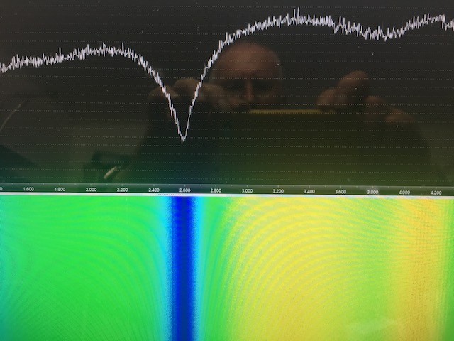

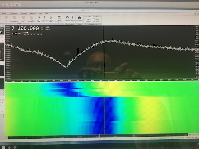

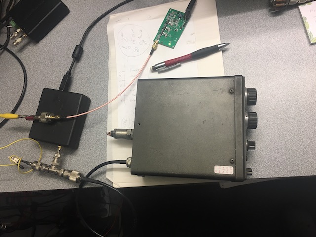

As a result of an email from a member I thought this might help illustrate the notching ability of an old ATU.
Did an experiment with the setup as illustrated below.
1) cheap eBay noise generator with it's output loosely coupled to an RSP1A input T connector
2) pretty ordinary low Q Kenwood old mobile ATU that does 80m to 10m
3) ran the RSP1A from SDR-Console v3 with 8MHz bandwidth and fixed AGC at 35dB. SDR-Console made it easier to adjust waterfall frequency and dynamic range.
Cheers and 73,
Phil
PS. Forgive the cheap and nasty camera shots of the screen, didn't have time to do proper screen dumps and move them to the computer inside.
PPS. Computer hardware is an ageing 27" iMac running Windows 10 in VMWare Fusion allocated only 2MB RAM and using 2 cores
Picture1 shows 4.6MHz to 9.4MHz
Slid the ATU from 7.1MHz down to 5MHz as you can see by the moving blue notch
The notch depth is roughly 26dB.
Picture2 shows 1.4MHz to 4.3MHz
Shows the notch at 2.6MHz
The notch depth is roughly 33dB.
Setup:
RF white noise generator with output loosely coupled by wrapping a few turns around an alligator clip sticking out of the antenna side of the T
The ATU 'radio' connector is on the other bar of the T
You can see the short circuited UHF connector on the 'antenna' input of the ATU
