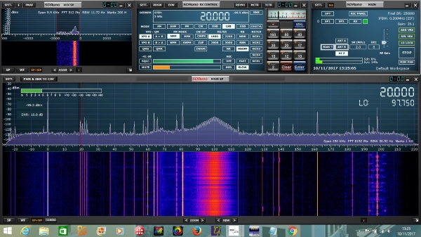

I use my Wellbrook 1530 withthe Hi-z port, as this port is more suited to LF/MF/HF use. It has lower noise, lower gain and better overload characteristics than the other two ports (at these frequencies). I keep the ports A & B for VHF. The one disadvantage of the Hi-z port is the lack of filtering - all it has is a 30 MHz LPF, so I found some pre-selection helped keep some unwanted signals out. I know I've posted this before, but here is the spectrum 0 to 200 KHz as received here. I had a LPF in line at the time to keep out the strong MW signals. You can see all the usual clock/time/frequency signals right down to 20 KHz, and the noise is low thanks to the 1530 loop.

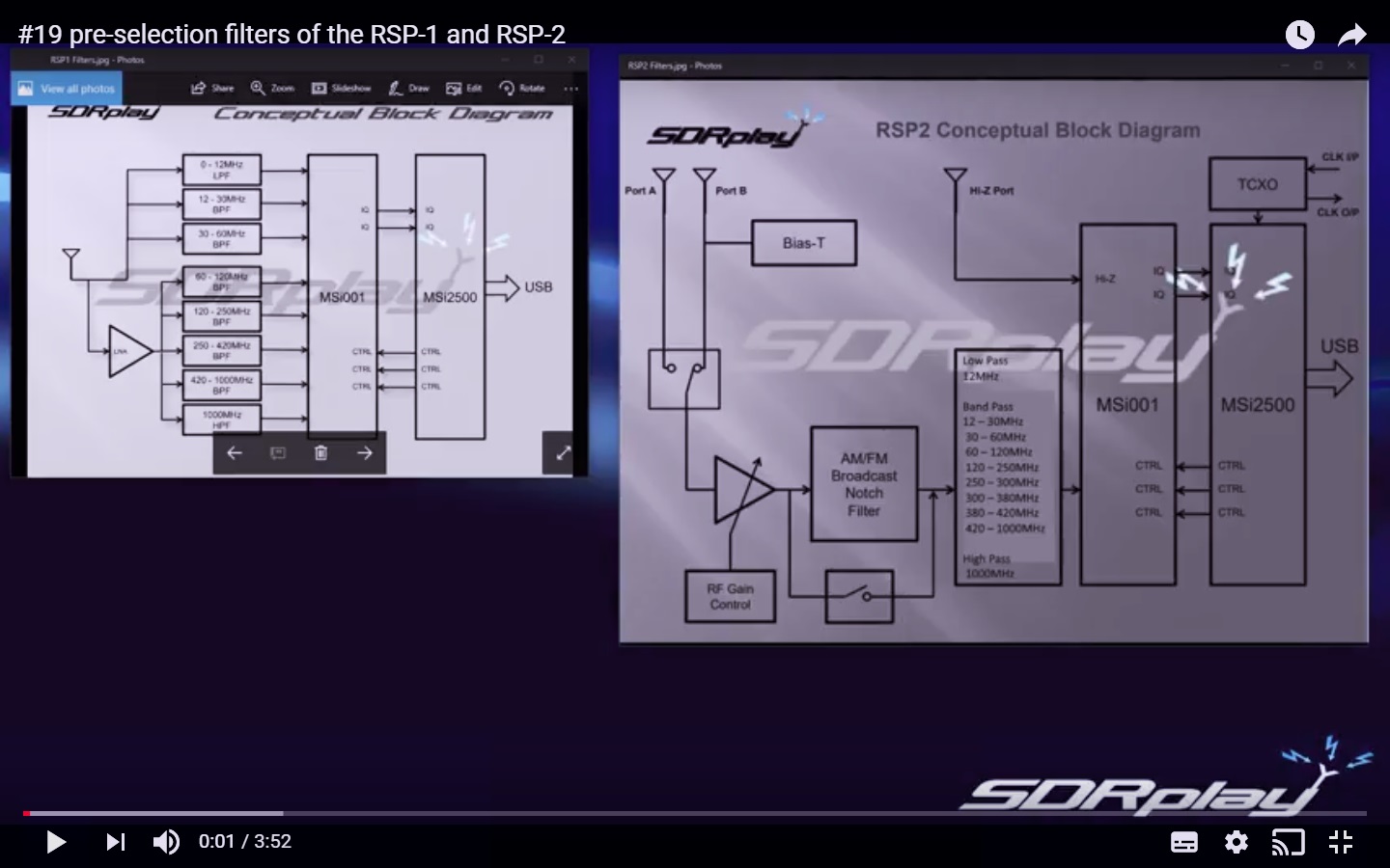

Just a question though - I had always believed that the MW/FM filters on the RSP2 only apply to Ports A & B.
However (an uneducated) look at this BSD seems to indicate that they are automatically applied to the HI-Z port.

Paul - the two diagrams in you last attachment are for different RSPs. The left hand one is for an RSP/RSP1, the right hand one is for the RSP2.
There are no filters on the HiZ input - check out the document "Optimizing RSP1A performance below 60 MHz" on the SDRPlay web-site See the parargaph at the bottom of Page 7.
The output of the Wellbrook antenna should be matched to 50ohms - so you should be using port A, as you don't need bias-T.
The Hi-Z input is more suited to a long-wire antenna.

I was, of course, aware of the two different bsd's, but was only interested in the RSP2 flavour and was familiar with the stated filter arrangements, but failed to understand why a direct link from the filters in A?B to the Hi-Z was indicated by the linearrow-head, but then I'm no engineer, so I just accept what I'm told.
