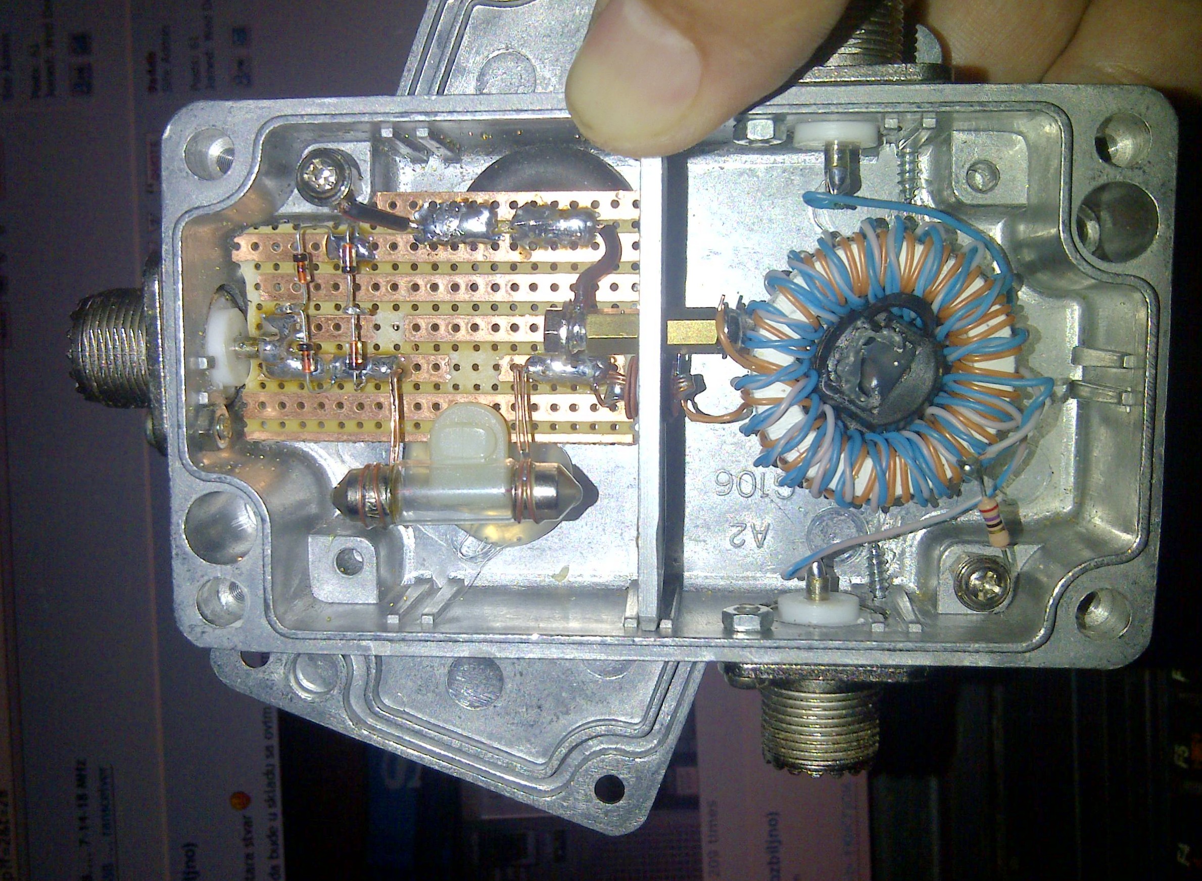

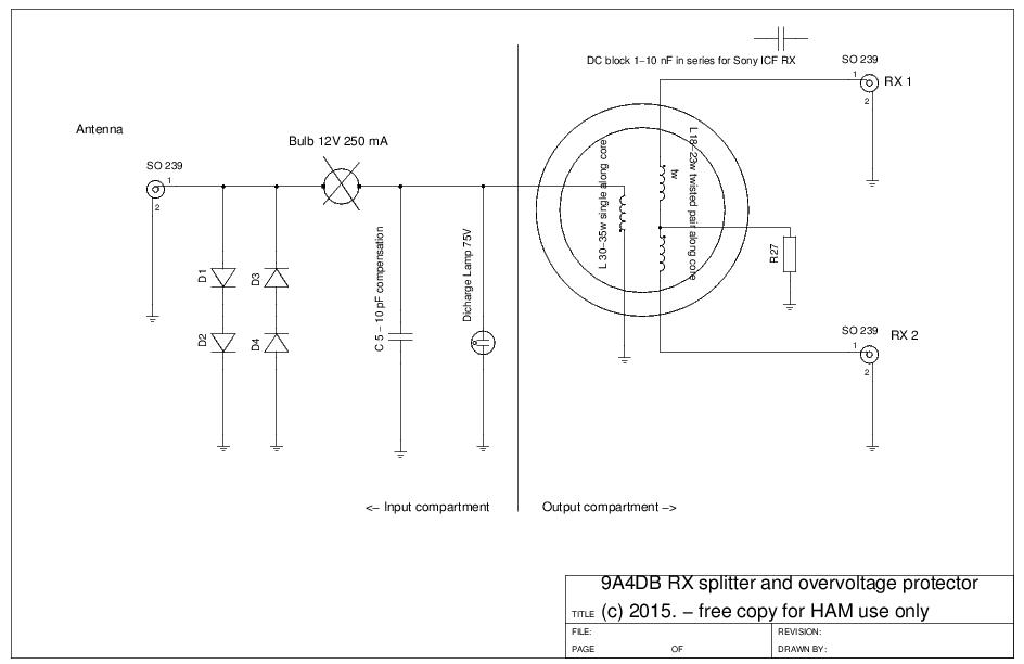

This is my solution, protection with distribution of signal to two RX, designed initially for Sony ICF 2001D RX...
D1-D4 = > 1N4148
Discharge element, Bourns 2057-07 Series Light Duty 2-Electrode Miniature Gas Discharge Tube (75 V)
Bulb 12 V 250 mA
Picture taken before Bourns 2057-07 was installed
vk7jj
Posts: 206
Location: Tasmania
Re: Newbie RF frontend protection Qs
Post by vk7jj » Fri Jun 01, 2018 2:19 am
D1-D4 = > 1N4148
Hi Djani,
I use the same diodes and this whole protection issue has bothered me for years.
I'm guessing your use of series diodes raises the issue of the effects of clipping where a single diode is used and the received signal is strong enough to be desirable but not so strong as to warrant protection, if that's not an oxymoron. I'm too far away from anything remotely strong enough to be in that category but I finally got off my bum and made a few quick measurements of induced power in one antenna while transmitting on an adjacent antenna.
Antennas: two 160m diameter delta loops, their fed corners are at their closest points to the radio shack and are 15 meters apart.
Transmitter on antenna #1: 50 watts
Measurements were made on antenna #2 of the peak-to-peak volts as viewed on a 0-30MHz oscilloscope terminated with a 1k resistor:
1.8MHz -> 63 volts
3.6MHz -> 60 volts
7.1MHz -> 14 volts
10.1MHz -> 16 volts
14.2MHz -> 12 volts
18MHz -> 16 volts
21.2MHz -> 16 volts
24MHz -> 24 volts
28.4MHz -> 6 volts
I used 50 watts as a conservative starting point, as we know many hams use much more than that.
Like most hams I have a bunch of other antennas on 6M, 2M and 70cm all on the same tower as antenna#1 is terminated at, with two Yagis only a meter or two away depending on where they are rotated. The 30MHz CRO meant I couldn't check 6m which is where I think my most risky situation might arise.
As per Roger's use of a filament, is it the unstated consensus that the diodes will outlast the filament, ie. they will clamp the voltage long enough for the filament to rise to it's burn out point and act as a fuse?
My unstated concern is that with (say) a 100 watts 6m signal on antenna #1, the random length of my feed line in respect to a 6m wavelength on antenna #2 may via impedance transformation result in a significantly higher voltage with a very fast rise time at the receiver than my lower frequency measurements reveal.
Also the terminating impedance I used was a 1k ohm resistive load, in contrast people may well be using a 1:9 balun connected to the high impedance input of an RSP2 resulting in significantly higher voltages at the RSP.
Regards,
Phil
9a4db
Posts: 29
Joined: Sun Jan 24, 2016 6:44 pm
Post by 9a4db » Sun Jun 03, 2018 7:13 pm
Hi Phil,
The only reason of double in serial diodes use, is to avoid intermodulation during
the evenings when HF signals are stronger.
For the rest, please look on my schematic. Let's imagine few possibilities:
1. Diodes are ground for all +1,4 or -1,4V or more on input... if is to much current - than diodes are history ;)
than....
2. pure static DC is grounded permanently through primary side of splitting RF transformer
3. pulses also going to ground thru the same path, if strong enough bulb filament may rise the resistance,
if pulse level is strong enough (over 75 V) than gas discharge tube is ground too. All that must result in bulb filament burn out.
Result antenna disconnected.
The only weak point of my solution is: if on one of exits some TRX is connected and PTT keyed, than the
other side is smoke :D
73
Djani

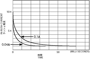

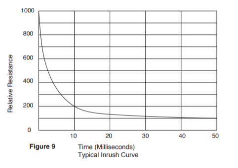

Phil - Incandescent bulbs take far less than 150 milleseconds to achieve maximum resistance. In 5 milliseconds
they are at 1/2 maximum resistance and at 10 milliseconds have reached about 80% of maximum resistance.
Source 1 - https://vcclite.com/wp-content/uploads/ ... -paper.pdf
Source 2: - https://www.allegromicro.com/~/media/Fi ... ECEEE9A2AF
Tungsten-filament incandescent lamps exhibit a very-high
positive temperature coefficient of resistance with the cold filament
resistance being approximately 10% of the hot filament resistance.
When an incandescent lamp is initially turned on, the cold filament
is at minimum resistance and will normally allow a 10x to 12x peak
current. Within 3 to 5 ms the current falls to approximately 2x the
hot current
Source 3: http://www.tlt.co.jp/tlt/english/produc ... g/info.htm
