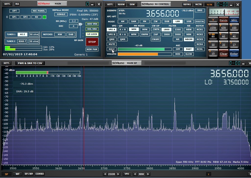

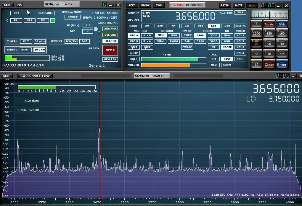

Here is the detailed report:
1) The antenna is mounted on a 1.8 m steel pole which goest through the roof and is mounted with two steel brackets to a wooden beam of the roof. There is an elecrical (not RF!)) ground tied to the pole which was wired ages ago and is connected to the general electrical wiring of the house.
2) At the base of the Discone there is an UHF female connector. A male UHF connector connects here carrying the RG58 coax. The coax comes in through the roof with a length of 2.4 m and here I have wound the choke using extra length cable I had prudently left in place. I used a 4" dia. standard water bottle full of water for easy winding, then emptied the bottle & dried the inside with compressed air.
3) The choke amounts to 12 full turns, close spaced and looking at Bas' reference should be good from 2.5 to 30 MHz. I removed the toroids at the receiver's end.
4) Performance is as follows
144 - 148 MHz - no isolation transformer - good performance.
118 - 136 MHz - no isolation transformer - ood performance.
21 MHz - cannot test, no propagation, will report later.
14 MHz - cannot test, no propagation, will report later.
7 MHz - no isolation transformer - good performance: loss compared to 135 m Beverage is 12 to 15 dB.
3.6 MHz : with no isolation transformer no signal gets thru, noise level (power meter) is -94 dBm: antenna not useable.
3.6 MHz : with isolation transformer noise level (power meter) is -112 dBm and signals do get thru: loss compared to 135 m Beverage is 18 to 20 db.
From all the above it would seem that this very small Discone is still useable at 3.6 MHz, provided an isolation transformer is used at the receiver's end. More tests to follow.

- Discone compare Discone.jpg (189.88 KiB) Viewed 45894 times
- Discone compare Beverage.jpg (195.02 KiB) Viewed 45894 times

Re: Extending the range of a Discone antenna down to 3.6 MHz
Hi Bas,
Yes, the noise did go down on (almost) all HF frequencies, I thought this would be clear from the PC screens. What I had before was that at 7/14/21/28 Mhz I had noise higher than the Beverage, while signals, when present, were lower than those from the Beverage. Now on 7/14/21/28 noise is lower (as the signal) than that of the Beverage, as it should be.
The exception is at 3.6 MHz. Here the noise was -95 dbm yesterday and still is -95 dbm today (power meter measurement) if I do not use the isolation transformer signals are buried in the noise. As soon as I stick the isolation transformer in, noise drops to -117 dbm (power meter) and the receiver comes to life with plenty signals.... a big result for the cost of a 50 cent toroid!

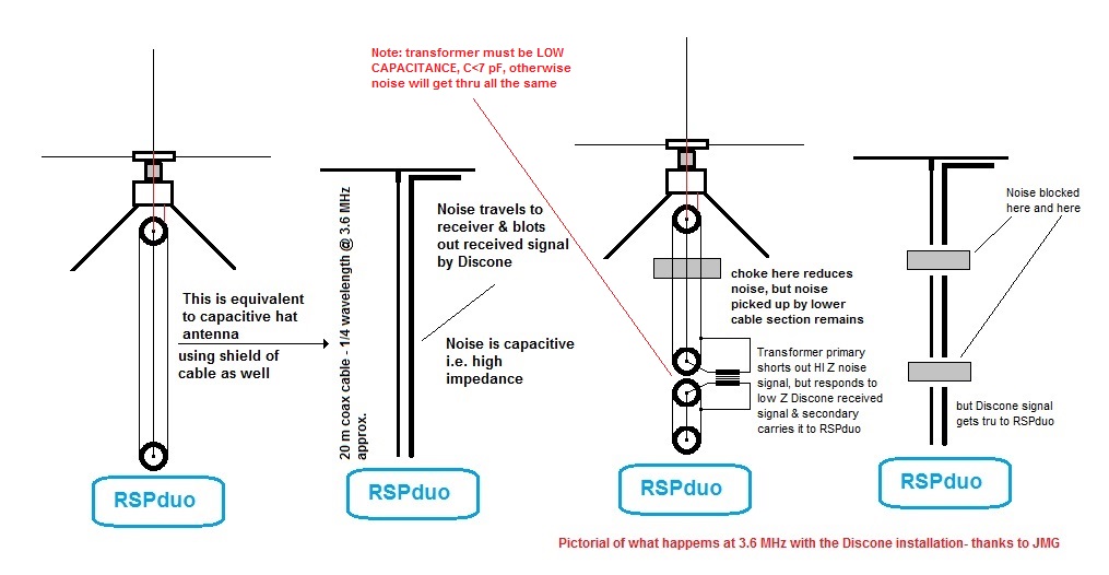

Following your analogy of noise travelling back and forth, I think the isolation transformer simply, but effectively, completely blocks the noise currents at 3.6 MHz, making the antenna fully useable at this frequency as well.
Installing a common mode choke at the upper end of the antenna cable, the antenna will not work at low frequencies. At low frequencies the primary antenna element is the antenna cable.
Installing the choke at the lower end results in a completely different antenna: it is a unsymmetrical dipole then, one leg given by the antenna elements of the discone and the other by the antenna cable. The feed point is in between at the discone side.

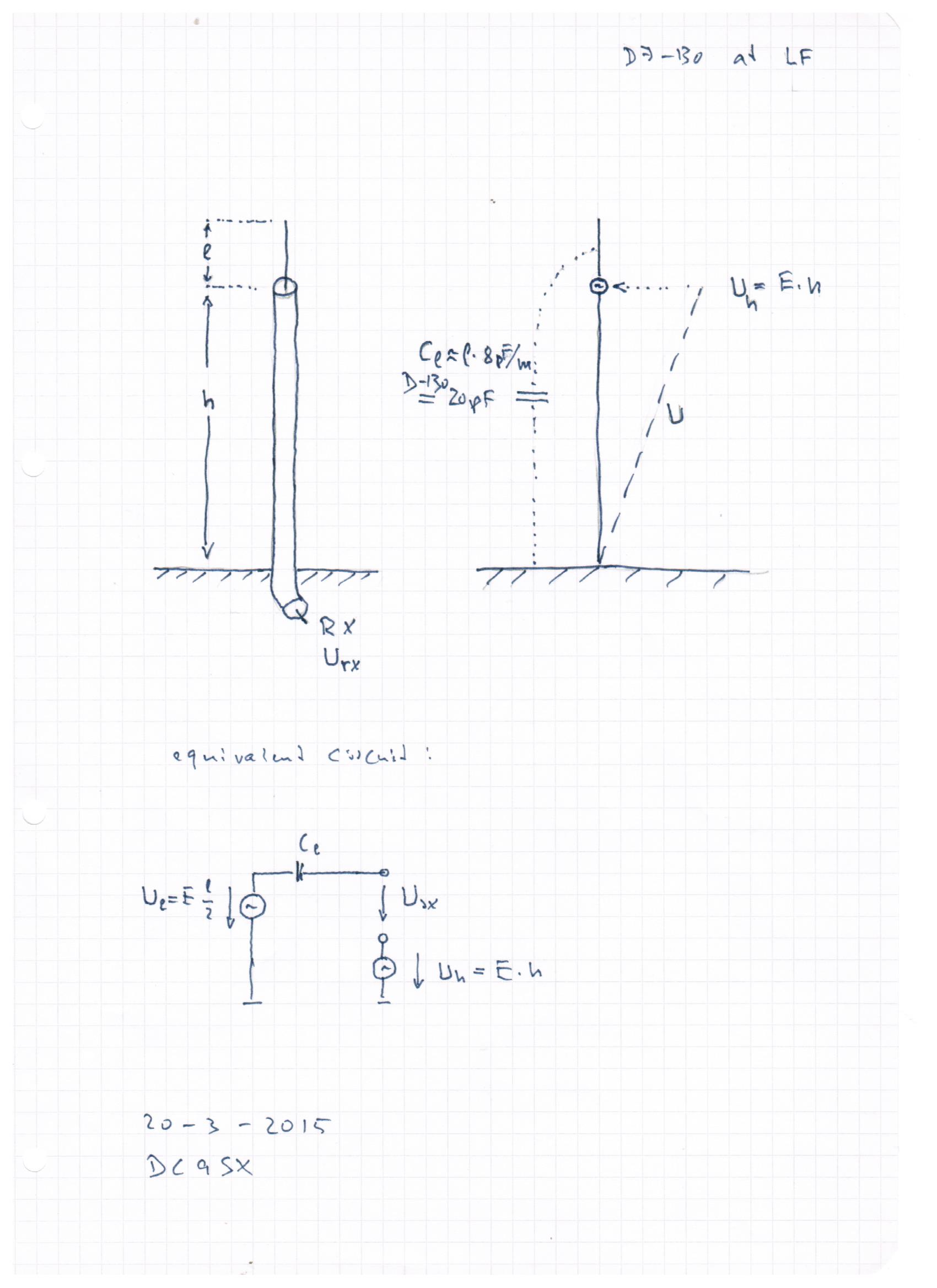

Some time ago I did run some tests and simulations on the antenna at low frequencies. Here you find a comprehensive presentation of the basics. It may help to answer some of the questions.
At my installation (l = 15m) the antenna gives good results up to a frequnecy of a wavelength of 4l=60m or f=5MHz.
The voltage distribution on the cable (sin) shows a minimum at a length h of half a wavelength. Uh will be unusable low.

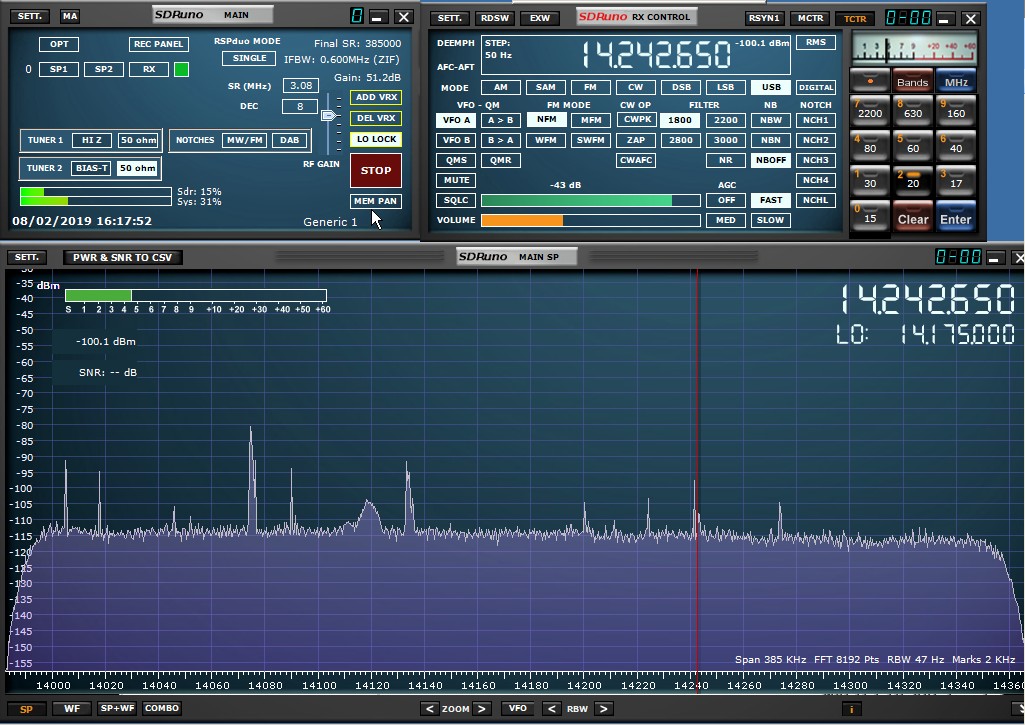

I have removed the electrical ground and found no difference, so the bottom line is that the Discone antenna, plus the support pole, plus the 20 m coax cable "float" with no ground connection at all and provide the already described performance.
The 20 m band opened up and again I had to use the low capacitance isolation transformer for best performance, as shown in the comparison with the Beverage screens below. As soon as I saw that also the 20 m band required the isolation transformer and furthermore saw the concise explanation uploaded by JMG (thanks!) the penny dropped and I drew what happens in the pictorial below.
The Discone + the support pole + the 20 m coax cable form an extra, top capacitance loaded, antenna at 1/4 wavelength (3.6 MHz) and at full wavelength (14 MHz). Local noise travels on the the shield and reaches the RSP receiver at a high impedance. The top mounted coax choke eliminates the top portion, but it is not enough. What kills the remaining noise is the low noise magnetic transformer: primary shorts out the high impedance noise, but true antenna signal current flows thru it and reaches the secondary, providing a "clean" signal to the RSP. For this trick to work, the transformer MUST really be LOW CAPACITANCE, 7 pF or less. I made another transformer with a type 73 material binocular core and all noise gets through, no dice. Will show this in the next post. To conclude, my idea is that all antenna lead-ins for reception must be balanced and therefore the balanced inputs of the RSP's are a great asset, as fantastic assets are low capacitance / low noise transformers on antenna leads, as I have been experiencing since June 2018.

- Discone phenomenon pictorial.jpg (109.19 KiB) Viewed 45817 times
- Discone @14 MHz with xfrmr.jpg (196.6 KiB) Viewed 45817 times
- Beverage @ 14 MHz.jpg (196.74 KiB) Viewed 45817 times
