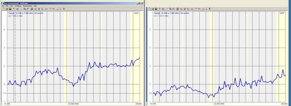

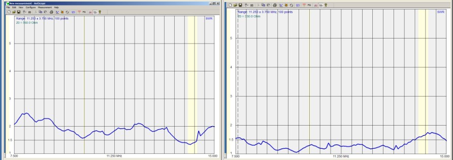

BEVERAGE ANTENNA TERMINATION - 2
- THE FAR END TERMINATING RESISTOR

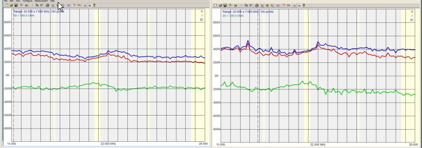

Test results compared at higher frequencies: Real part.
- I. Compare 7500-15000.jpg (57.76 KiB) Viewed 74339 times
- J. Compare 15000-29000.jpg (60.86 KiB) Viewed 74339 times

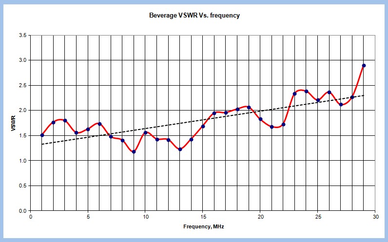

Re: NOISE ADVANTAGE OF LONG WIRE ANTENNA FAR END TERMINATION
Test results compared at higher frequencies: VSWR.
- D. Compare 7500-15000.jpg (49.13 KiB) Viewed 74339 times
- E. Compare 15000-29000.jpg (62.41 KiB) Viewed 74339 times

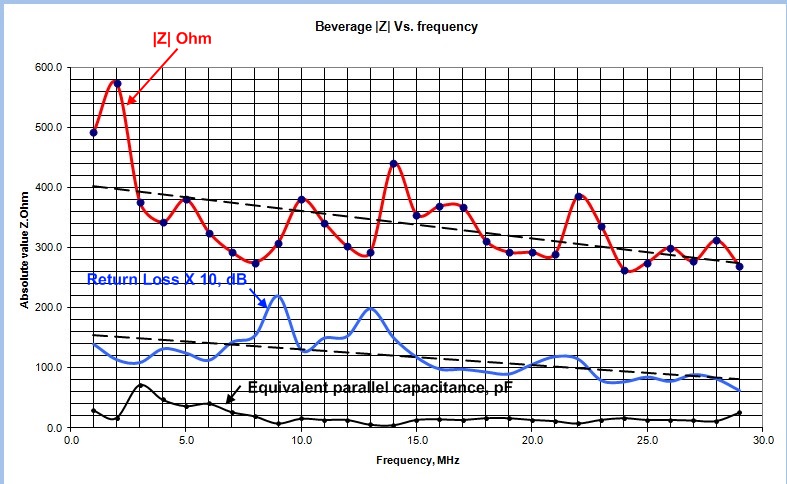

BEVERAGE ANTENNA TERMINATION - 3
- THE FAR END TERMINATING RESISTOR - MEASUREMENT DATA SUMMARY

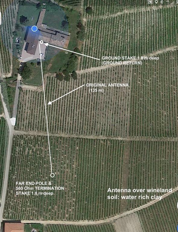

Below is the data summary across 0 - 29 MHz in 1 MHz steps for |Z| and VSWR with a 390 Ohm load resistor, 3.6 m deep ground stake at the far end and 1.8 m depth ground stake at receiver's end. Straight dotted lines show parameter trends. As already mentioned, the graphs show that the ideal far end termination is greater than 390 Ohm and is in the order of 450 Ohm for more balanced VSWR across the HF frequency range. Figure 1 shows large |Z| variations and also large equivalent parallel capacitance variations at frequencies below 4 MHz: in fact the antenna is one wavelength long at 3.8 MHz and is too short at lower frequencies. Figure 2 shows that VSWR increases with frequency, but is always below 3.
Figure 3 shows the original antenna layout before modification. The near end (receiver) termination will be discussed next.
- Figure 1. Equivalent impedance |Z| vs. frequency
- 1. Beverage Z vs. freq.jpg (153.04 KiB) Viewed 74306 times
- Figure 2. VSWR Vs. Frequency
- 2. Beverage VSWR vs. freq.jpg (60.01 KiB) Viewed 74306 times
- Figure 3. Original antenna layout before modification
- Aerial 3.jpg (117.07 KiB) Viewed 74306 times

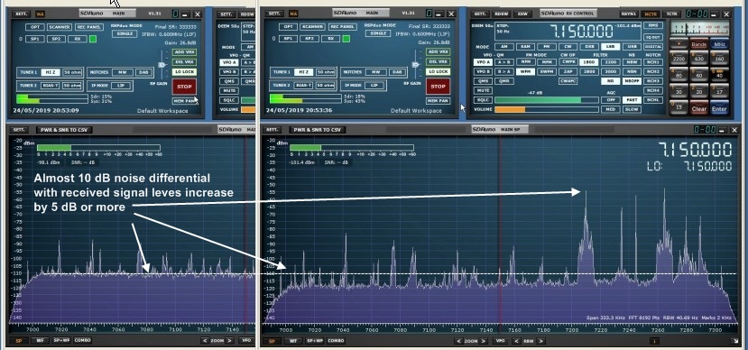

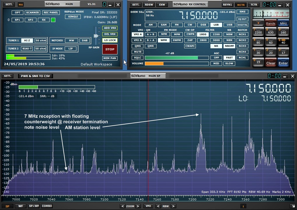

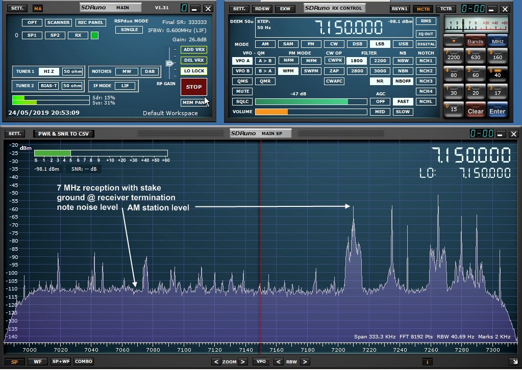

NOISE PERFORMANCE COMPARISONS - 2
More detailed comparison @ 7 MHz, after sunset, 19:10 GMT. The screens (taken seconds from one another) demonstrate that, with the modified termination setup, received signal level increases while noise level goes down by a very significant amount. This condition of course happens only if man made noise is present. If there is no man made noise around, then there is no noise differential between the two setups, while the increase in received signal is due to the better efficiency of the floating counterweight, as compared to the efficiency of the ground stake as antenna return at the receiver's end.
In other words it is not that the antenna "eats up the noise": it simply does not pick up the man made noise, if present. Therefore the noise differential between the two setups is not constant, but increases or decreases according to the man made noise present at tha instant.
In the next posts the antenna modifications will be described and discussed.
- Reception with stake ground at receiver's end.
- 7 MHz compare 1.jpg (270.74 KiB) Viewed 74266 times
- Reception with floating counterweight at receiver's end.
- 7 MHz compare 2.jpg (274.54 KiB) Viewed 74266 times
- Situations 1 and 2 compared side by side.
- 7 MHz compare 3.jpg (144.77 KiB) Viewed 74266 times

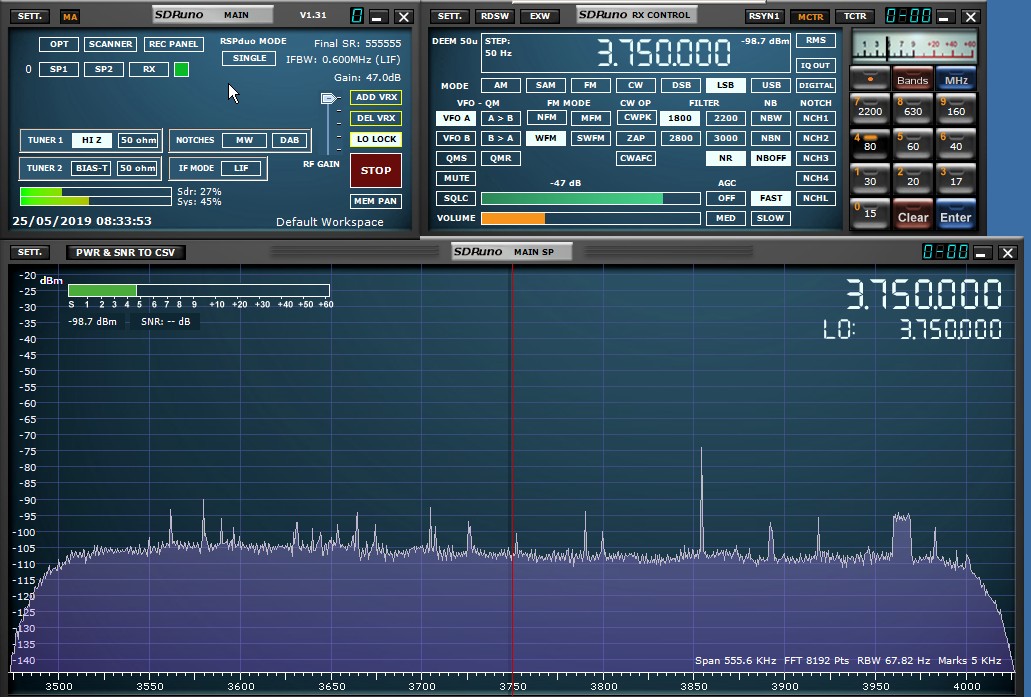

NOISE PERFORMANCE COMPARISONS - 3

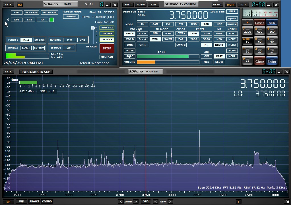

Shown below is noise & signal level differentials @ 3.8 MHz in early morning with little noise.
- 3.8 MHz compare 1.jpg (179.78 KiB) Viewed 74227 times
- 3.8 MHz compare 2.jpg (186.7 KiB) Viewed 74227 times

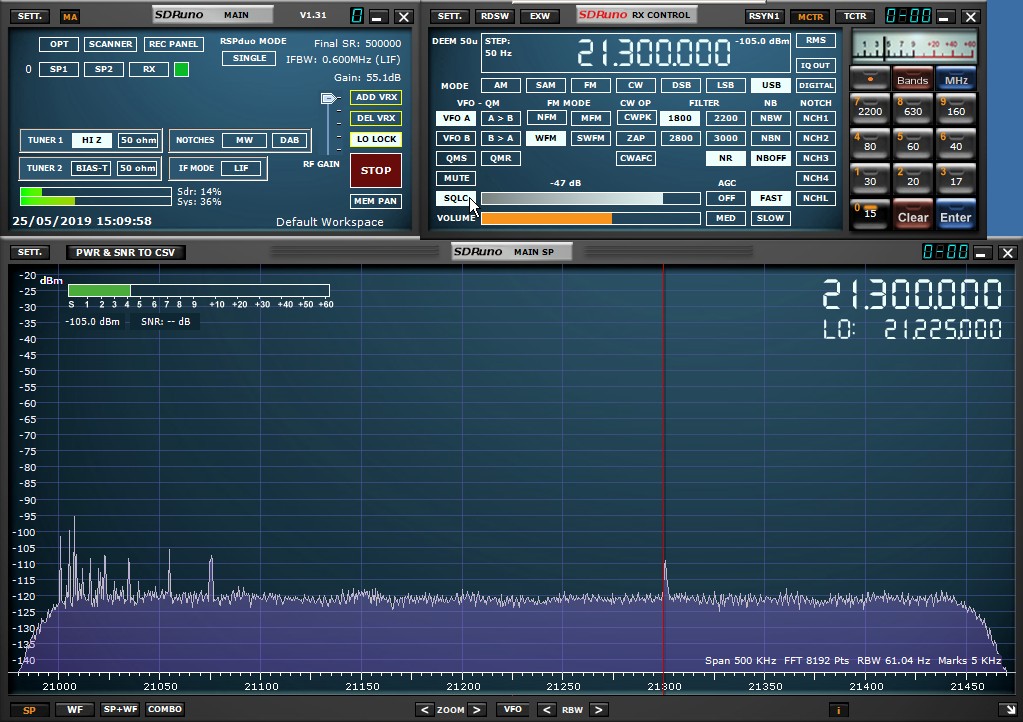

NOISE PERFORMANCE COMPARISONS - 4
Shown below is noise & signal level differentials @ 21 MHz with very weak propagation at midday.
In compare 1 we have -110.9 dBm of....noise at 21.300 MHz, with compare 2 we have -105 dBm with solid copy at the same frequency. This really makes the difference.
- 21 MHz compare 1.jpg (186.36 KiB) Viewed 74193 times
- 21 MHz compare 2.jpg (184.63 KiB) Viewed 74193 times
