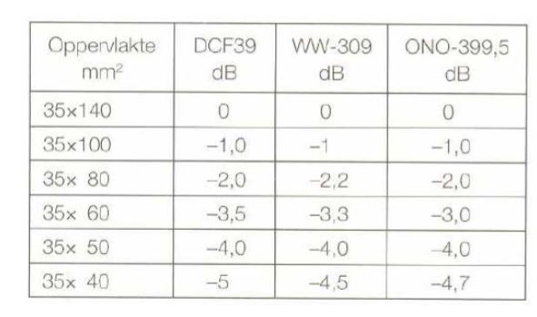

That is exactly the case. I'll quote Bakker on this one:
"A method was developed to compare the signal to noise ratio of active whip antennas. The carrier of
ONO, Ostend, Belgium, is transmitted on 399,5 KHz. With the 100 cm active whip antenna, the
relative signal strength was -19 dBm. This was the signal read at the SPM-3 with preamplifier. The
antenna noise was measured at 399,15 KHz. The measurement was carried out during daytime to
avoid interferences by remote stations through the sky wave. The antenna noise was about -90 dBm.
The measurement was as follows. The receiver was tuned to 399,5 KHz. The signal from the test
antenna was adjusted for -40 dBm using the RF attenuator. Then at 399,15 KHz the antenna noise
level was determined. Table 1 shows the results of the measurements."
If the whip is shortened, the signal strength decreases gradually. A whip with a length of 30 cm
gives a signal that is 7 to 8 dB lower than with an antenna of 100 cm. The length of the whip does
not affect the ratio between the received signal and the received noise. This is confirmed by the
practice. In the Faroe Islands there are three aircraft beacons coming out in daytime just above the
noise level. They were received on a 30 cm long whip as well as with the 100 cm one.
http://dl1dbc.net/SAQ/Mwhip/Article_pa0 ... nglish.pdf
Re: New Sdrplay and antenna creation
Post by Mike2459 » Fri Jun 07, 2019 6:06 pm
Bakker got his units wrong in the text. The units in the text should be millimeters (mm) not centimeters (cm). The units used in the table are correct.

To look at all published material on this antenna would take ages. Enoug to say that, if the above is correct, increasing the SURFACE of the PC board devoted to the "capacitive coupling" should increase the antenna output, so why is it kept so small? I just does not make sense. Now, in another text it is stated that performance does not depend on antenna surìface size. On the contrary, in the further text by Roelof you show that signal vs. size has a (logical) meaning, so it is difficult to understand the reason why using such a small surface is used in the actual antenna.
For a wire the sensitivity is primarily determined by it's length. For a rectangular plate, for all practical purposes, by it's perimeter not its area.
Look Mike, if we talk capacitance, we must talk surface, please let us at least agree on this...However I got the bug now, and sooner or later I am going to prove to myself that this device works in practice even though it does not work in theory. At Philippi we shall meet again!
It does increase the output. But the relationship between surface area and output is non-linear. That is, if we double the area the output will not double.
Perhaps it is an exponential relationship.

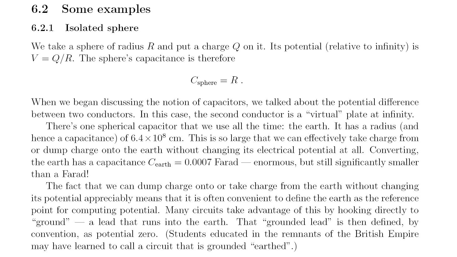

Post by glovisol » Sat Jun 08, 2019 4:43 pm
Mike,
The earth has a capacitance of 1 Farad and there is ....no other plate. Just look this up...

Post by Mike2459 » Sat Jun 08, 2019 5:21 pm
This fellow at MIT says it is smaller and that the other plate is infinity.
http://web.mit.edu/sahughes/www/8.022/lec06.pdf
An interesting read that might have some clues.
Mike
