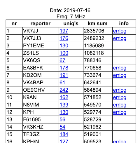

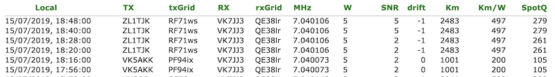

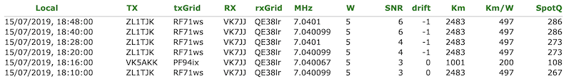

.. pity about the page break, I'd better post the comparison pic again
Here is the Kenwood
Here is the RSP1A
c) From the spreadsheet analysis of the many hundreds of spots from the last 24 hours it appears the RSP1A's WSPR noise floor is -29dB as compared with -33dB from the Kenwood so there is not much in it otherwise as you can see from the stronger SNRs above.
