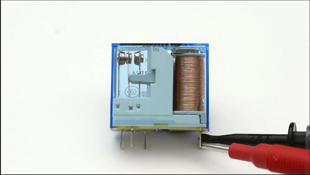

This looks like the data sheet for Glovisol's relay, follow the link below and then click the "Download PDF" button
https://www.radiolocman.com/datasheet/pdf.html?di=135545
Contact material = Silver alloy AgCdO、AgSnO2、AgNi
Contact resistance = 100mΩ(1A 6VDC)
Sealed construction as opposed to just "dust proof" is shown by the -SL- designation on the relay case.
I can't see if my Songles are potted or how they are sealed because they come attached to PC boards with the drivers on, maybe Glovisol could turn his upside down and see what it actually looks like?
The mechanical and electrical endurance numbers look like overkill for the modest number of switching movements when used as an antenna switch and the contact resistance remains as spec. for the given endurance.
No wetting current is specified as being required so it's not a case of being designed to require current flowing through it, that's not an issue anyway because Glovisol's circuit shows plenty of Tx RF flows between J1 and J2 or R1.
https://en.wikipedia.org/wiki/Wetting_current
The worst case scenario as pointed out by Ian is that the Rx might be rendered deaf with rising contact resistance caused by oxidation and he's alerted us to that, which is good.
In the absence of any evidence to contradict the manufacturer's spec. it must stand.
So what does that leave us with? A really helpful and neatly designed foolproof antenna switch.

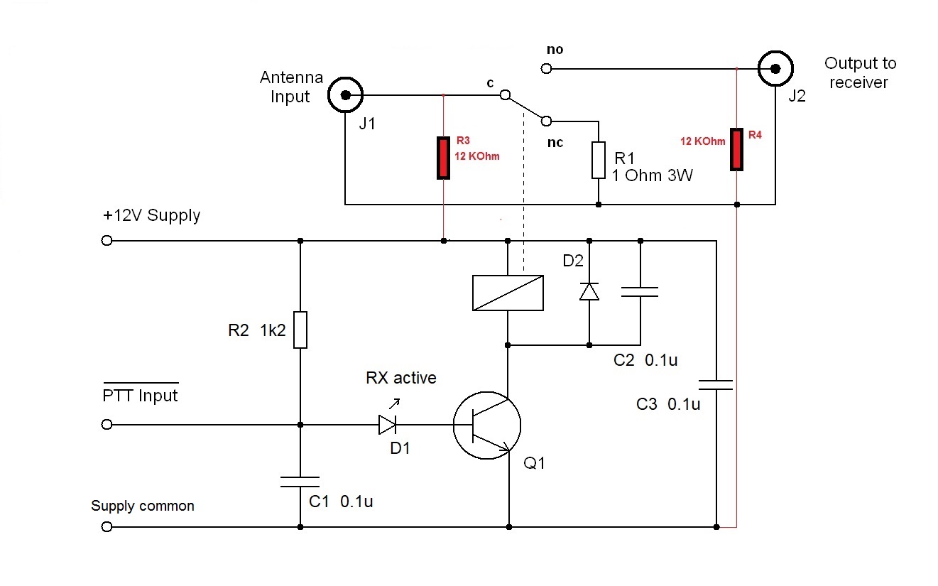

No hard feelings at all, in fact I am very glad we can seriously discuss this antenna switch. First of all we must clear possible misunderstandings.
1) This antenna switch is NOT an antenna commutator in the usual sense. THERE IS NO CONNECTION AT ALL TO A TRANSMITTER OUTPUT. What the relay does is to DISCONNECT the RSP input from ITS OWN ANTENNA and SHORT CIRCUIT TO GROUND, through a limiting resistor, the RF power that might be coupled from the separate transmitting antenna to the RSP receiving antenna.
2) Thus we have ONLY ONE relay contact, the one shown in all schematics.
DRY CURRENT
From the above I can agree with you that, although some current will always flow when the transmitter is active, due to the RF current caused by the coupling between transmit and receive antenna, no current is ever flowing during receive, so there is the theoretical possibility that in the future the contact making to the receiver input will develop a high resistance.
CHEMICAL FAILURE
I do not know and nobody really knows, probably not even the manufacturers, what is the degree of isolation from the external atmospere the relay has. This is important, because it is only through chemical attack and hence oxidation, that the relay contact may fail. You have noticed a tiny hole on similar type relays. I confess I have never seen one, but I shall check when I have a chance. On the other hand, as already explained, I have been using this relay in a salt, marine atmosphere with no problems for several years.
So, to conclude, yes, there is the theoretical possibility of contact failure due to contact oxidation and zero current, but this relay is not being used on an aircraft or on a spaceship, it is used in a radio shack and can be easily replaced. Furthermore is is very easy to eliminate dry current operation. Let us add two 24 KOhm resistors (in red) and have a 0.5 mA current thru the contact all the time. The 12 KOhm resistors have of course no influence on system RF operation.
- Modified antenna switch.jpg (90.06 KiB) Viewed 89335 times
Re: A FOOLPROOF ANTENNA SWITCH
glovisol:
This would certainly help solve the contact resistance problem. However I see the need for two DC blocks (one at Rx In, the second at Rx Out) to prevent the relay contact biasing current from being shunted to ground by any upstream or downstream shunt inductors or RF transformers in the antenna circuit.
Secondly this will necessitate a well filtered 12 volt supply for the antenna switch.
Mike
Mike

Hi glovisol, I agree with Mike that two series capacitors are needed to avoid the danger of shorting the bias voltage. I also note that with the circuit as is now the antenna common lead is shorted to the 12 V supply common lead and this could bring noise in. It would be advisable to put a choke in series with this lead to leave the common antenna lead floating. Further agreed that a simple 12 V supply is necessary, surely a linear type, even though voltage stabilization is preferable, but not mandatory. Switch mode PSU's to be carefully avoided.

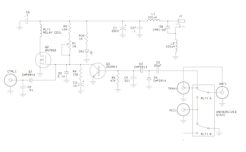

I wonder how the MFJ-1708 antenna Tx/Rx switch (and it's variants) would stand up to the same level of scrutiny, relays included.
Featuring prominently in these pages and with an application note on the SDRPlay site, no less!

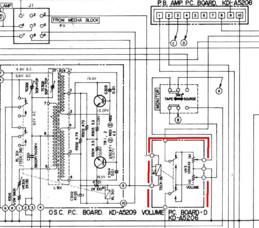

Years ago I purchased a new Akai reel to reel stereo tape deck. It had many features. One of them was auto-reversing. It enabled playback of a full tape, both sides without the need to remove the full reel flip it over and place on the right capstan, and rethread to the empty reel. To accomplish this a relay was used to reverse the audio channels due to the arrangement of the 4 channels on the tape. After several months of ownership the sound began dropping out at low audio levels when playing the reverse side of the tape. A major annoyance. I finally gave up and began playing the reverse side the old fashioned way as outlined above. When I returned to the US several months later I decided to try to fix this problem. It turns out it was due to dirty contacts on a relay that reversed the audio channels. I presume the audio levels switched by this relay was at line levels*, it may not have been. But let's assume it was. It was likely much higher than the RF voltages encountered at a receiver's input. This is the reason for my concerns about using a GP relay in this application.
Mike
https://www.kfs.oeaw.ac.at/manual/3.8/h ... de/461.htm* A line input level electrical signal typically has a voltage ranging from 0,3 to 2 Volts, while a microphone level signal is more often in the range from 5 to 50 mV (millivolts). Microphone sensitivities range from -60 dBu to -22 dBu referenced to 94 dB Soud Pressure Level (0 dB SPL = 2*10–5N/m2). The consumer line input level electrical signal typically has a voltage of 0,32 V (-7,8 dBu), whilst the professional line input level is typically 1,23 V (+4 dBu).
Mike

Your experience is very informative and clearly shows the risks and pitfalls in circuit design. Reliability analysis, based on MIL specs, was done in the company I was working for several years and the most difficult process was that of finding an optimum balance between component count and reliability. To make it simple: if in order to avert the danger of one hypothetical failure you increase the component count you may end up with a less reliable circuit anyway. So, according to my experience, to avert the danger of failure due to dry current, we are now increasing the component count by 5: two more capacitors, two more resistors and one choke and we are not even sure that the relay will fail, or, better, we do not know how long it will take for the relay to fail. This is a very good example of what I mean.
Furthermore, what problem do we have if the relay fails? Nobody is going to die, no battle in a war is going to be lost, so why increase the complexity and risk a failure in the long term because we increased the number of components? At the worst we shall just replace the relay, when and if it fails.
In its simplicity the case we are analysing proves the necessity of having an excellent circuit designer, because, at the very end of the story, it is his ability that can insure that precious, all important balance.
