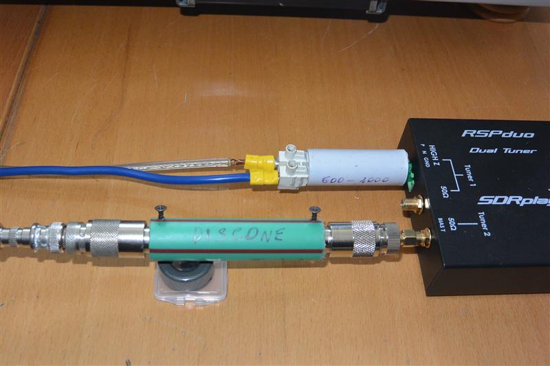

Hi Bas, there is a TOTAL MISUNDERSTANDING which I perceive from your questions!!! How could you think I would connect a 50 Ohm downlead to a HI Z 1 Kohm input with no matching?
Please look at the posted photos (even those posted before): I have always connected and tested the Discone antenna (50 Ohm) connected to the 50 Ohm coaxial input of the RSPduo using a 50 to 50 Ohm (1:1) toroid transformer. Up to now I have NEVER connected the 50 Ohm Discone coaxial output cable to the balanced HI Z 1 KOhm input of the RSPduo. I will try this connection later on.
In all the tests I have used the 135 m Beverage antenna connected to the balanced HI Z input and the Discone antenna to the 50 Ohm coaxial input.

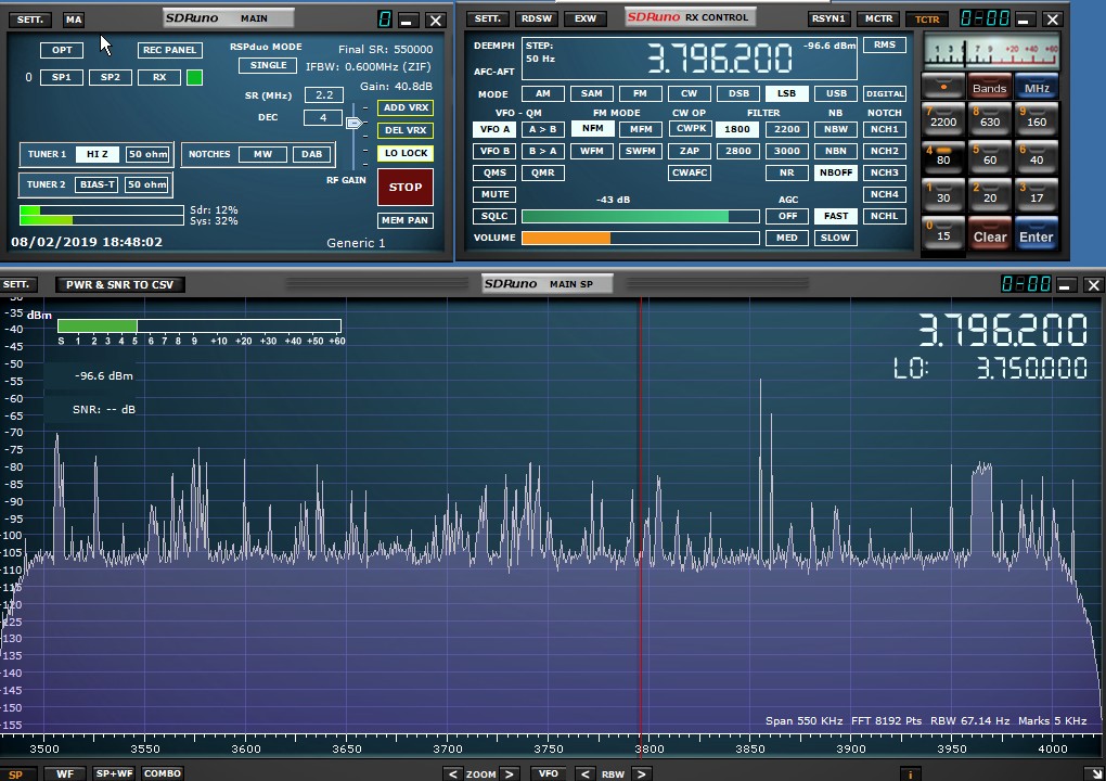

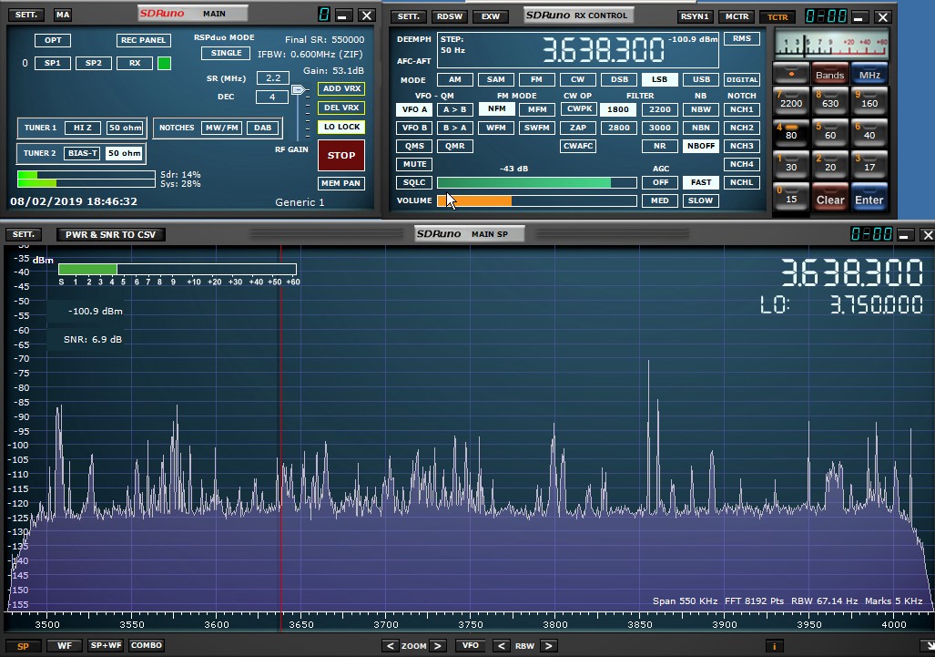

I take this opportunity to upload PC screens of Discone & Beverage @ 3.6 MHz
THIS IS THE DISCONE ANTENNA UNDER TEST
Discone with Xfrmr @ 3.6 MHz.jpg (198.1 KiB) Viewed 44053 times
THIS IS THE BEVERAGE FOR COMPARISON
Beverage @ 3.6 MHz.jpg (197.89 KiB) Viewed 44053 times
Antenna connections to the RSPduo
RSP inputs.JPG (144.39 KiB) Viewed 44053 times

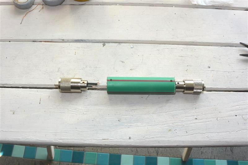

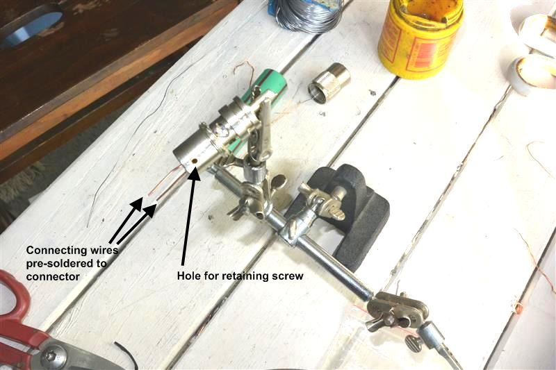

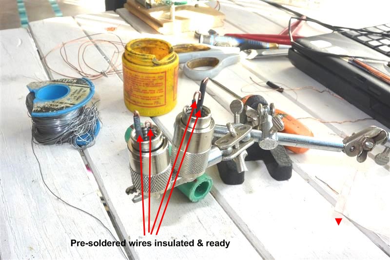

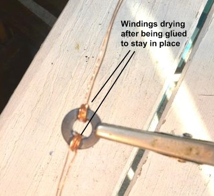

BUILDING A STABLE 1:1 LOW CAPACITANCE TRANSFORMER - 1
The low capacitance transformer needs a stable configuration. I decided to build a suitable housing which keeps input & output common terminals insulated from each other. Here below the building sequence. I used a thick walled PVC pipe.
1. Gluing the windings.JPG (83.38 KiB) Viewed 44028 times
2. Preparing the connectors.JPG (128.15 KiB) Viewed 44028 times
3. Connectors ready for assembly.JPG (143.82 KiB) Viewed 44028 times
Posts: 662
Location: Piedmont, Italy
Re: Extending the range of a Discone antenna down to 3.6 MHz
Post by glovisol » Sat Feb 09, 2019 12:04 pm
BUILDING A STABLE 1:1 LOW CAPACITANCE TRANSFORMER - 2
I have provided a proper housing for the 50-to-50 Ohm low capacitance transformer and for the 550-to-1 Kohm low capacitance transformer as well.

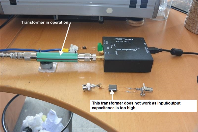

4. Transformer being assembled.JPG (75.59 KiB) Viewed 44018 times
5. Transformer in operation.JPG (127.93 KiB) Viewed 44018 times
6. RSPduo equipped with HI Z & 50 Ohm XFRMRS.JPG (76.14 KiB) Viewed 44018 times

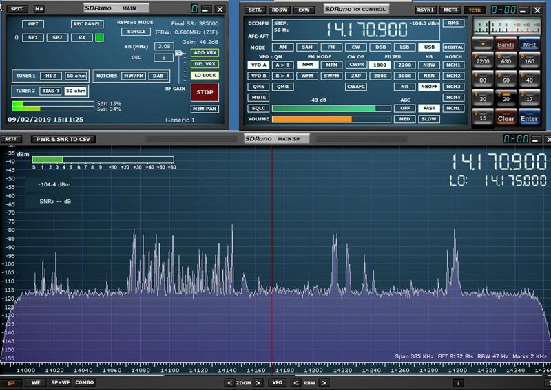

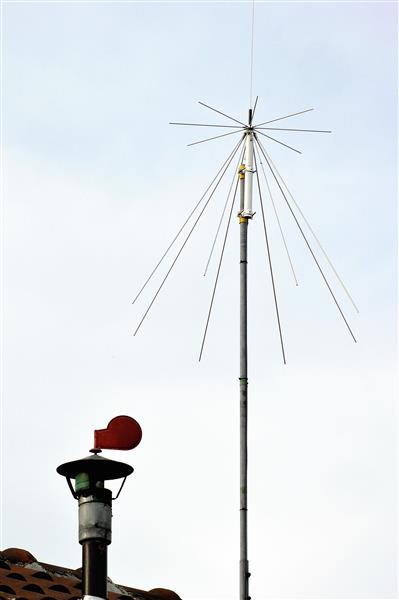

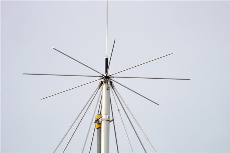

The 20 m band really opened up today, to make me appreciate my new Discone antenna!
Hi JMG, could it be the trapped whip on top to work so well?
Discone total.JPG (39.01 KiB) Viewed 44008 times
Discone closeup.JPG (44.73 KiB) Viewed 44008 times
14 MHz propagation really opened up today for my Discone!.jpg (88.03 KiB) Viewed 44012 times
ON5HB
Posts: 140
Post by ON5HB » Sun Feb 10, 2019 1:41 pm
I found this bit of information and they state:
Additional vertical element on discone
Often discones will be seen with an additional vertical element attached to the top of the antenna. This is often the case when they are used as a scanner antenna.
This additional vertical element on the discone helps to extend the lower frequency response for the overall antenna, giving improved performance at lower frequencies.
The downside to the addition of the vertical element is that it can reduce the efficiency at higher frequencies.
Here is the link: https://www.electronics-notes.com/artic ... basics.php
