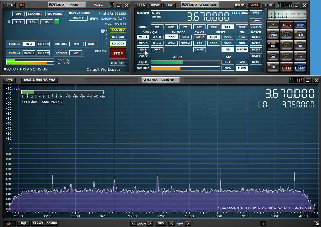

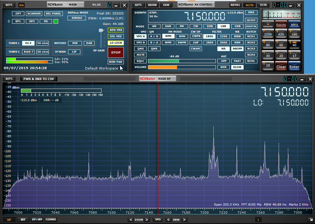

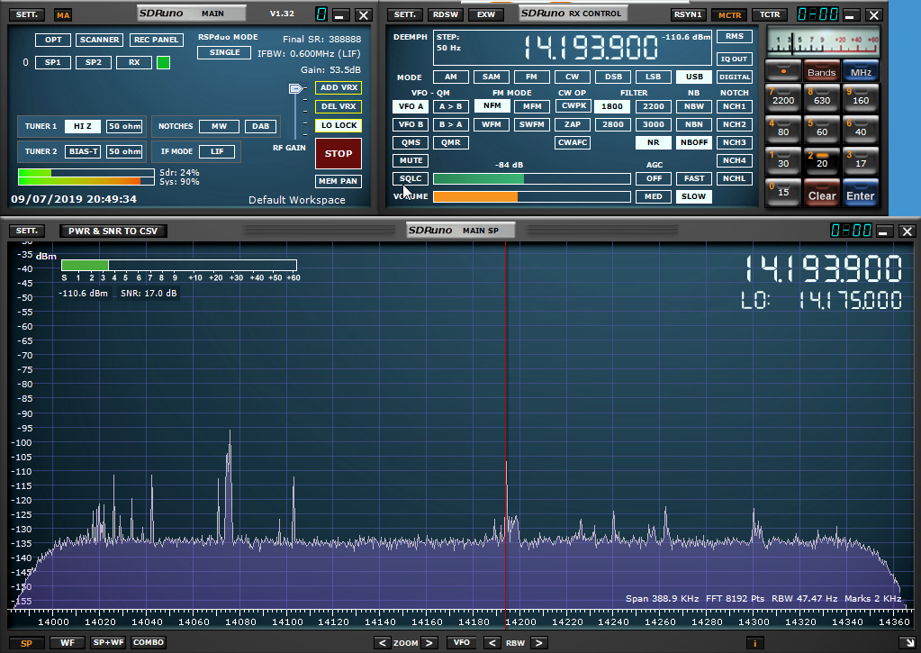

Re: LW-MW-SW Relay Tuned 15' Noise Reducing Vertical Antenna
Hi Phil,
I AM SIMPLY AMAZED!!
I have been following your exchange with Sdrom33 on loop antennas and I was (I must confess) a little skeptical and suspicious of your stories about miracles of loop antennas, so, in want of anything better to do, being at the sea side in Sardinia, in a flat at the 3rd storey, with sultry, rainy and very hot weather and with an RSPduo and no antenna on my hands, I decided to take you to task.
I went downstairs, stole a wooden pallet from an abandoned pile in a corner, removed two planks, made a cross, stuck 4 screws at the cross tips, put in a piece of elecrical cable all around and let the thing be, as it was mid afternoon. Half an hour ago (19:45 local time) I tie the cross on the small balcony (see pic. below) connect it to the HI Z input of the duo tru the usual ferrite low noise transformer and turn SDRuno ON.
This is simply unbelivable!! Full band at 40 and at 20 m: radio hams coming in as if it was raining RF. I am now planning to make a second "antenna" & run Diversity. Noise level is also impressive. Why should we all be in quest for other small antennas seems very difficult to believe, at this stage, dr Lankford permitting.
Will report more poor man's adventures in the next few days. The problem is....my wife will not allow me to drill a hole thru the window frame yet again at the sea side flat too.
A little later...
Now, if a loop 0.81 square meters can give me this result, it is mind boggling to imagine what I will get with the 50 m side square loop (i.e. 2500 square meters I can set up in August, when I get back home.
The important point is, we are on a solid rock foundation of theory here, not some kind of make believe black magic.
- 3.6 MHz a little later.png (314.25 KiB) Viewed 81213 times
- 7 MHz a little later....png (322.08 KiB) Viewed 81214 times
