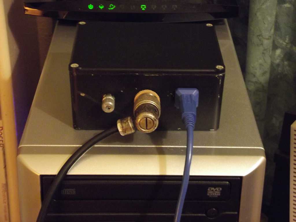

I decided to put the SDR into a die cast aluminium box, fitted with a proper Earth terminal, and an SO 239 socket.
When that's done, I'll make a nice wooden box to finish it off so it looks like a decent radio.
It's a work in progress, but coming along OK. The tricky bit is the SMA pigtail. It's so fragile it must have been installed by someone with fairy fingers. So it's interesting to see TechSupport say there are pigtals available with various connectors - where would I look for one with an SO 239 on the end

OK, it's gone into the die cast aluminium box - now you can drop it on the floor, kick it, hit it with a hammer or swing it by it's cables and all will be well.
All I have to do now is put another splash of paint on the box, and do a bit of woodwork to make a nice case for it.
I'll have to wait 'til the weather improves for that though - at the moment it's freezing out there, and there's no decent light to work by

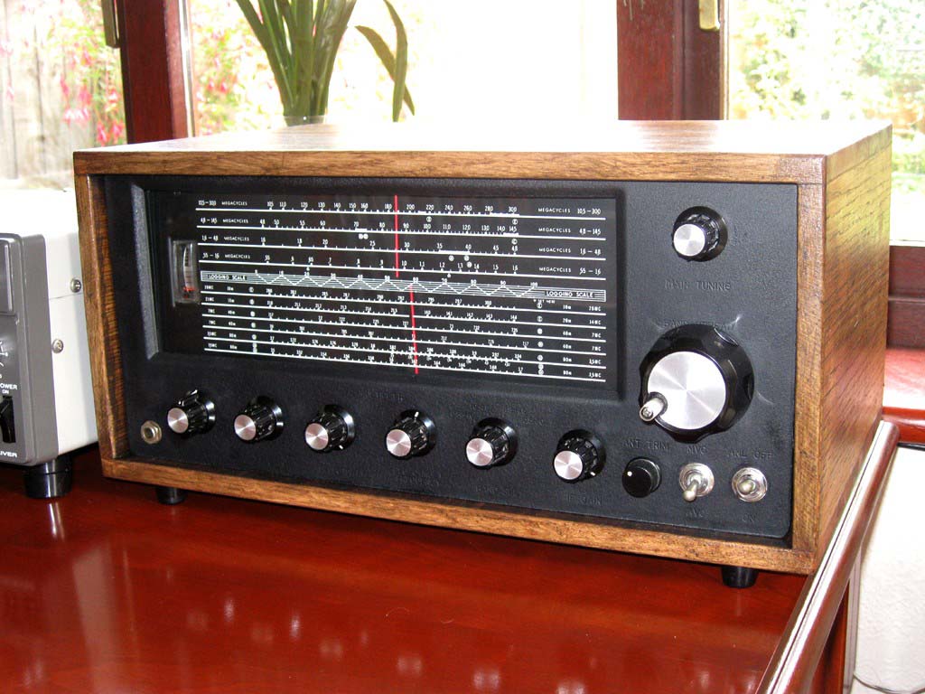

I like nice woody cases for kit - makes it feel more homely
Attached is one I made for an old Trio 9R59 radio.
I sold it a while back at a Manchester radio rally ..
I plugged the boxed version in, and it's working well with the PL259 aerial plug. That's good enough for me .. attached is a picture showing the aerial connector, earth terminal and the USB connection ..

I forgot to include the picture of the Trio 9R59 which I put in a wooden case - made it look much nicer than a tin box I thought ..
Competition from 50 years ago
