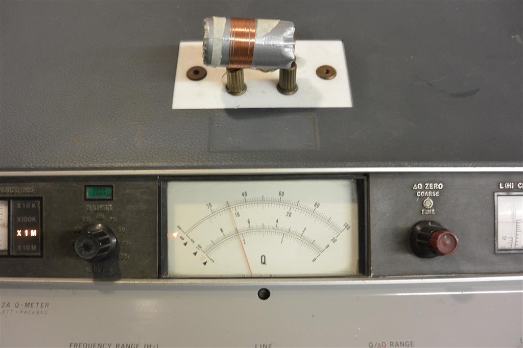

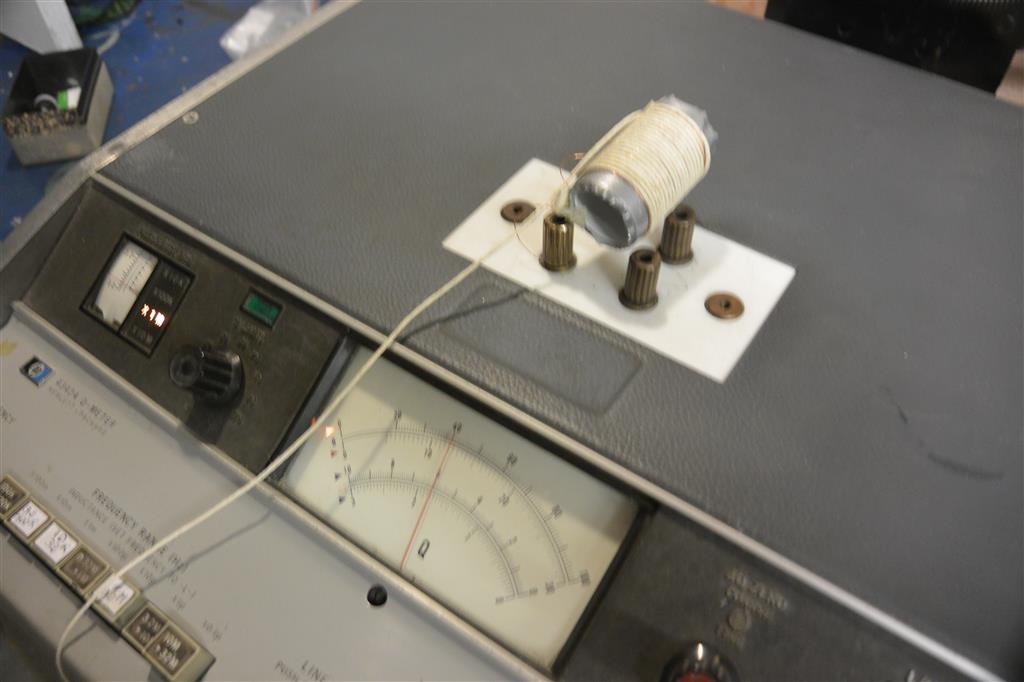

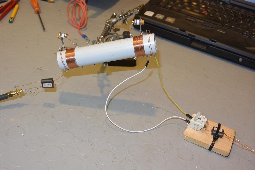

Phil,
I prepared a former with dia. 27 mm by winding cloth tape over my standard 25 mm PVC form. Measurement results are as follows.
7.1 MHz - 27 turns - L = 20.8 uH - Qu = 350*0.8 = 280 (calculated was 204).
10.1 MHz - 21 turns - L = 12.6 uH - Qu = 300 * 0.8 = 240 (calculated was 209).
14.1 MHz - 15 turns - L = 12 uH. Qu measurement cannot be done because the coil requires less tha 12 pF to resonate @ 14.1 MHz and the minimum tuning capacitamce of the Q meter is 12 pF. In any case, in my opinion, for building a pre-selector the value of 12 uH @ 14.1 MHz is too high, because, if the tuned circuit resonates with less than 10 PF in parallel, the coupling capacitance will be too low and difficult to control.
Please also consider that Qu increases significantly by SPACING the turns. This is easily achieved by winding meat roast twine (dia. 0.65 mm) along with the copper wire (an old German trick of WW II). As an example, 21 turns spaced give an inductance of 6 uH and deliver a Qu > 400 @ 10.1 MHz. See the pictures below.
If you are interested in building spaced coils, I can provide the calculations & predicted Qu for all of them.
Gianfranco
Gianfranco
- 7.1 MHz close wound coil under test on the Q Meter.
- Qu measure 1.JPG (89.28 KiB) Viewed 34919 times
- 10.1 MHZ space wound coil under test.
- Qu measure 2.JPG (86.38 KiB) Viewed 34919 times

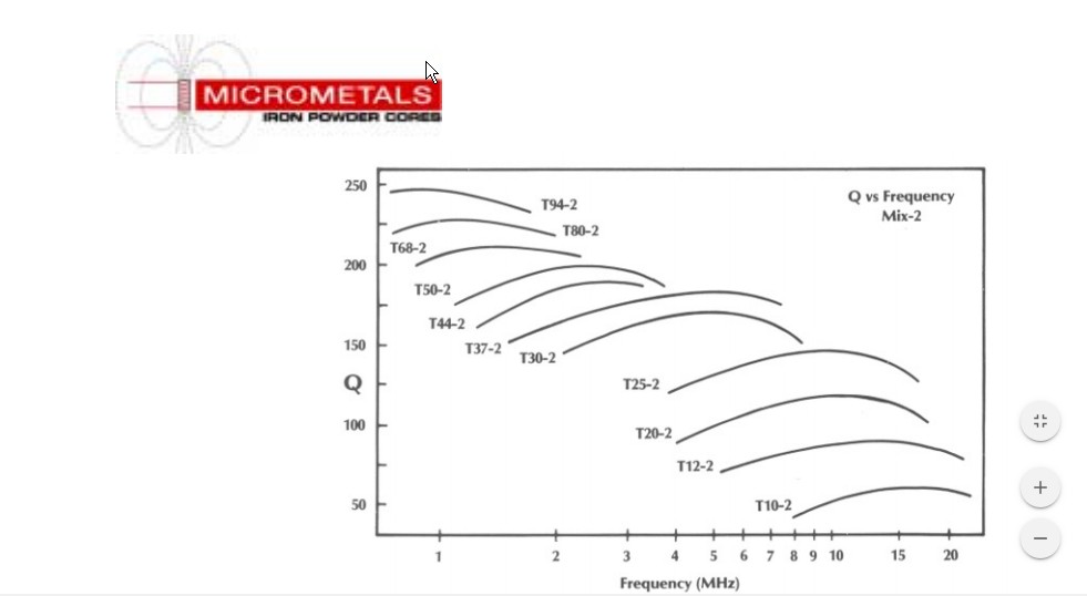

Hi Phil,
Glad to be of help. Do not worry, I am glad when I am working in the lab.
Iron powder toroids are not suitable for high Qu applications. They provide (fantastic for their size!) Qu's of 250 max. in the low HF and 150 max. in the High HF. If you are really good, you can squeeze a maximum of Qu=170 @ 7 MHz. Toroids are good for building multiple section filters (the "more stuff" approach) with steep shoulders, but with relatively large & flat band-pass, the contrary of what you are looking for. See pic. below. For more data look here, this is the best info, to date.
https://52ebad10ee97eea25d5e-d7d4081925 ... res_TN.pdf

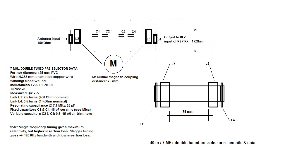

So back to high Qu air core coils.....perhaps what is shown below could be of interest. It is the first double tuned section of the N=4 Chebyshev pre-selector I am developing. If you undercouple, narrowband selectivity will go further up, with more loss, of course. Details in next post as the wife is hollering I must go for shopping....
- IRON POWDER Q's.jpg (38.91 KiB) Viewed 34855 times
- Double Tuned 2.jpg (196.37 KiB) Viewed 34855 times
- Double tuned.JPG (92.39 KiB) Viewed 34855 times

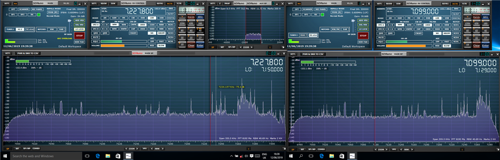

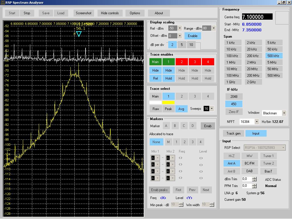

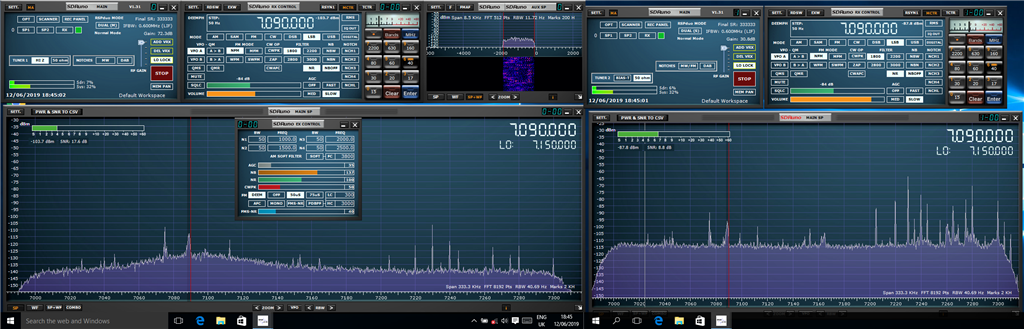

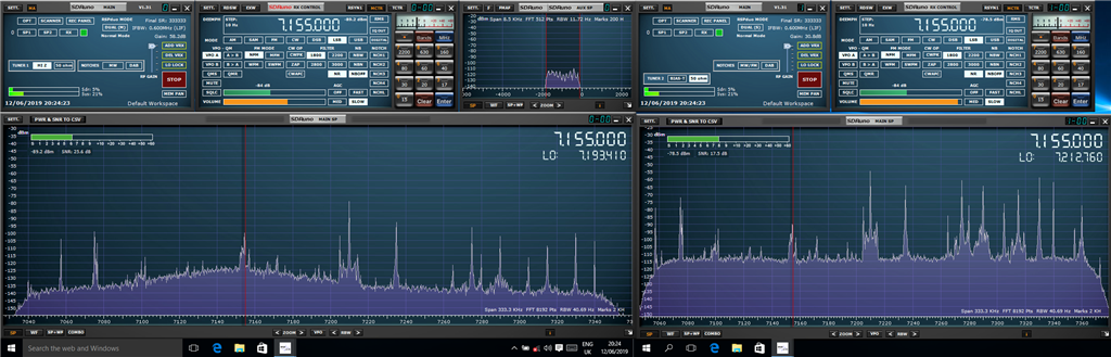

Hi Phil,
Today I have done fantastic progress, just look at these three screens....The light will come to you when you look at the noise ratios. It is the RSPduo reading the same antenna at the same time with the two different tuners. The main tuner thru the double tuned pre-selector, the slave tuner straight thru. Even with the 6/8 dB loss in the pre-selector the S/N is consistently higher in very many photos taken at random, of which these two are just specimens. Not only all man made residual noise coupled from the antenna is gone, but the strong broadcasters are gone as well.
I think I have also solved the problem of the tuneable pre-selector, I hope to your satisfaction, but I need two/three days to uveil this eye opener.
Cheers,
Gianfranco
Cheers,
Gianfranco

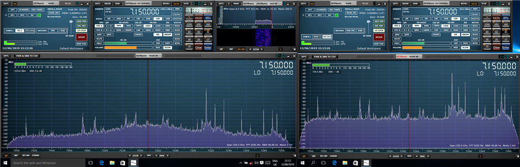

- This shows antenna input balance in both tuners
- Level Compare.png (475.88 KiB) Viewed 34819 times
- Here is S/N, LEFT 17.6 - RIGHT 8.8 dB
- Screenshot (20).png (504.55 KiB) Viewed 34819 times
- Here is S/N, LEFT 26.5 - RIGHT 17.5 dB
- Screenshot (28).png (484.41 KiB) Viewed 34819 times
Typical situation: On left you copy with no trouble, on right you hear NOTHING in the garbage!
- S/N: LEFT 9.6 dB - RIGHT: 0 dB
- Typical situation (Large).png (480.88 KiB) Viewed 34816 times
Well done Gianfranco! Isn't that good, I can see where you are heading with the Duo, the Duo is really well suited to the idea you first mentioned you were working on.
You've had quite a few hours now since you got this setup going, I wonder if you've found it as useful as you hoped as the propagation varied?
I'm not happy with my trimmers either, will source something better. Also one of my Linux laptops developed the annoying habit of wiping out it's boot blocks and stuffed two consecutive days of WSPR spots on 40m despite quick fixes so today I wiped it clean and installed Mint instead of Xubutu hoping for a change in behaviour, it's a shame because it had been stable for months before the problems suddenly appeared.
Good luck with your progress towards your eye-opener.
Regards Phil
Regards Phil

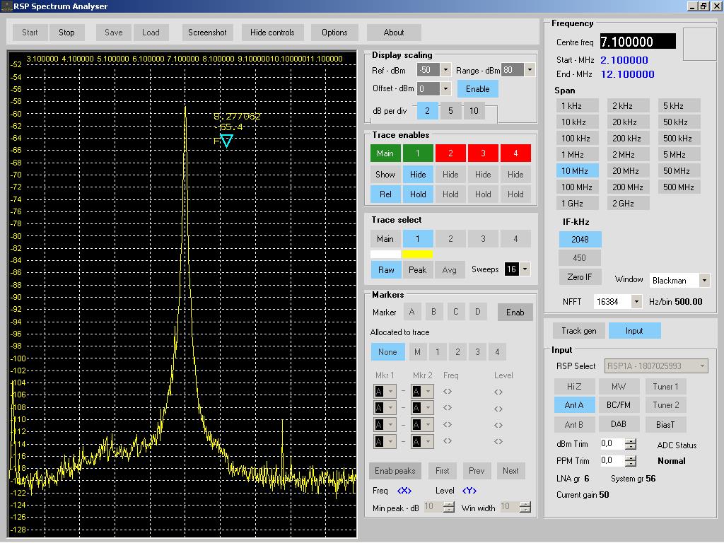

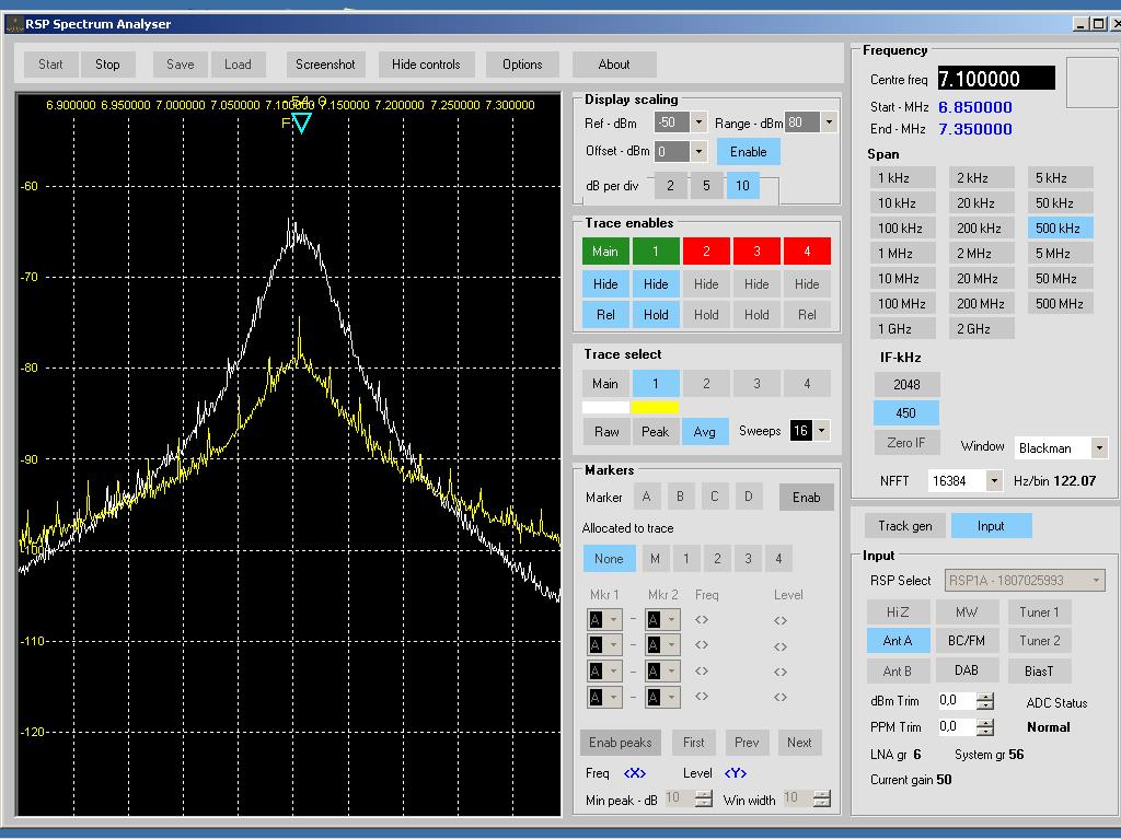

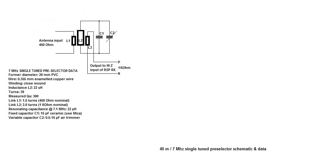

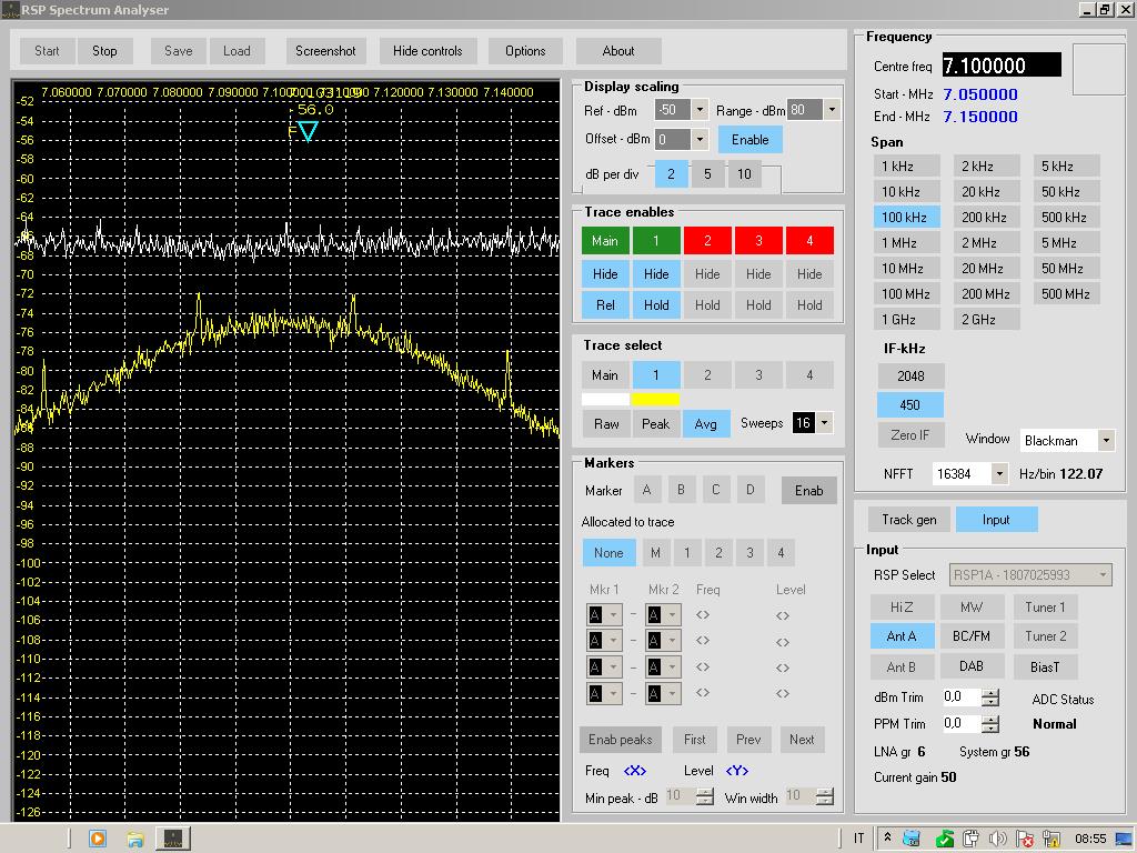

RECAP OF PRE-SELECTOR WORK DONE UP TO NOW
Interesting results have been obtained from the pre-selector work, data for the single tuned and the double tuned prototypes are uploaded below. The only unsolved problem regards the insertion loss of the double tuned unit: the insertion loss as measured on the Spectrum Analyser is in the order of 8 dB, while when connected to the RSP the insertion loss appears to be over 15 dB. This difference will be investigated. In any case tests have shown that an antenna pre-selector is extremely useful in crowded frequency bands, surrounded by extremely powerful broadcast signals which tend to de-sensitise the RSP through different mechanisms:
a) Overload the system, as shown by the ADC OVERLOAD ALARM.
b) Compel the operator to reduce RF gain, thus increasing noise generated by the IF amplification.
c) Sometimes cause the generation of second order or third order products which interfere with weak wanted signals.
d) Take control of the AGC attenuating the system gain to the detriment of weaker wanted signals.
The pre-selector not only attenuates unwanted near band extra strong broadcast signals (for example in 40 m from 7.2 MHz up) but also strong interference far away in frequency, thereby helping the already very effective action of the RSP fixed input filters.
The RSPduo is an invaluable instrument in assessing the efficiency of the pre-selectors under examination, because it provides an instantaneous, real time comparison between the protected (by pre-selector) and the unprotected tuner. In fact one can use the main tuner as the "receiver" and the slave tuner as "panadaptor".
- Antenna single tuned Pre-selector 7 MHz .jpg (55.38 KiB) Viewed 34765 times
- Antenna double tuned Pre-selector 7 MHz.jpg (94.87 KiB) Viewed 34765 times
- Single tuned & double tuned frequency responses compared.
- Double tuned compare 14.jpg (144.43 KiB) Viewed 34765 times

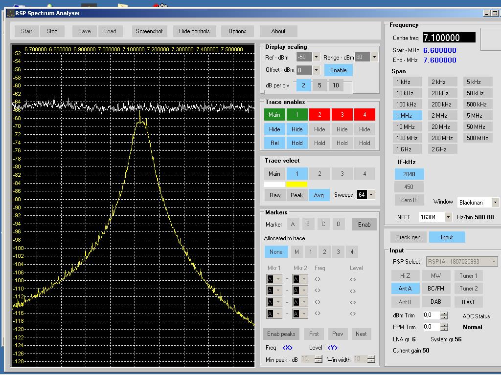

MORE FREQUENCY RESPONSES FOR THE DOUBLE TUNED PRE-SELECTOR
Markers are at 25 KHz, when shown.
- Double tuned pre-selector pass band
- Double tuned 6.jpg (189.12 KiB) Viewed 34762 times
- Double tuned pre-selector insertion loss & stopband
- Double tuned 7.jpg (191.35 KiB) Viewed 34762 times
- Double tuned pre-selector ultimate attenuation
- Double tuned 9.jpg (189.03 KiB) Viewed 34762 times
