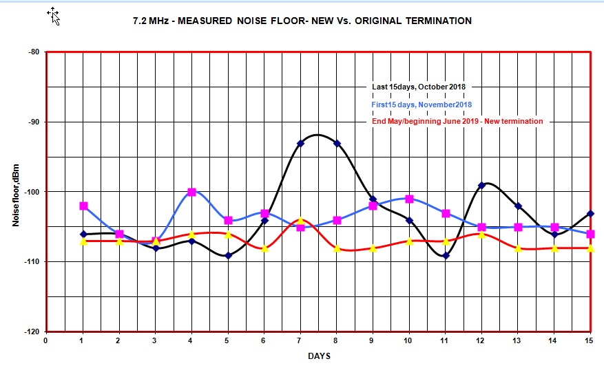

NEW Vs. ORIGINAL ANTENNA TERMINATION - COMPARATIVE RESULTS, 7.2 MHz
Hi sdrom33, "convert" means converting the raw measured noise data on the power meter of the RSP receiver into the standard ITU value, to classify the noise level in one of the ITU categories, as explained in my thread "assessing the performance of the RSP receiver system in HF":
https://www.sdrplay.com/community/viewt ... f=5&t=3685
But even if you are lazy, the comparative data presented in the graphs shows the advantage obtained by modifying the antenna terminations. Even if in some points past levels seem better on a spot, the improvement on average noise level is quite noticeable. Please understand, as already explained, that the noise advantage becomes bigger when man made noise is effectively present and man made noise level tends to decrease with increasing frequency, so the best advantage was obtained in the lower HF. In the graph below, ignoring the big variations of October 2018, the advantage obtained in June 2019 over November 218 on 40 m is immediately apparent .
- Noise floor compare 7.2.jpg (86.02 KiB) Viewed 67969 times

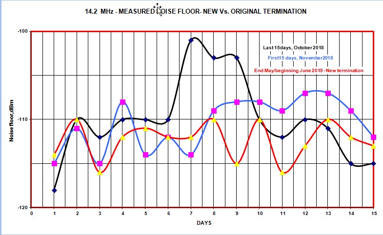

NEW Vs. ORIGINAL ANTENNA TERMINATION - COMPARATIVE RESULTS,14.2 MHz
- Noise floor compare 14.2 MHz.jpg (81.25 KiB) Viewed 67893 times
