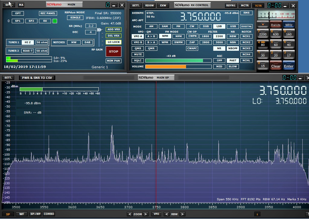

NO WHIP / WHIP DISCONE ANTENNA TESTS - 1

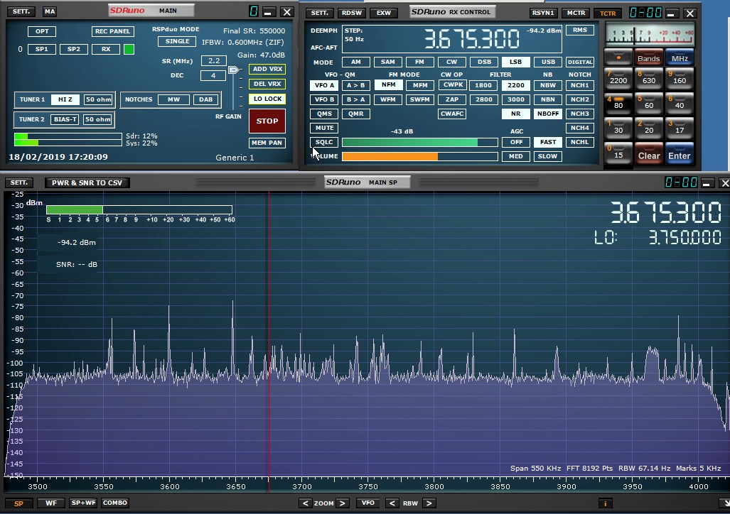

Antenna test was done as follows.
1) Tests were done between 17:00 and 17:30 local time or 16:00 to 16:30 GMT. This hour was chosen as propagation on 3.6 MHz is already good and there are plenty of signals on air. Time was restricted to 17:30, as later it becomes too cold and visibility deteriorates.
2) There was a friend on the roof who would remove / replace the whip on command.
3) Antenna was equipped with (a) one RF "bottle choke" just inside the roof, e.g. 2 m from the antenna UHF connector. (b) One RF choke done with 4 turns of the downlead coaxial cable wound on a ferrite arrester toroid. (c) The isolation, low noise transformer already described, connecting the lead-in to the Tuner 2 coaxial input of the RSPduo receiver.
4) Comparative testing between Beverage and Discone was done by switching between the Hi Z input (Beverage) of Tuner 1 and 50 Ohm input of Tuner 2 (Discone).
Here below and in following posts the resulting PC screens.
- 1. Discone no whip 17_10.jpg (188.6 KiB) Viewed 40337 times
- 2. Beverage 17_10.jpg (191.23 KiB) Viewed 40337 times

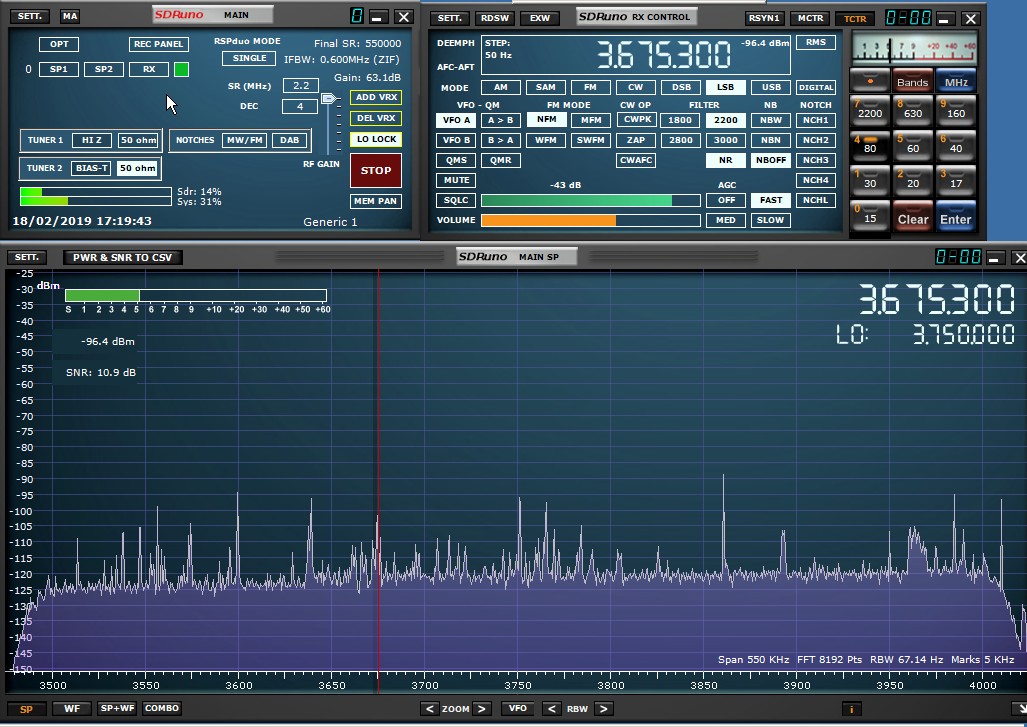

Re: Extending the range of a Discone antenna down to 3.6 MHz

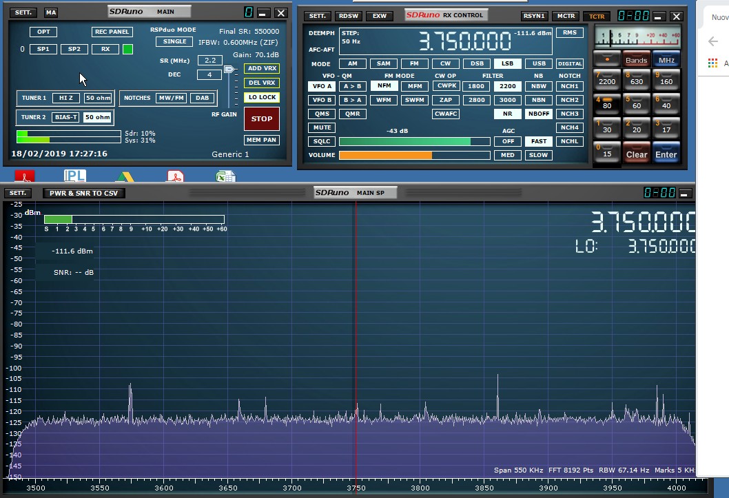

NO WHIP / WHIP DISCONE ANTENNA TESTS - 2
- 3. Discone whip 17_22.jpg (194.77 KiB) Viewed 40335 times
- 4. Beverage 17 22.jpg (193.53 KiB) Viewed 40335 times

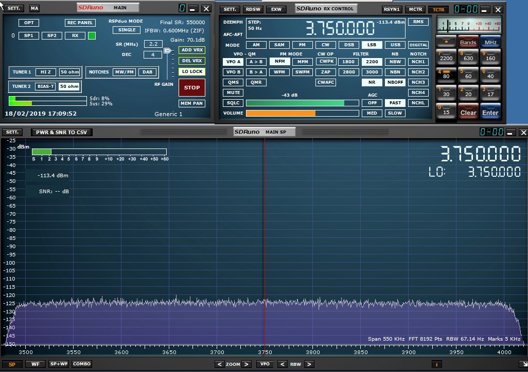

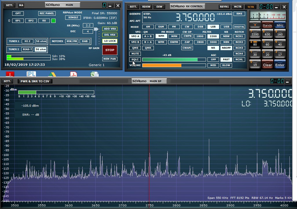

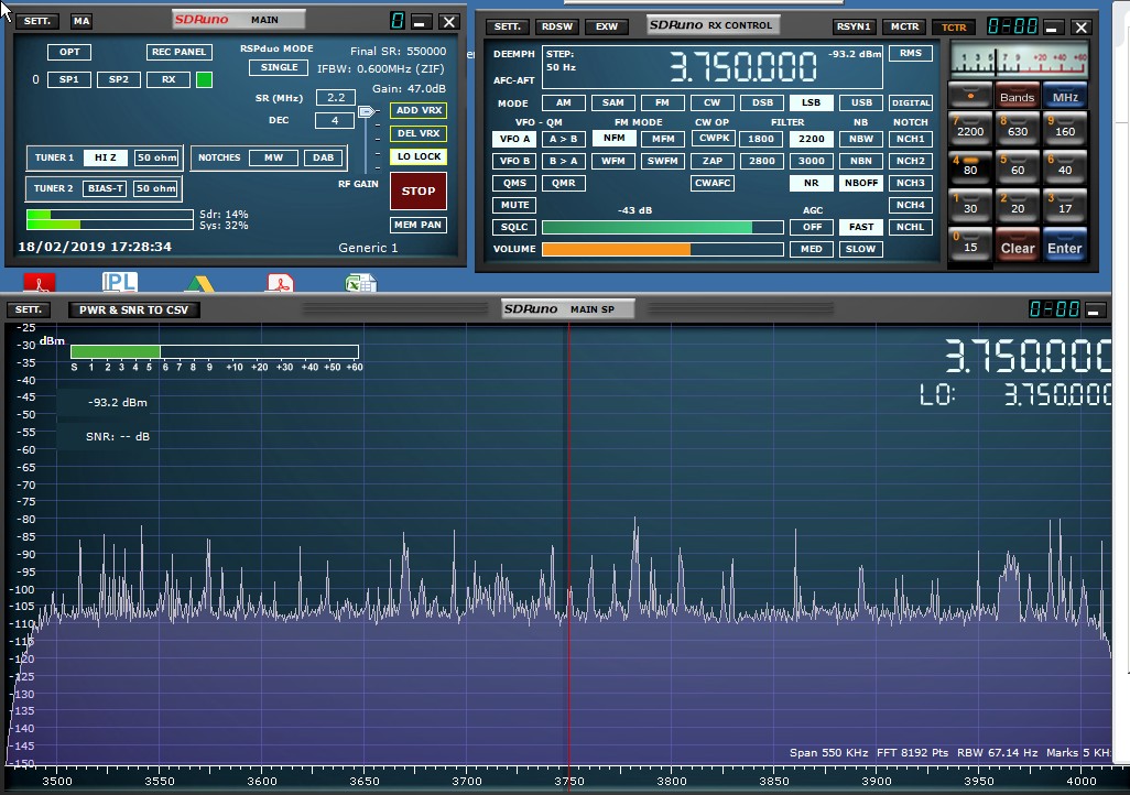

NO WHIP / WHIP DISCONE ANTENNA TESTS - 3
- 5. Discone no whip_17_30.jpg (192.66 KiB) Viewed 40333 times
- 6. Discone whip 17 30.jpg (197.52 KiB) Viewed 40333 times
- 7. Beverage 17 30.jpg (197.67 KiB) Viewed 40333 times
What are we seeing?
As when I reply there are more pictures then we see in reading your post.
Anyway, your filenames make sense, so I could figure it out.
As I said, the whip lowers the reception range.
Without it 80m is gone, so the chokes work else it wouldn't make any difference and the coax would have done reception.
But the discone is vertical, so a direct comparisment is not real valid, some signals are better vertical others better horizontal.
Real test would be DX signals as those tend to be non/less-polarised as short-distance.
To be honest, I do find all levels rather low, as my Icom7300 and my websdr have far stronger signals.
Are you sure the beverage is working properly? Noise levels here are easily S7-9 at those times, nowhere near as low as yours.
Come on, Bas, I did the measurements on purpose at this time of the day because signals at this frequency are there, but not as strong as they normally are later in the evening. If I chose a full strength propagation time, then I could have had signals coming in from every pore, ruining my measurement.
The comparison with the Beverage is NOT IMPORTANT per se, it just tells us that SIGNALS ARE PRESENT and therefore the test on the Discone antenna is valid.

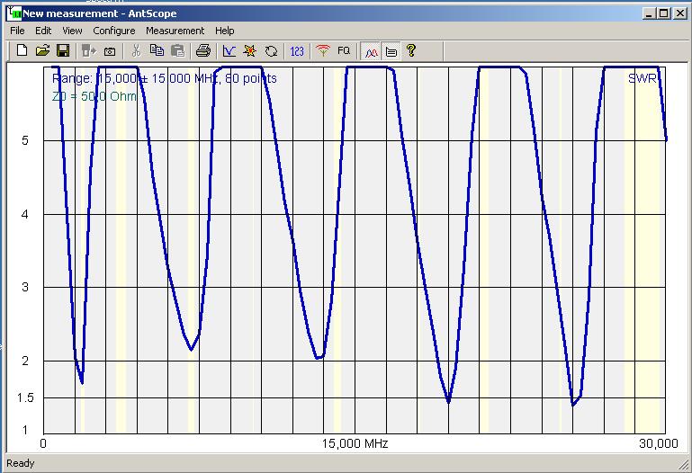

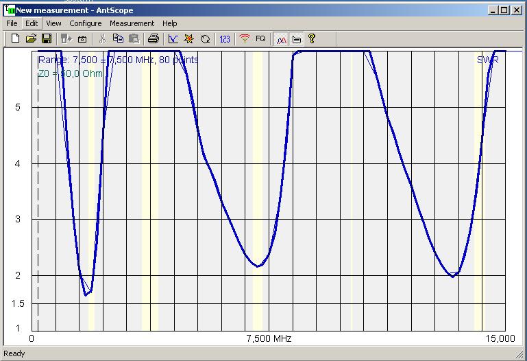

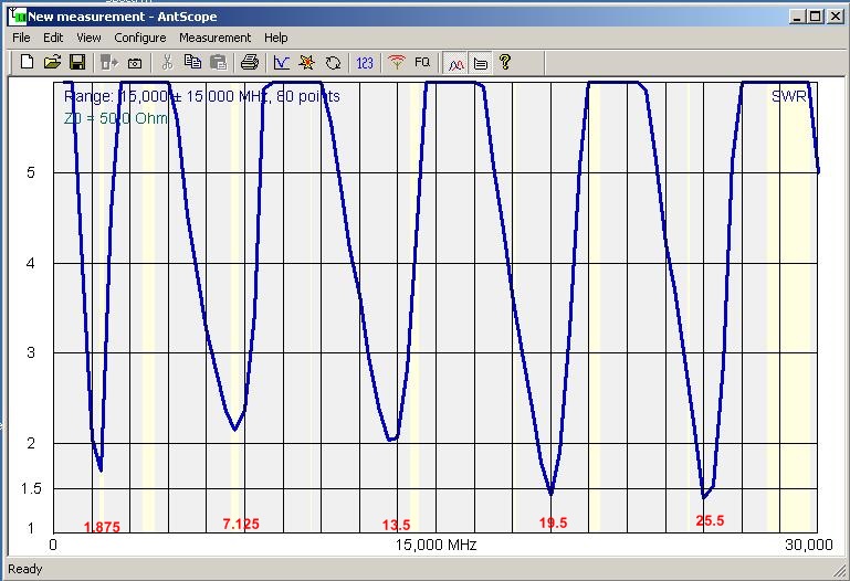

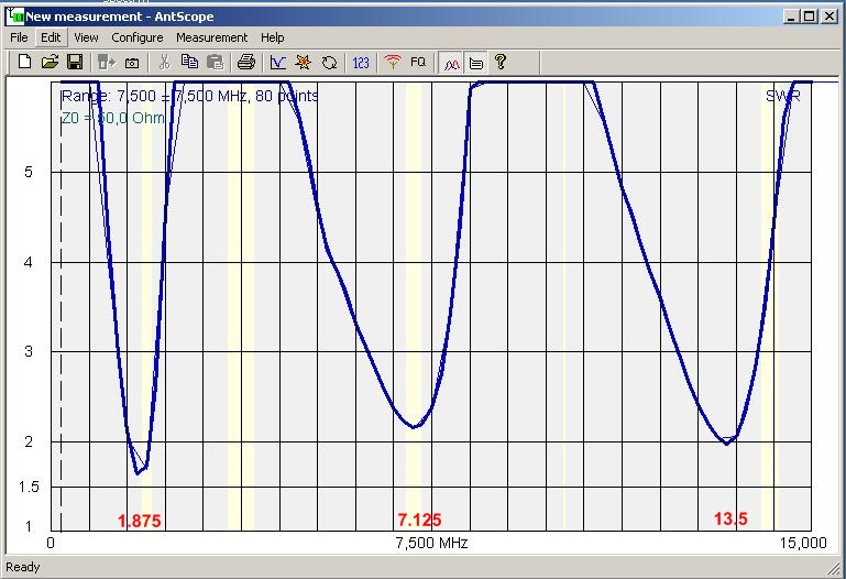

DISCONE ANTENNA SWR PLOTS
Antenna plots with vertical whip mounted above the Discone. Network Analyser connected to the antenna coaxial output to the RSP. Comments invited.
- Discone plot 4.jpg (68.7 KiB) Viewed 40275 times
- Discone plot 3.jpg (73.51 KiB) Viewed 40275 times
DISCONE ANTENNA SWR PLOTS with SWR NULL FREQUENCIES
- Discone plot 3.jpg (116.16 KiB) Viewed 40254 times
- Discone plot 4.jpg (107.2 KiB) Viewed 40254 times
