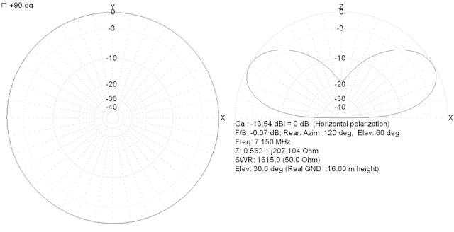

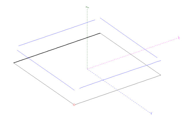

Hi Gianfranco,
You asked me to model your pallet, here it is over real ground at a height of 16m:
Overview showing current flow (the blue lines) is equal in all four sides
Feedpoint is the red dot. The pattern is omni with useful lowish angle lobes that are giving you all that nice activity 40m (7.15MHz) antenna characteristics Forgive my screen pic dump quality; the Mac 4K screen dumps at 144dpi resolution and those images get resampled to presumably 72dpi and become annoyingly unsharp.
Thanks for the kind comments from you and sdrom33 but the truth is VK7JJ is just another flawed wannabe standing on the shoulders of giants like Cebik, waving a little flag and pointing to things he's borrowed from them; much better to go straight to the giants themselves.

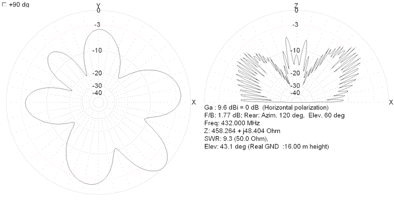

Re: LW-MW-SW Relay Tuned 15' Noise Reducing Vertical Antenna

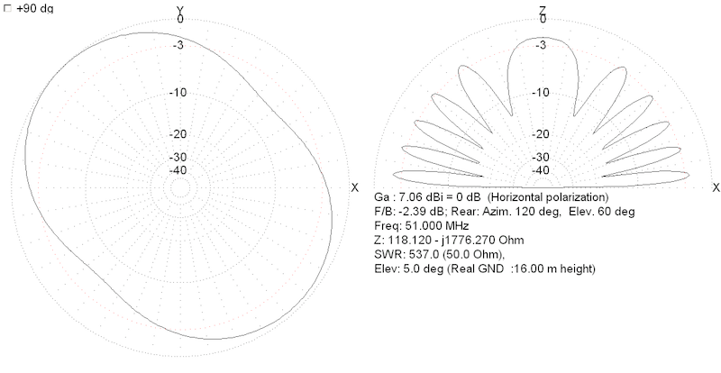

Here it is again at 6m (51MHz) and UHF (432MHz) to show how a loop is good for wide band work.
You'll note the gain, something you will not get from a vertical whip or groundplane, along with the improved radiation resistance and reactance.
The angle of radiation is actually better than a vertical, vertical patterns break up into even higher angle lobes as you go up in frequency. The old ham chat about a kite with a kilometre long wire being the ultimate HF antenna - maybe so if it was caught in a tree about one kilometre away.
Phil

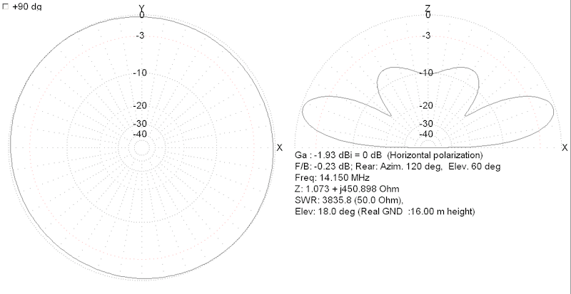

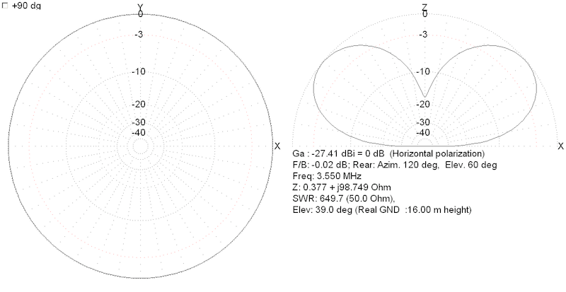

The modelling only takes a few moments, glad to help, here is 80 and 20m
If you can find some zip cord or make a simple twisted pair feed from antenna wire or better still find some old TV ribbon, before you get the ferrites, it would be a waste to try to fine tune the ferrite with the coax feed. It looks like coax.

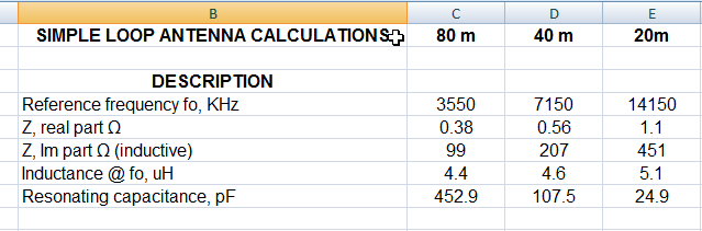

Hi Gianfranco, fine on your twin wire, thank you for putting me out of my misery. But then you put me right back into a worse state of misery showing that photo of you in the water during our mid winter! Totally callous.
Fine on your matching considerations and hopefully your ferrites will meet expectations, that would be really good. I wonder if you have any other antenna available where you are or if you put the pallet to use because you had no other? A comparison with a known antenna would be interesting.

Looking at the equivalent circuit of a small single turn loop, we see that it is represented by a resistor of a very low, sub-Ohm value, in series with an inductor. If we consider an useful frequency band extending from 3 to 15 MHz, we see that the median values are R=0.56 Ohm and L=4.6 uH and that the spread is relatively small. It must be noted here that I calculated the loop inductance with another independent formula (*) and I found the same value as given by Phil.
Now my idea is very simple:
a) if I take a simple Butterworth or Chebyshev prototype, say N=5 and
b) de-normalize it @ 15 MHz (or any frequency above the reception range I want from my loop) and
c) also de-normalize between 0.56 Ohm input and a convenient higher output impedance and
d) if the first series inductor has a calculated value higher than the antenna inductance,
THEN
e) I can incorporate the loop inductance into the value of the first network inductor and
f) Obtain perfect wideband match between 3 and 15 MHz without resonating the loop.
I shall now test the idea by calculation and if there is a significant number of simple networks that fulfill the conditions described above, I shall show them next.
(*) Inductance L = 0.008 * s * ln(s/l + 0.37942 + (0.333 * l/s)) = 4.29569 uH
