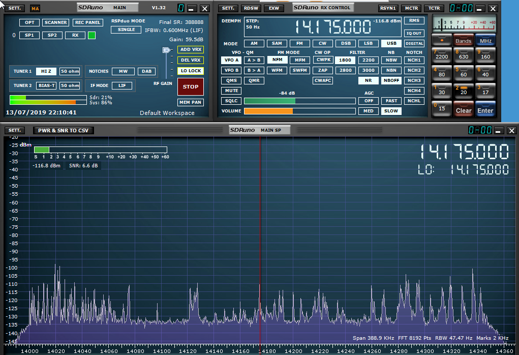

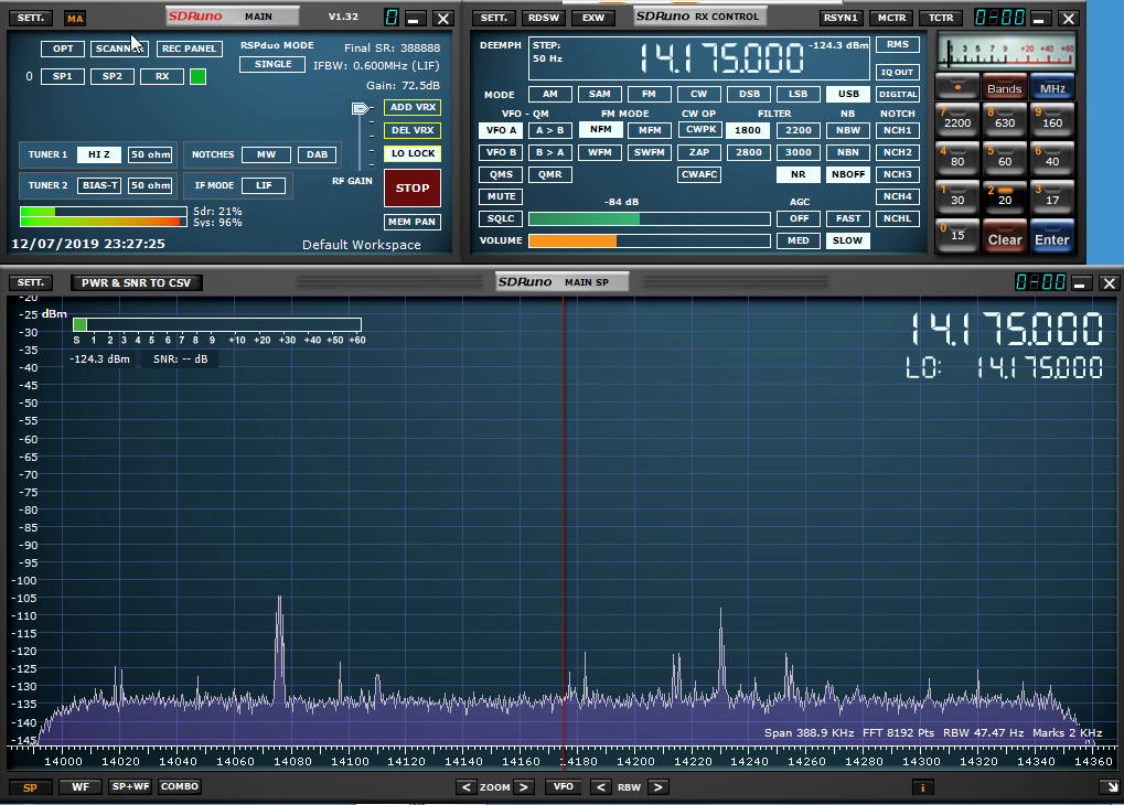

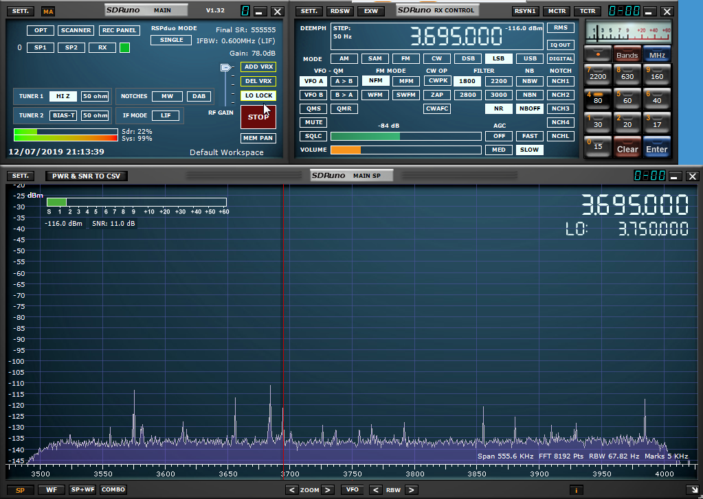

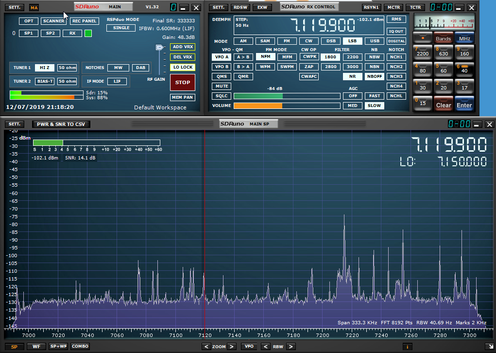

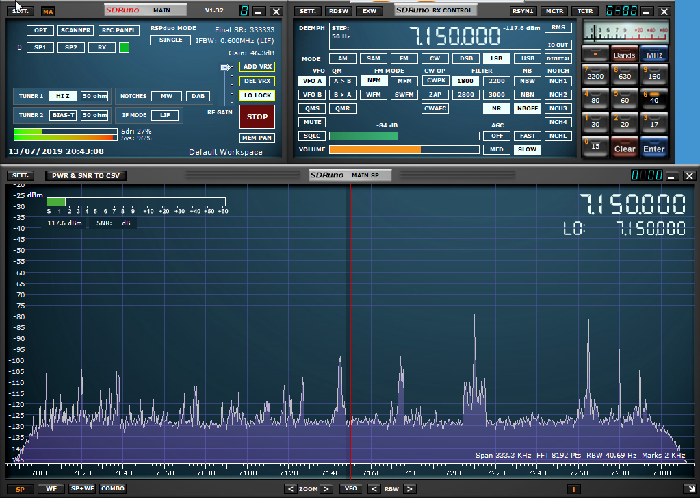

More reception examples with non-optimized original cross pallet loop antenna.
The peculiar thing, that comes to attention at once, is the low level of backgrund noise: under these conditions, signals at levels of -115 to -120 dBm are easily copied witout problems, even if the S meter shows S1 to S3.
- 1. Loop 3.6 MHz.png (313.49 KiB) Viewed 100914 times
- 2. Loop 7.15 MHz.png (321.14 KiB) Viewed 100914 times
- 3. Loop 14 Mhz.png (319.37 KiB) Viewed 100914 times

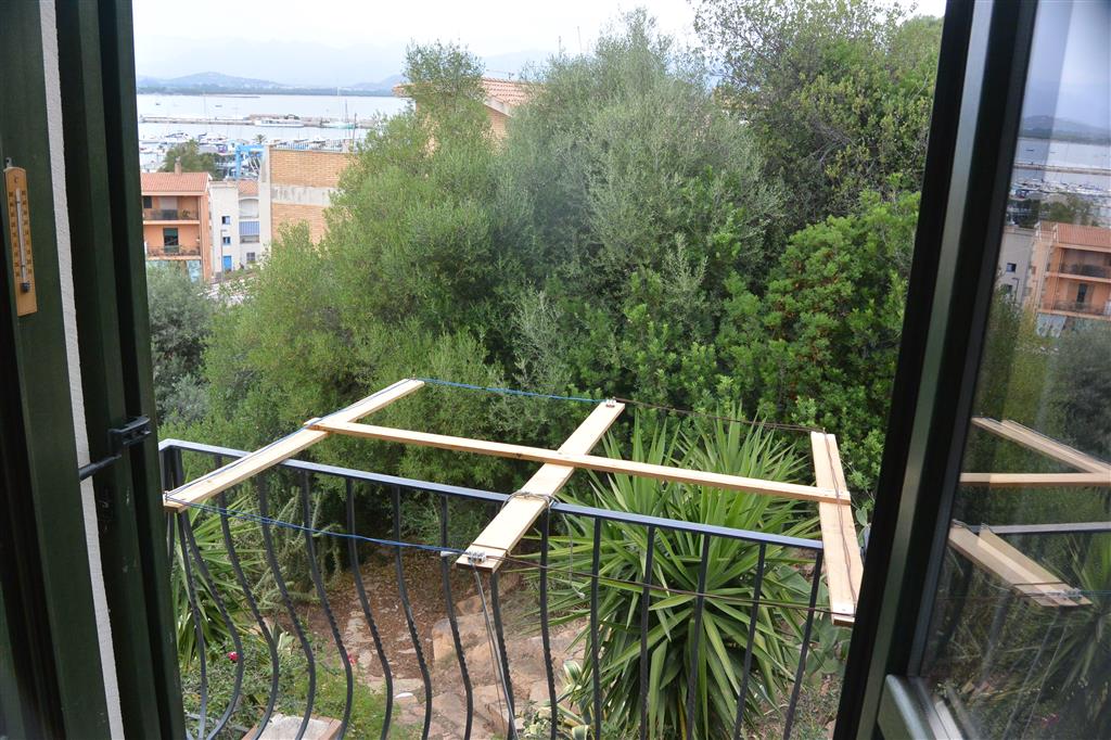

Today I have "optimized" the efficiency of the "space taken" by the antenna (plenty of pallet wood on my hands): I have built a square around the cross, so the side has gone from 88 cm to 129 cm and I shall see the improvement this evening.

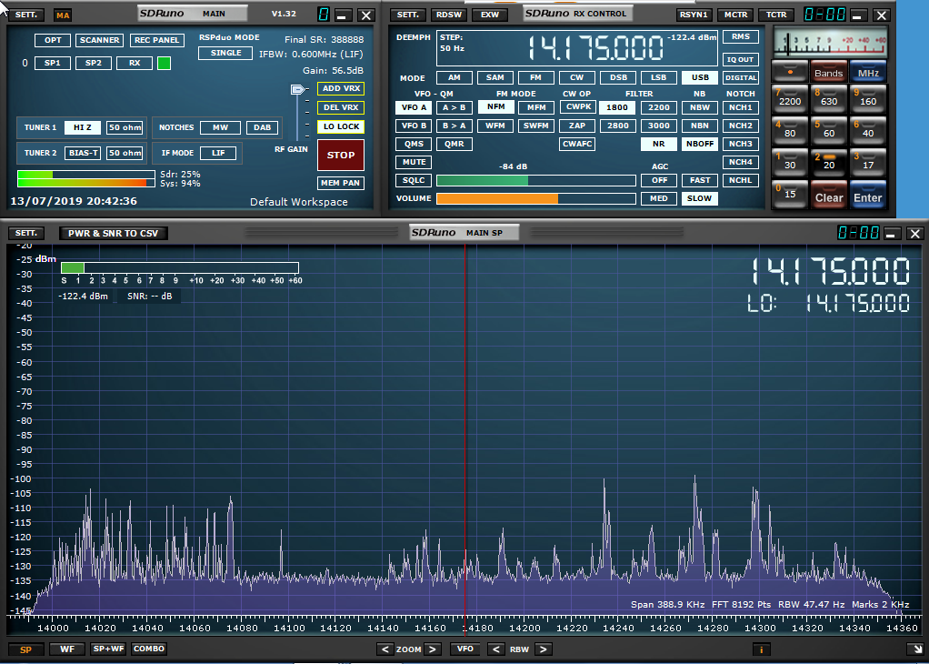

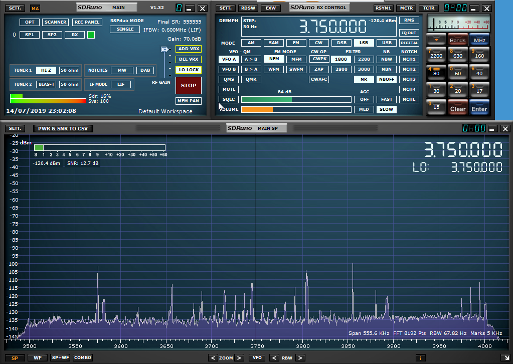

Hi Phil, it is exactly that. You pushed me and I am now going full blast.
Yesterday I increased the side of the square from 88 cm to 1.29 cm. The practical footprint space actually taken by the antenna is the same, but the capture surface has more than doubled, from 0.77 sq. metres to 1.66 sq. metres. Using the original "small" antenna in the last few days, it was evident that performance became better and better going up from 3.65 MHz to 14.3 MHz.
Now, with increased dimensions, performance improved slightly at 14.3 MHz, but had a very significant improvement at 3.65 MHz, as proven by the screen enclosed below. No toroids yet, but I keep looking forward to them.
Rather than hula hops, I am thinking of an all stainless steel (or copper) square made with tube shafts tapped at the ends and screwed into machined corner ends. This would be the perfect portable antenna: you carry it in a golf bag and you deploy it anywhere, or you keep it at home and assemble it when needed. I think we are making quite a progress with respect to whips (!) or amplified printed circuit boards. If the new wideband matching works as well, then we shall have a bomb. Please advise me on possible flaws in this scheme.
Of coure we are covered down to 3.65 MHz only, and at the limit there, but lower than that we come into the domain of "large" ferrite antennas and this is a new world to explore. Luckily a fantastic amount of information is available here, even though large ferrite sticks are quite expensive.

- Not bad for a small loop antenna!
- 13.7. Loop 14 MHz 2.png (314.13 KiB) Viewed 100727 times
- Very big improvement at 3.65 MHz!
- 14.7. 3.65 MHz improved.png (316.09 KiB) Viewed 100731 times
