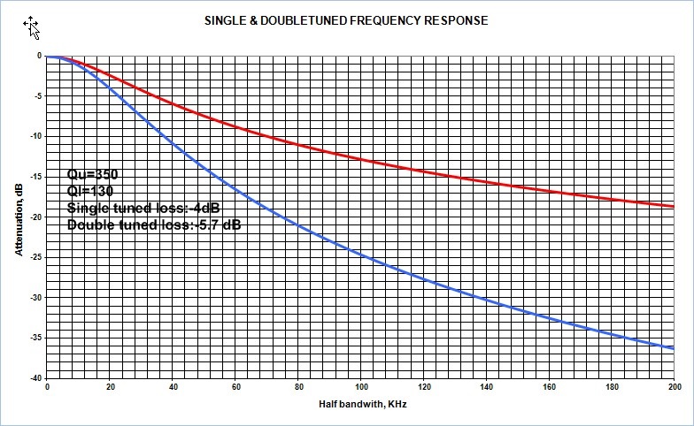

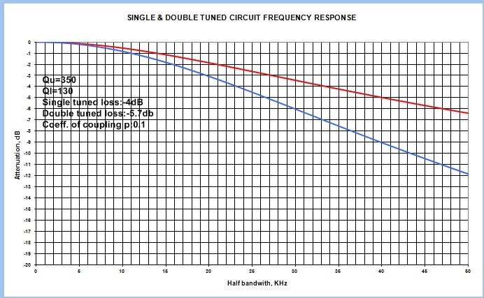

If we look at your picture (Maximum coupling.png) on the previous page, the power meter reading (ie. the dBm number on the SDRuno waterfall just below the signal strength meter) shows the noise power for your tests conducted with an 1800Hz bandwidth.
My concern is that the figure on the left with the filter does not represent the true noise power calculation because the formula used to derive it assumes incorrectly that the spectrum is flat, as it is in the right hand picture. I wonder what the difference is but I can't read the numbers ... is it the case that is the real difference in value between the two SNRs, ie. is that value a true measure of the effectiveness of the preselector?

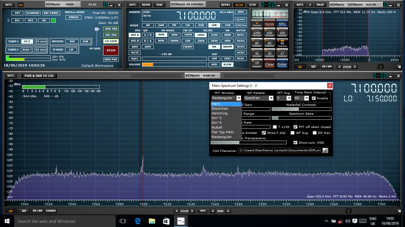

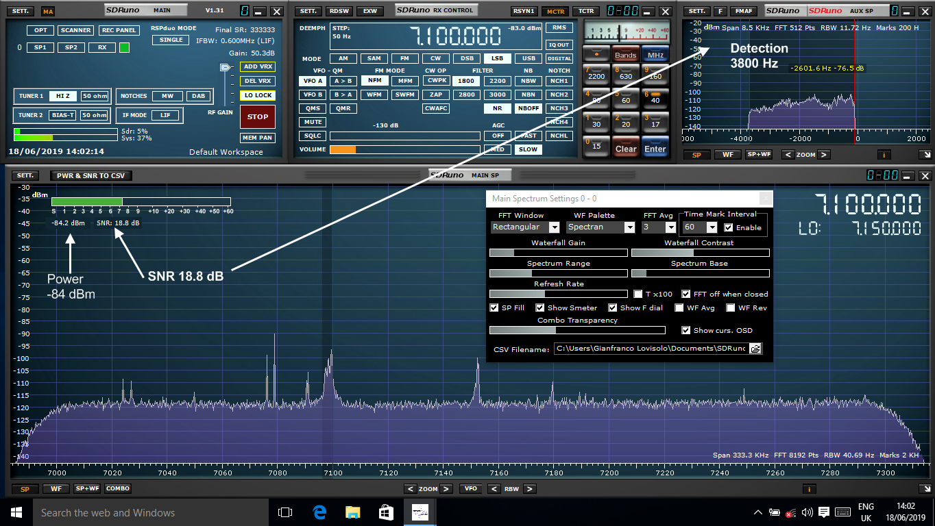

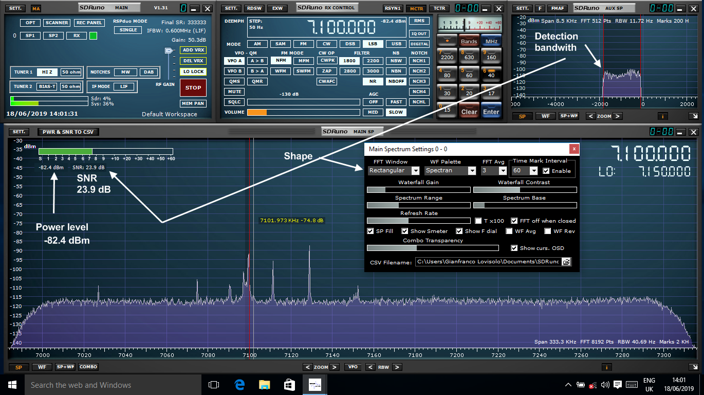

Phil, here below answers to your questions.

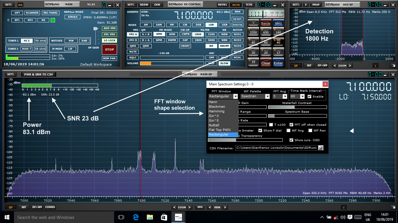

SDRplay accurately measures input power in dBm independent of detection bandwith. Any zero bandwith carrier within the receiver passband, by definition, will cause a reading equal to the received level in dBm referred to 50 Ohm.
SNR reading depends most on detection bandwith and very, very little on shape (you can check for yourself). Herewith enclosed pics of the same signal with nearly identical level in dBm, but with a different S/N readng because detection bandwith has been set differently. In SAMPLE 83 you can see the window shape selection menu. SAMPLE 83 and SAMPLE 84 show the different SNRs due to different detection windows.
With our external pre-selector, even with an impossible Qu=1000 and a Ql=400 we would be unable to influence the SNR.

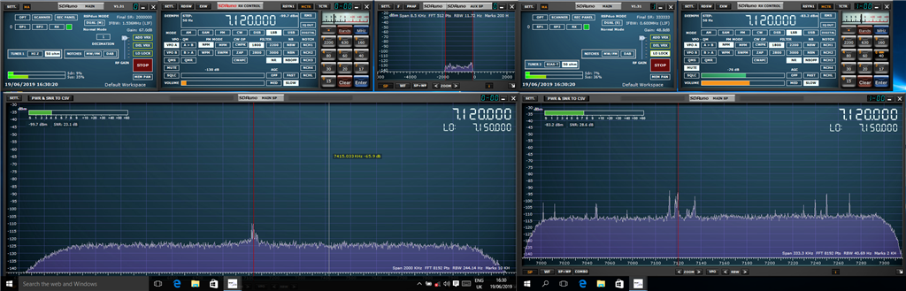

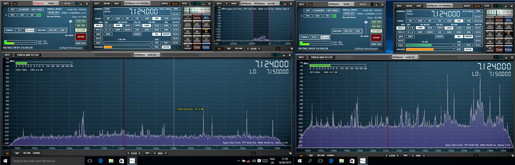

Another example here. Have now made 25 mm dia. coils with Qu=500. More tomorrow.
Have a nice dancing evening,
Gianfranco

I tested various tricks for building high Q coils and can now consistently build inductors with Qu=500 @ 7 MHz. It is my intention to start a separate thread on bandpass pre-selection filters (where these practices will be described) just to have an orderly and organised writeup after this very interesting, but not organized thread.

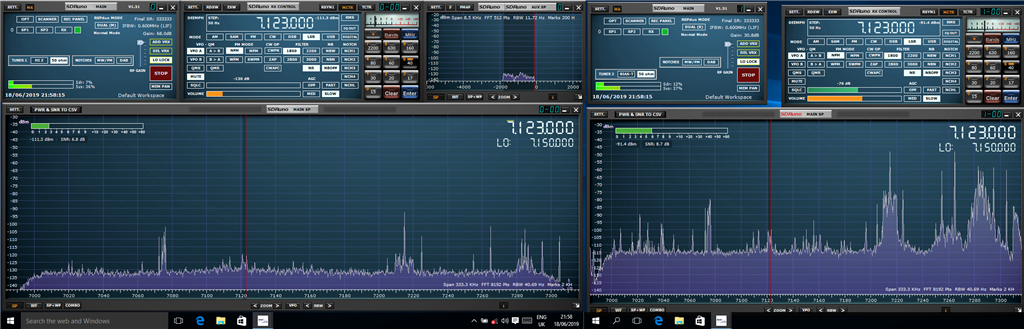

To come back to our original work, uploaded below are the practical test results with the finally completed double tuned narrow band pre-selector, with a Qu=500 and Ql=200. This unit has a razor like bandpass at +/- 20 KHz and starts cutting significantly at +/-60 KHz already. If a signal is not within the bandpass, you do not even see it. The broadcasters above 7200 KHz are gone. I am posting two pics taken at night and one taken today with a QSO just inside the bandpass. The insertion loss for this narrow bandpass is of course high, in the order of 12 dB, but this seems not to worry you. The nighttime screens show the quiet output of Tuner #1. The daytime one shows the QSO in progress thru the pre-selector.
Yesterday evening I noticed a very strange and unexpected phenomenon: there was heavy QRN due to far away stormy weather and Tuner #2 showed it all right, both in pops in the audio and display base jumping up and down. Tuner #1, receiving tru the pre-selector, exhibited simply white noise, with no pops. I am sorry, but I cannot explain why this is happening and hope someone reading this will be able to explain. Eliminating QRN with front end selectivity? I did not drink beer, I promise...

- Narrowband preselect. night 1.png (489.13 KiB) Viewed 40012 times
- Narrowband preselect. night 2.png (490.05 KiB) Viewed 40012 times
- Narrowband preselect. day 3.png (467.13 KiB) Viewed 40012 times
Another important point is that even with the new coils (20 uH with 36 turns) is is still impossible to use 50 Ohm links for coupling, so I resorted to existing binocular core transformers and therefore insertion loss is over the calculated 12 dB and is around 16 db, but this problem will be eliminated with ad hoc designed & built transformers. In any case my idea is that keeping the selective circuit at 800 Ohm and then use transformers is the way to go. Pse also note that in Tuner # 1 I did not use the HI Z input, but the 50 Ohm input (thanks to the binocular transformers) in order to have a completely balanced comparison with Tuner #2.

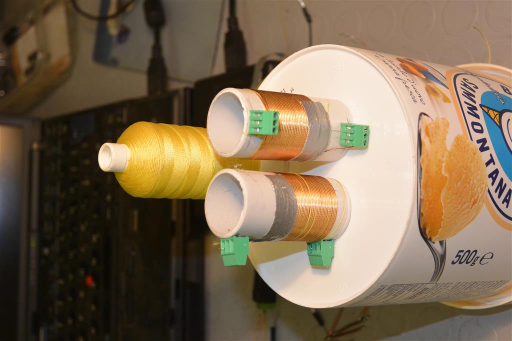

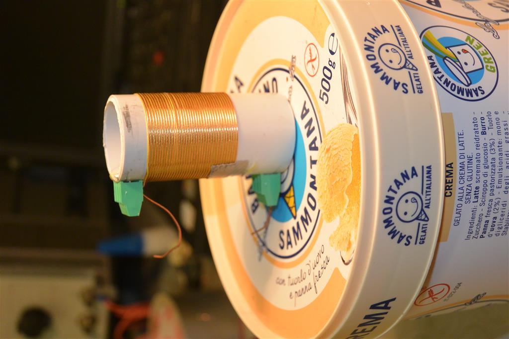

I am uploading a pic of the completed hig Q varicouple pre-selector, along with the two High Q coils. The breakthru is to space the turns , but this is not easy. In the first attempt I wound two parallel wires together, then shellacked the winding, cooked the shellack and, when dry, removed one winding leaving the other coil spaced. But my shellack was disappointingly lossy and Qu went out of the window. Next try, I stole thin sewing twine from the wife and wound the coils with twine along with the copper and, finally, I was able to measure Qu>500! When you space, inductance goes down for the same number of turns and this is an advantage for the coupling links. By the way the roast twine is not suitable because its diameter is too large.
I was forgetting a very important point! You MUST wind both coils and links in the same direction. In this way, when you set up the pre-selector, you will be certain of unopposed or opposed coupling flux and use one of the two modes, increasing far selectivity one side or the other.
So it is up to you now, build this contraption and show us real performance with WSPR!!!

- The two High Q coils.
- DSC_1576.JPG (95.99 KiB) Viewed 40006 times
- This is the High Q coil with stolen sewing twine.
- DSC_1575.JPG (107.21 KiB) Viewed 40006 times

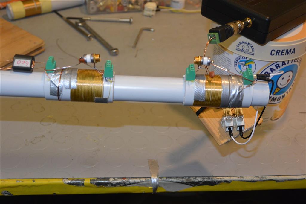

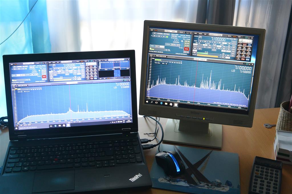

- The completed narrow band pre-selector
- DSC_1577.JPG (94.62 KiB) Viewed 40006 times

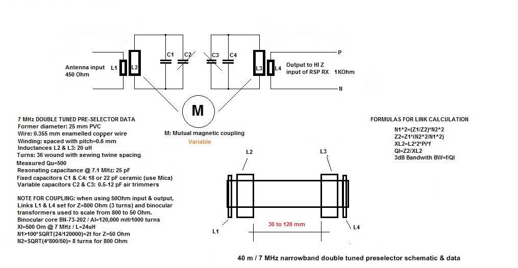

Uploaded below narrow band pre-selector schematic & data.

- The receiver & the panadaptor.JPG (126.35 KiB) Viewed 39935 times
