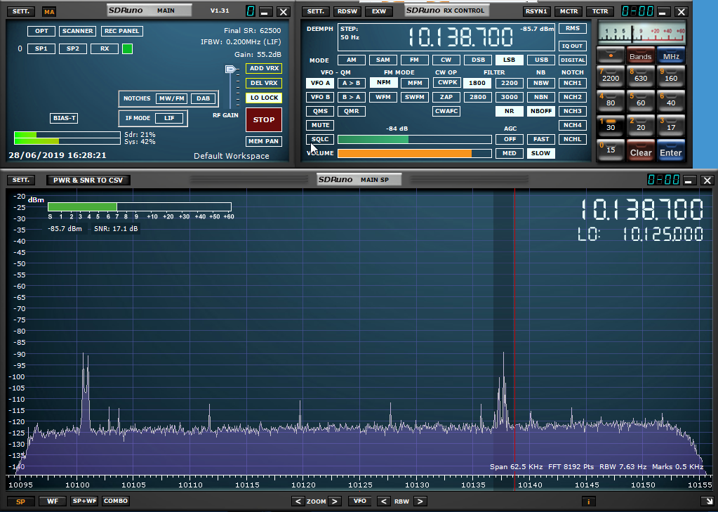

Phil, is this below the WSPR signal on 10,138.700 ? It has a kind of wobbly modulation.

- Looks too strong to me.....
- ScreenHunter 10.png (317.82 KiB) Viewed 78292 times

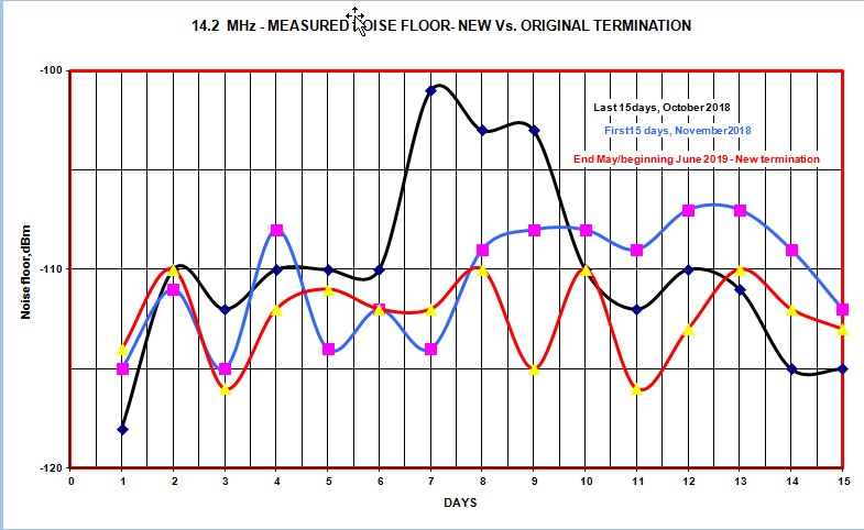

Hi Phil,
The dilemma about selectivity Vs. insertion loss is not really a dilemma, if you carefully consider the data at your disposal.
1) The minimum detectable signal (MDS) of the RSP2 @ 10 MHz (given its rated Noise Figure) can be safely set at -120 dBm.
2) You now have to give a figure to your antenna noise level. Using my antenna data (yes, at at 14 MHz, but this is an example) shown below, the MINIMUM AVERAGE noise level you can hope for would be -112 dBm, if you used my antenna. But it is easy for you to measure yours.
3) You also have to consider a noise margin on S/N. Since you are receiving digital signals, I would set this @ -1 dB (-3 dB for SSB).
4) Thus your absolute sensitivity is -119 dBm and you can safely attenuate (signal & noise go down by the same amount) down to the level of - 112 dBm. Thus the allowable filter insertion loss is 119-112= 7 dB. E.g. with 7 dB insertion loss you do not lose any sensitivity, because you are just removing that much noise which would not allow to receive that signal anyway.
All the above holds with no strong adjacent interfering signals: but do you really have them so near? This is the entire point. If the strong overloading signals are far enough in frequency, then you can resort to a fixed frequency bandpass and forget about really high Qu components (always hammering on the same nail this Gianfranco!!)

- Data taken in june 2019 on my Beverage
- Noise floor compare 14.2 MHz.jpg (81.25 KiB) Viewed 78274 times
