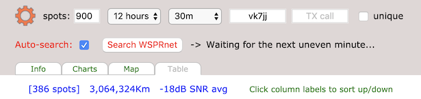

If anyone wants to follow the current radio shootout, open http://wspr.vk7jj.com/ in two web browser windows simultaneously and configure them as illustrated below.
The FT-991 is VK7JJ and the FT-857D is VK7JJ2
The auto-search needs to be on (on both) to ensure they both get the same bunch of spots as new spots are uploaded every even two minutes. Make sure the VK7JJ band is set to 30m because 40m antenna testing is ongoing.

The winner of the WSPR 30m first round shootout is the FT-857D
Both radios achieved 88 total unique callsigns heard over a 24 hour UTC period.
The win was thus decided on the basis of extra spots from the same stations being received by the 857 that the 991 missed rather than new stations being heard. Those extra spots were all close to my SNR floor which is around -32dB.
The numbers:
The FT-991 achieved a total of 699 spots in the last 12 hours.
The cumulative distance for those spots was 8,196,755 kilometres.
The FT-857 achieved a total of 762 spots in the last 12 hours.
The cumulative distance for those spots was 9,190,539 kilometres.

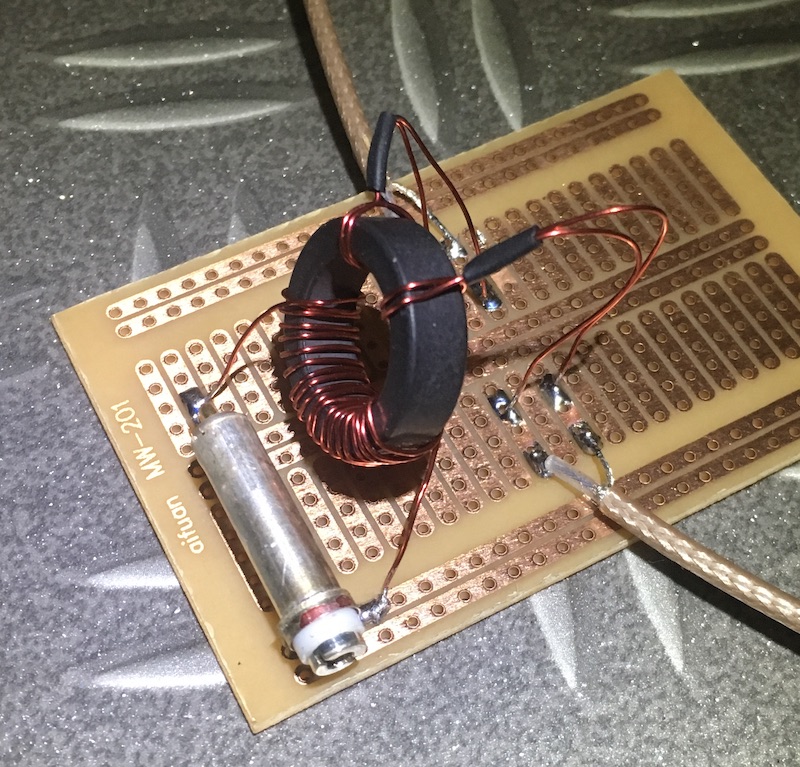

Update:
12 hours of RSP1A versus TS-120S revealed the TS120S as clear winner with typically 10 to 15 percent more spots.
Rather than let that experiment run for a full 24 hours I put a new and better toroid preselector inline with the RSP1A.
Over the last hour that has more than reversed the spot count in favour of the RSP1A
eg. 83 spots on the RSP1A with the preselector versus 54 for the TS-120.
Be interesting to see how it goes over 12 hours.
On WSPR, the RSP1A is VK7JJ3 and the TS-120 is VK7JJ
Any search must be for 40m only.
Phil
PS: Here's the preselector, the tubular device is a ceramic screw adjustable capacitor trimmer.
And it's vinyl underneath, not checker plate aluminium.

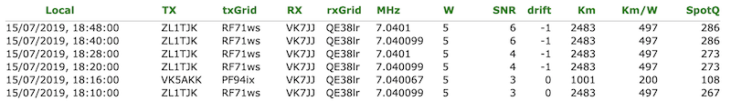

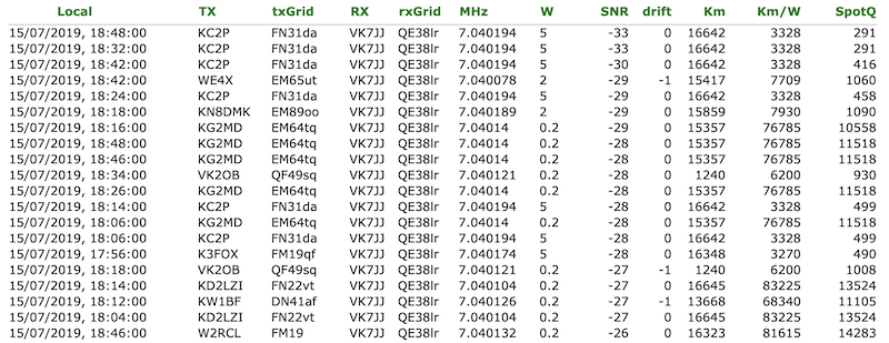

OK, I have finished comparing an RSP1A with a good conventional receiver on WSPR 40 meters, a Kenwood TS-120s with GPS-DO VFO.
Despite all my spreadsheets of results it boils down to just a few things:
a) a few dB of SNR makes a very large difference to hearing very low level signals.
It's worth remembering I'm trying to decode digital transmissions that are as low powered as 10 milliwatts as far as -33dB below the noise at a distance of something between 10,000 and of 17,000 kilometres and every transmission must be heard for a full two minutes in order to be successfully decoded. Thus AGC pumping from strong adjacent stations in particular, plus fading and interference can very easily cause a problem in that two minute period.
b) the most recent hour of reception is typical of the differences between the two.
Exhibit 1 shows the SNR comparison of the SNRs of the lowest 20 spots. VK7JJ is the Kenwood and VK7JJ3 is the RSP1A Exhibit 2 shows the SNR comparison of the highest 6 posts. See next post for the rest of Exhibit 2 (each post can only contain 3 images)
