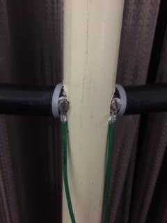

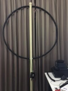

Had a go this weekend making a single loop. I have not received the amplifier kit yet, but hooked it to the SDRPlay briefly and can certainly see some the sensitivity change when I rotate it by hand. Lower noise level is giving better digital mode decoding and HF fax reception.
Two questions: I would like to measure the inductance of the loop - i understand this is a critical dimension. I have a meter that measures inductance, but when I put the probes across the loop is drops down to zero on any setting. How can i measure this properly (am a novice)..
I found the Al in the Pe-Al-Pe pipe very thin and soft and think the quality of the connections may not be very good (its difficult to remove the Pe layers without damaging the Al). I am thinking about having some copper tube/piping shaped to a perfect circle - would be easier to connect and may give better results? Challenge is that the 'thin' copper tubing doesn't come in 1" around here. So my options would be heavier 1" copper pipe, or lighter 1/2" copper tubing (roll). Thoughts?

I also have a loop made from PE/Alu hot water pipes. I use stainless steel nuts, bolts and washers for the electrical connections and have additionally sealed the connections with silicone. Full copper material has no advantages. It brings more weight and the DC resistance of the material itself is not so important.

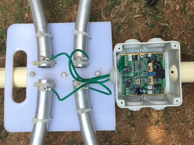

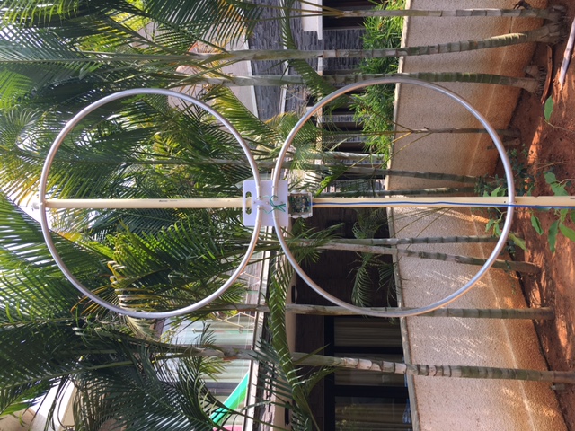

I received the LZ1AQ amplifier kit and I decided to update from the PE-Al-PE material to plain 1inch Al tubing (1.5mm wall size). I am running two 1m loops in the same plane, but results in the 40m band where I do most of my listening are not as good as my randomly cut center fed dipole.
For power I am using an old style transformer 12V AC-DC power adapter supply (not switch mode) and voltages are within limits specified by the kit. I am using a 20m shielded and foiled Cat5e FTP cable between the control board and the amp, with the shield disconnected at amplifier end. Leads to both loops are the same length at 200mm as specified.

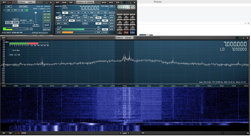

Results for loop A, loop B and crossed loops are almost identical. Dipole mode (using the loops as dipole arms) is worse. Right now I am getting a strong SW station on the LO frequency at 7Mhz which shouldnt be there. I've been playing with Gain/gain reduction, the external front end gain setting and Zero IF/Low IF without much success, but I'm very much a beginner so I'm shooting in the dark. Seems like only very strong signals are coming through.
Attached are some pics of both the build and what I see in SDRUno. Any suggestions appreciated!

Nice circle shaped loops! How did you bend the material? I never get mine perfectly round shaped.
I think you should place the antenna higher above ground to get better results with the dipole.
The crossed loops should deliver appr. 2.5 dB more SNR for frequencies above appr. 14 MHz. For frequencies below the atmospheric noise is higher than the total noise figure of the whole construction. If you have very high local noise (friendly neighbours with all sorts of modern electronics in their houses) I think you cannot benefit from the crossed loops so much.
The ghost signal seems to be an overload effect in the SdrPlay. The loop amplifiers deliver high signal levels. But you only could rule out this when another receiver shows the same problem.

I cheated and had them rolled at place nearby with a hydraulic pipe bender
I now have it mounted up on the 2nd story roof and results are the same - seems to be overloading the SDRPlay everywhere.

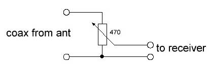

Would a simple external attenuator help if this is the case? Where would I insert it? If it needs to go before he antenna amplifier it will be tricky as there are 4 leads from the loops, not just coax. Can I put it after the amplifier before the SDRPlay?

When overload is the cause a simple attenuator right at the receiver input should of course help. I often use a simple 470 Ohm pot for test purposes. This is not state of the art RF technology, but it works better than one might think.rack201 wrote:Would a simple external attenuator help if this is the case?
(Of course I have calibrated switchable 50 Ohm attenuators, too. But for reception without necessity of calibrated measuring the pot "solution" is absolutely OK.)
